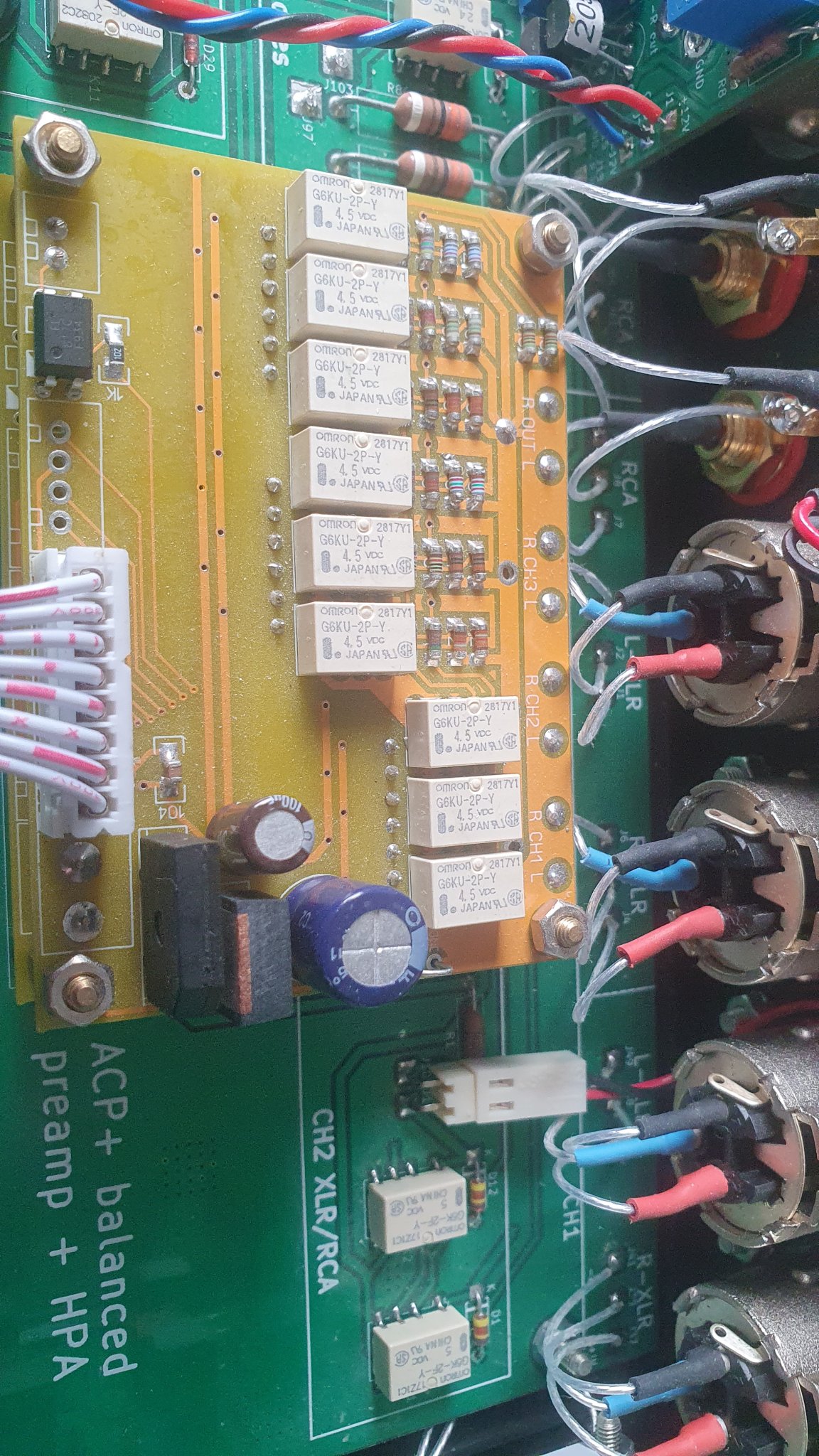

MBB, just chill
only way to marry possible differences of voltage potential
in my Iron Pumpkin SE, relays selector, I'm switching both hots and GNDs of inputs, but inevitably in MBB fashion, be it made with Lorlin rotary MBB switch or with logic module (where MBB made in software)

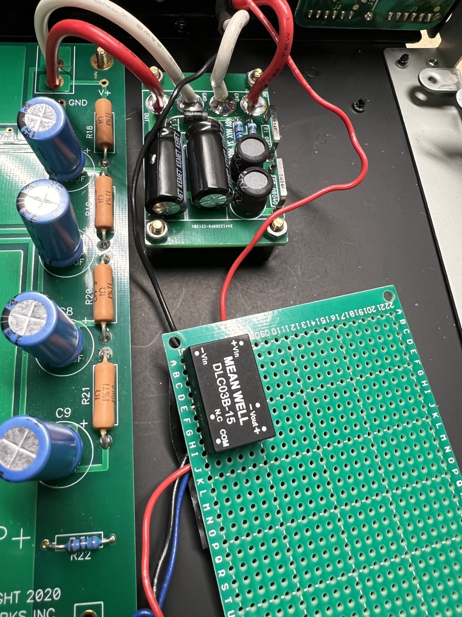

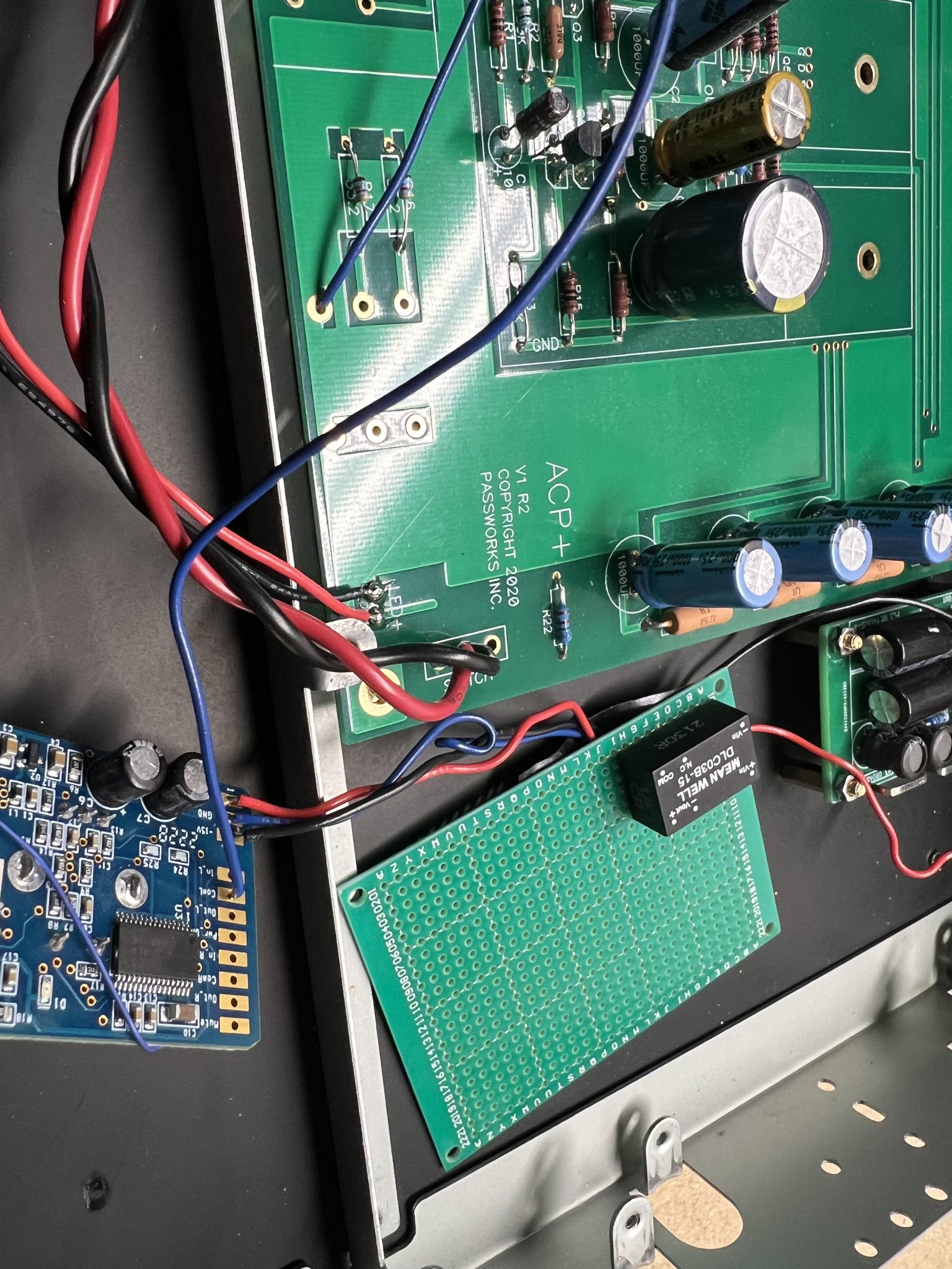

Questions for those that have used the academy audio muses volume controller (or are generally smarter than me and want to assist).
1: I’m looking to use the 15v +- psu Lenny recommended. Wiring it off the smps in, sharing ground from the common on the muses board. Does this make sense or should I run dual grounds, one off the meanwell 15v to ground, and another from muses to ground?
2: the academy board has an on/standby pad. I’m unsure how to connect this, as I already have the acp switched as normal.
If anyone could post a photo of the muses board wired in with labels for where they connected it would help greatly.

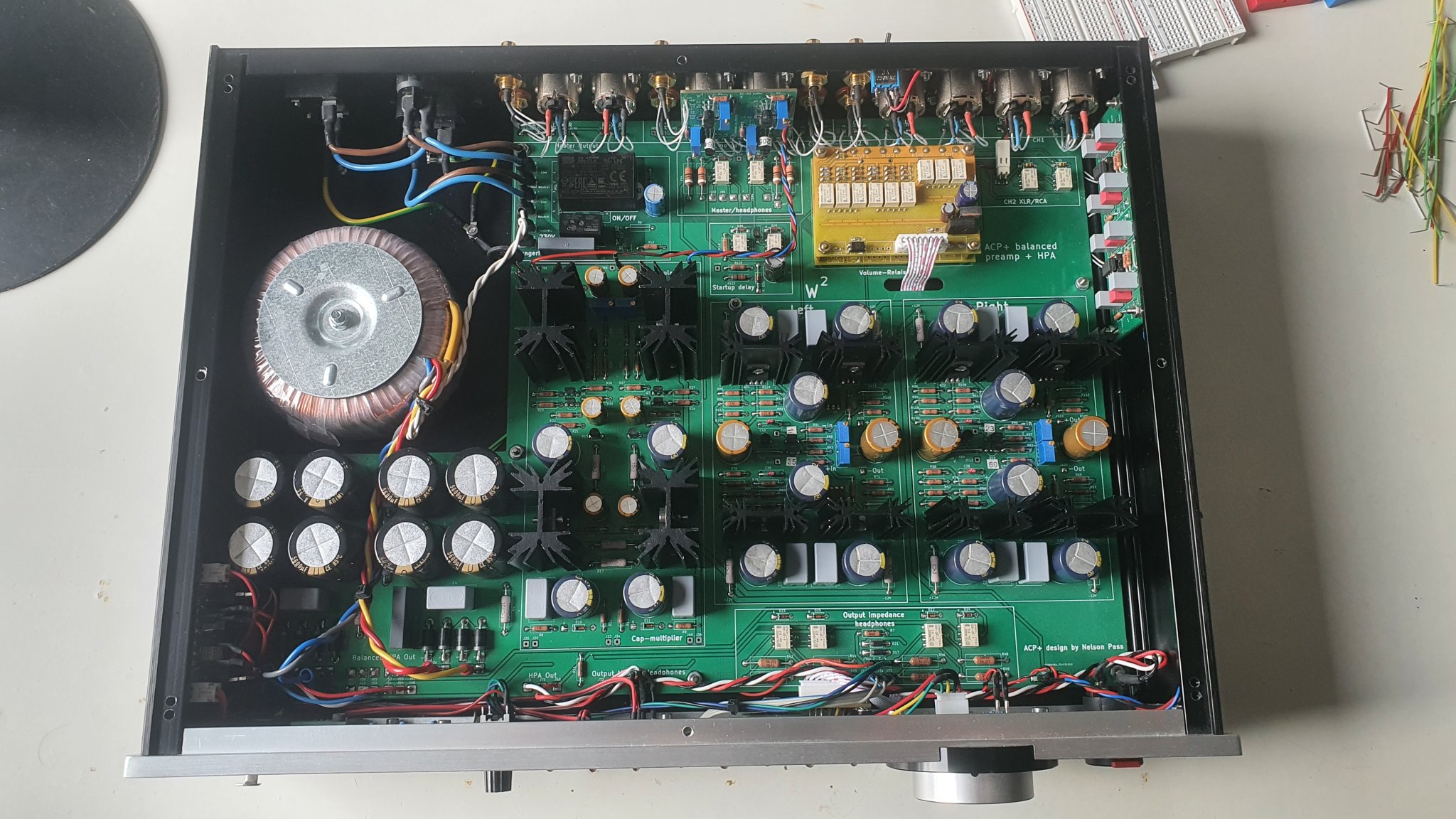

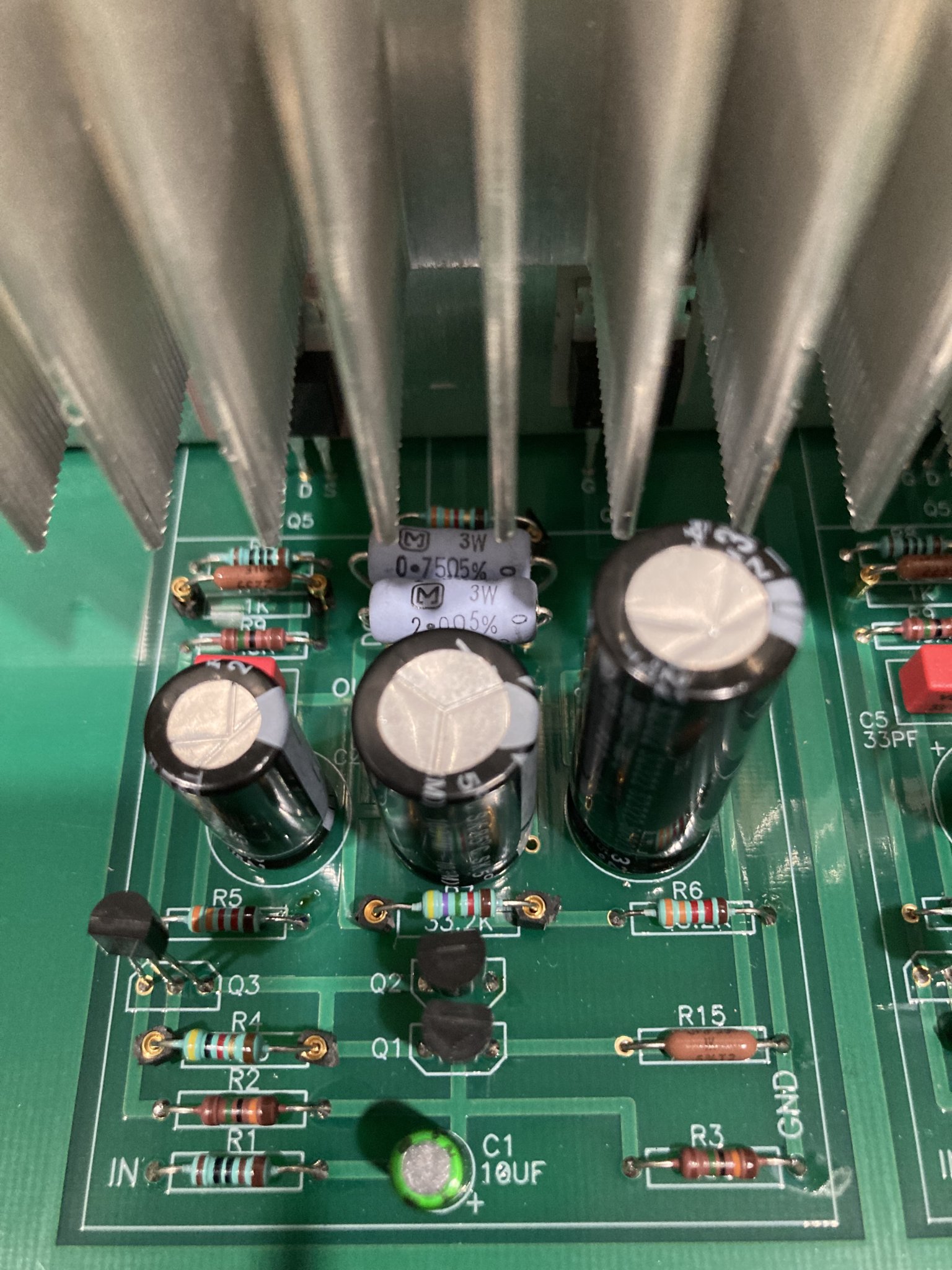

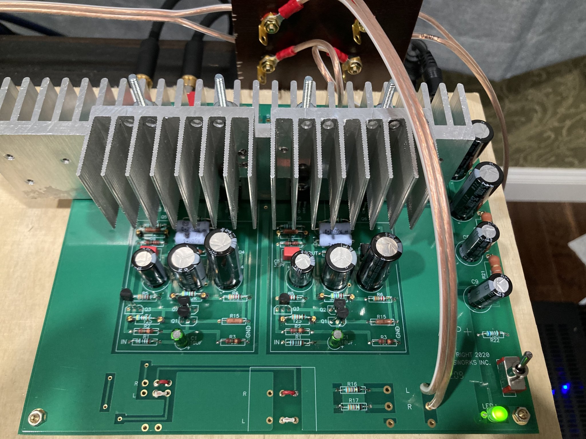

Due to the large indoor temperature changes, I did not use aca mini, but I like its low temperature. I guess acp+ is what I want.Q5Q6-IRF520 R12-0R75 R13-2R R11-40R R7-47kR C3-2000uf R18-20 0R33
Q5-332mA
The sound sounds good
Thank you Nelson
Q5-332mA
Thank you Nelson
Yiu, you are using it for loudspeakers? Still using the +24Volts? Or something higher?
I see you are using the Toshiba JFET's....nice
