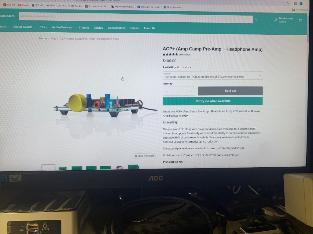

https://diyaudiostore.com/collections/kits/products/acp-amp-camp-pre-amp?variant=40205532397641
Hopefully the price shown is a glitch!! Seems ALL prices have shot up!
I noticed the automatic currency conversion to CAD when I ordered some stuff from the store a couple of weeks ago. Personally I would rather keep everything in the native USD currency but I didn't see how to turn that conversion off.
Same here. Prefer to see it in U$. On phone and tablet it’s still in U$ so maybe some new ‘feature’ in Windoze??
