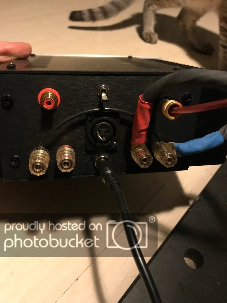

gwils: No need for Y cables, just follow the method in post #6522 in the ACA main thread. https://www.diyaudio.com/forums/pass-labs/215392-amp-camp-amp-aca-653.html#post5595943
Then just use the 'normal' left and right outputs from your receiver.

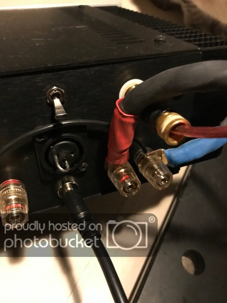

...this one is easiest to do and understand by Mutuano. It is all external and easily reversible too.
Link the two pins in the XLR socket with a suitable loop or wire as shown. That joins the left and right inputs together.
Link the two Black speaker connections with a wire. (The Red ones are already joined internally.)
If you have wired the rear switch from the build guide step 38, make sure it is Down as in the pictures.
That's it.

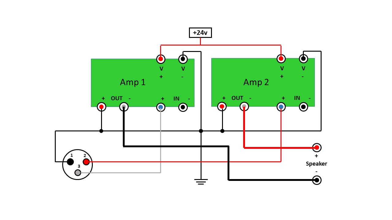

Bridged Mono With XLR Input Only - Questions
I am planning to build ACA bridged mono with XLR input only. My source is DAC which is having balanced outputs and I am planning to run XLR cables between DAC and AmpCamp.
Looking at the ACA v1.6 build guide, I have come up with a simpler connection diagram.
Could anyone please verify whether I am doing it right?
Please note that for both the amp boards, the line input (-ve) terminal is not connected to anything (i.e. open). I am planning to ditch the RCA terminals altogether.
The XLR connector pinout shown in the illustration is the back side of a female XLR connector (i.e. back side inside cabinet)

Saikat,
Correct. Your diagram makes electrical sense given your design parameters, i.e. XLR input ONLY and bridged monoblock ONLY with a design (SE Class solid state) whose phase needs to be reversed on the output as it is cap coupled.
It also follows this diagram:
I have tested the above with an Oppo 205 (differential outputs) and it works fine.

I believe the image was removed from my earlier post. Reposting the image.
Saikat,
সন্ধ্যাটি ভালো কাটুক (transl.= Have a nice evening)
Best,
Anand.
Hi Anand, Thanks a lot for the confirmation.
Saikat

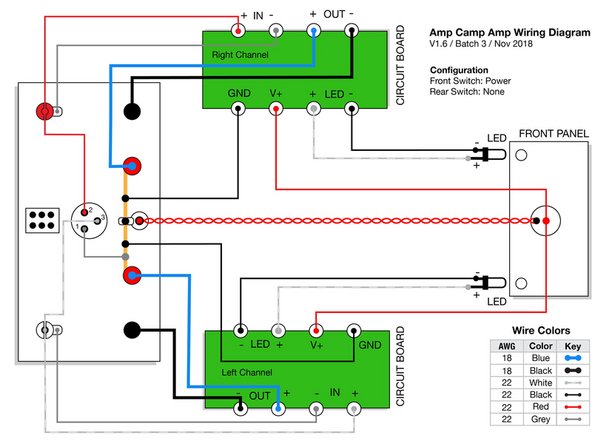

What you have described looks fine to me. Here's the new "Batch 3" wiring diagram for reference.
Hi Jason,
Thanks a lot for the confirmation. I've taken the inspiration from the ACA v1.6 wiring diagram only.
Saikat
