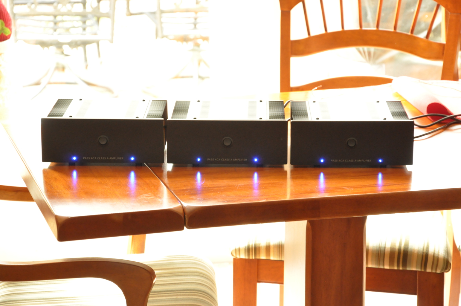

Probably going to sell my 3 brand new ACAs
I just built 3 v1.6 Batch 3 ACAs to power my 3.1 theater system. They each sound amazing on a pair of small bookshelf speakers I have (especially when wired up as mono blocks). However, I was hoping as mono blocks they'd be powerful enough for my custom-built L-C-R home theater speakers but unfortunately not. Since they were custom builds I have no idea what their efficiency rating is (or even rated power... probably north of 200 Watts).
So... I think I am just going to turn around and sell these. Does anyone have any suggestions on what a fair price to sell 3 completed v1.6 (batch 3) ACAs that are brand new (finished one last week, and finished the other two last night and have been burning in that latest 2 for a couple of hours this morning with some Nick Drake and Mark Knopfler)!?
They each cost me roughly $350 + $10 supplies (Cardas solder and heat shrink tubing). The 3 together probably took me ~20 hours to build. So I was thinking $460 each would be a steal for someone and compensate my build time somewhat.
I am in Saint Petersburg, FL if anyone local wants to check them out. I also can upload a bunch of pictures of them if anyone is interested here. I guess if no one is interested I will have a friend throw them up on Ebay (but probably put up a post here too).

IMO almost the whole point of a kit build is the fun of assembling it yourself. So by building the kits you've removed some of the value. I personally wouldn't pay more for an assembled kit than the cost of it's parts and shipping. I'd want a reduction in price if anything. Aim to recover your purchase costs but not your labour.
Better still build some single driver high efficiency speakers and keep the amps.
I agree with Steve luck . Fog Audio I also believe in high-efficiency speaker if you already went through all the trouble of building those amplifier and the trouble should be changed to joy because they absolutely can produce Thunderderious volume of sound out of the proper speaker. If you do decide to build a different amplifier for the speaker if you have already built then First you need to do the research into the speakers you have built before taking a blind shot in the dark at what is actually the proper amplifier for your particular speakers. Sounds like you have some in impedance matching and efficiency matching to do before guessing on which amplifier is best for your individual needs. For example in your situation ( you would not take a camp camp amp and hook it up to a pair of 15 inch sub that only had 80% efficiency and required between 200 and 600 W to drive them.) and then turn around and say there’s something wrong with these amplifiers, they don’t do the job?.I just built 3 v1.6 Batch 3 ACAs to power my 3.1 theater system. They each sound amazing on a pair of small bookshelf speakers I have (especially when wired up as mono blocks). However, I was hoping as mono blocks they'd be powerful enough for my custom-built L-C-R home theater speakers but unfortunately not. Since they were custom builds I have no idea what their efficiency rating is (or even rated power... probably north of 200 Watts).
Well, yeah mea culpa for not knowing the efficiency rating of my custom speakers. Unfortunately, I don't have the measuring equipment to perform that measurement myself and the specifics of them are not available from the boutique brand that sold me the parts as a kit. The builder no longer makes or provides specs on this speaker either.
I am fairly certain they are 8ohm speakers (dual 6" mid-woofers and RAAL 70-10 ribbons) and didn't think they'd be too demanding for a 15 Watt mono block but I guess I was wrong. I love the sound of my speakers, they are absolutely amazing and I also really like the sound of these mono blocks, but unfortunately for me they are not compatible.
Steve Luck, I do agree with you that a lot of the fun is building them. However, I am sure that many out there may not have the expertise or equipment to perform such a build (OTOH, those probably aren't the type of folks lurking on diyaudio, LOL). I ended up buying a new multimeter, third-hand station, Haako soldering station, and other equipment to make this build. I spent over $200 in equipment dedicated for this project which I of course I don't expect to recoup and of course will be really useful for future projects. Anyway, just my opinion, but I would certainly disagree with you that 20 hours of my time diminishes the value of these ACAs.

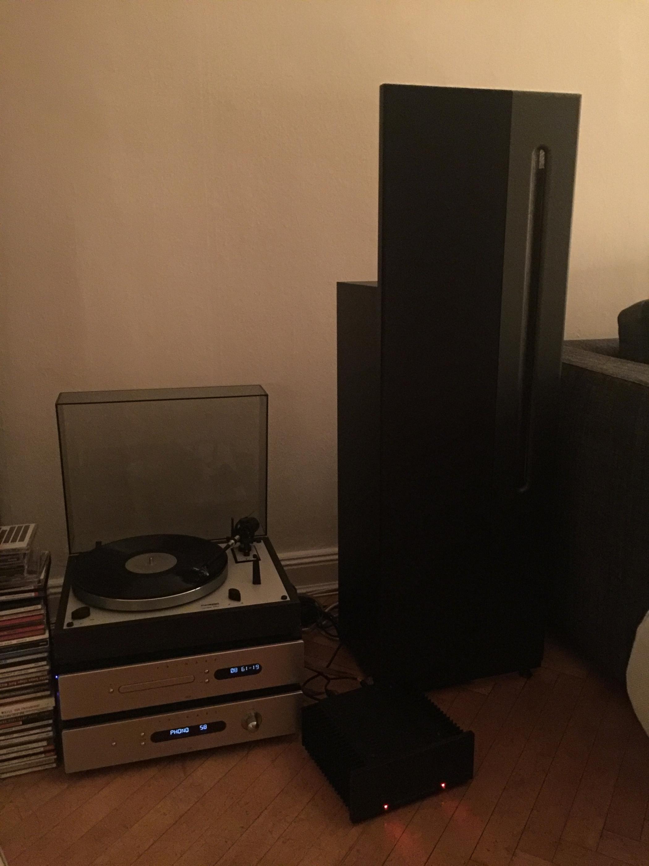

v1.6 can handle Apogee Centaurs
I had to try it: Primare i22 used as pre-amp, ACA v1.6 as power amp and Apogee Centaurs as speakers.
It really sounds beautiful! The Centaurs are hybrid ribbon speakers with a sensitivity of 84dB at 3 meters, impedance is 5 Ohms nominal and 3 Ohms minimum.
