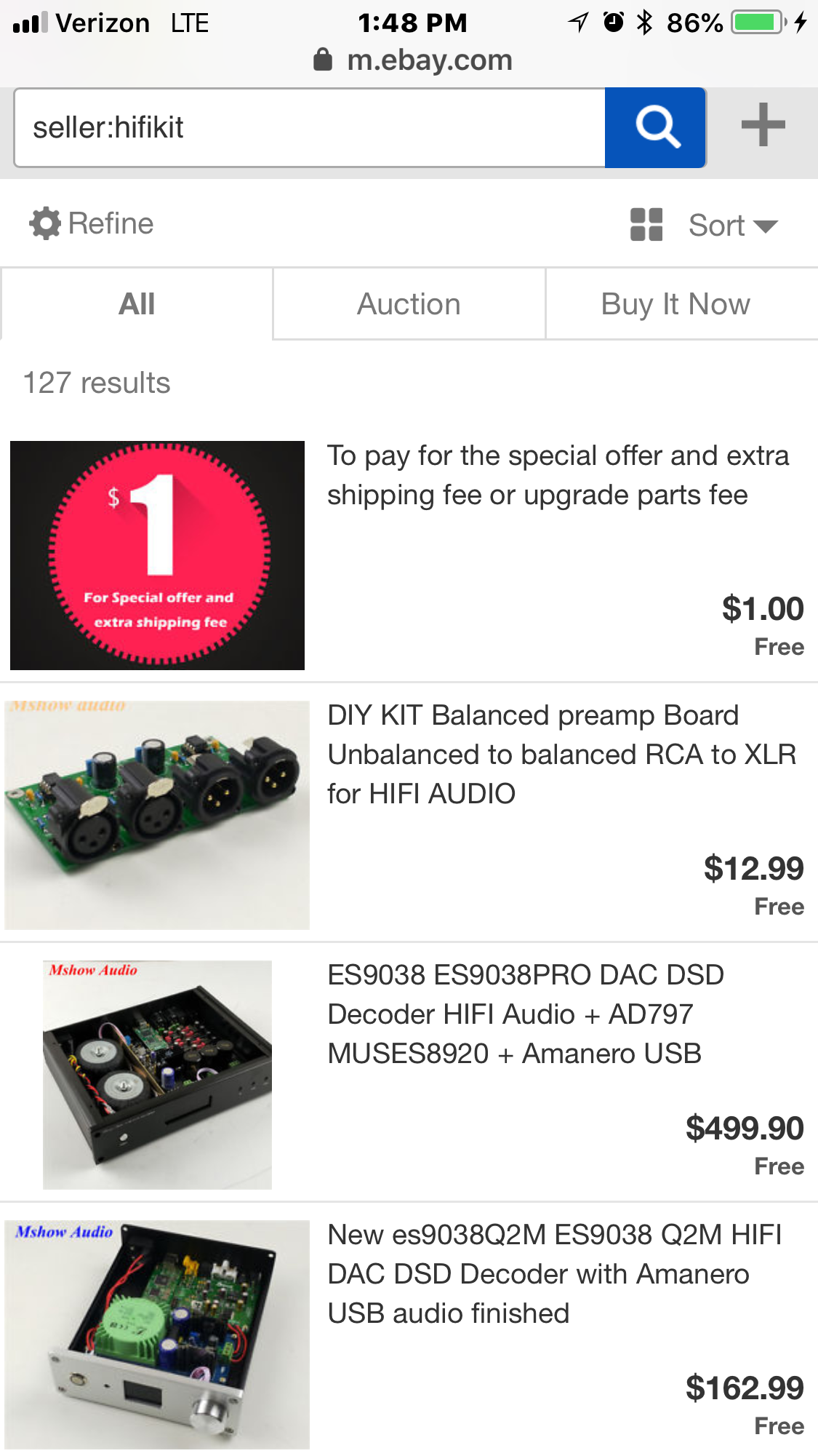

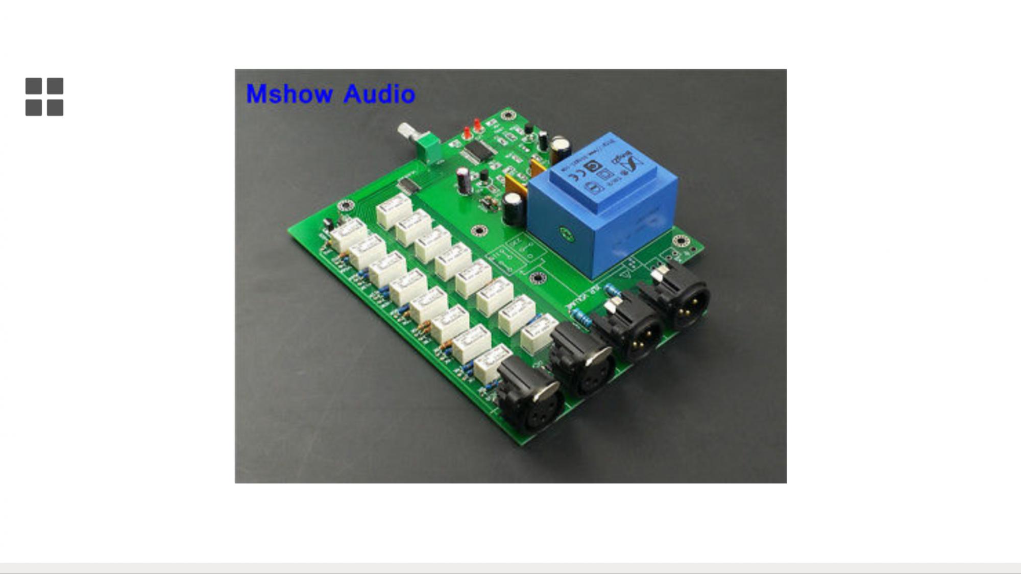

I want to build the balance to BA 1 for my ACA but I don’t have the time right now and I was wondering I found this on eBay would this work it appears to have a volume attenuator to my lack of knowledge of preamps an external volume control therefore I am seeking advice with somebody with a little more experience . It’s available in 10 K impedance or 100K impedance you get a choice when ordering . And because it’s somewhat cheap I could take it apart replaced parts experiment and maybe learn a little something about preamps before I build that be one balanced.

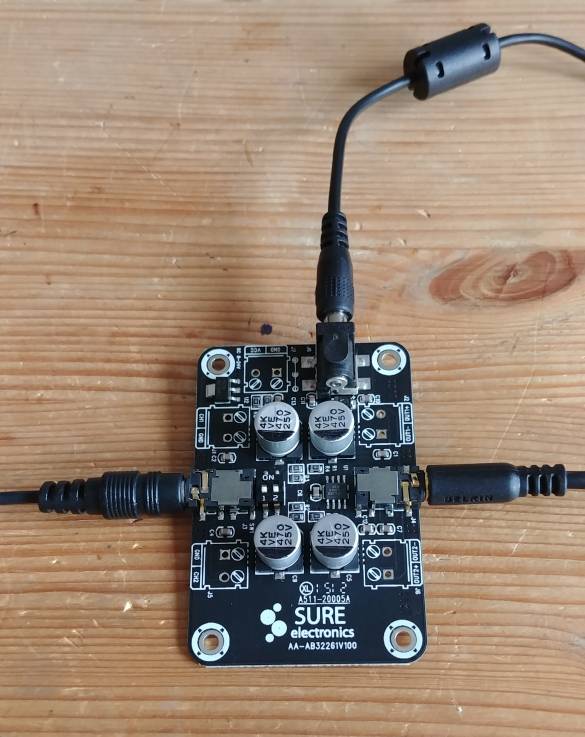

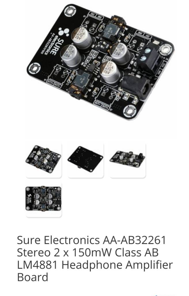

Looking for a pre amp I decided to give this little board a try. It's got enough gain. It's up to 24V DC. And fits easily inside the ACA. Hope it sounds well. View attachment 714251
I am pondering using a Sure TPA3110 board in a similar experiment.
Look forward to hearing your results.

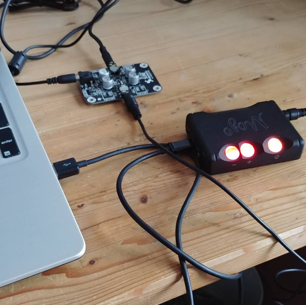

Received the Sure 2 x 150mW. It adds volume but not massively. Between my phone and ACA in low gain setting it's adds about 3 volume steps compared to using my phone buttons. In high gain setting it adds another 3 steps. I had expected more. I was afraid of much more. In my setting it adds enough. Going to built it inside the ACA using the 24V ACA DC.

Received the Sure 2 x 150mW. It adds volume but not massively. Between my phone and ACA in low gain setting it's adds about 3 volume steps compared to using my phone buttons. In high gain setting it adds another 3 steps. I had expected more. I was afraid of much more. In my setting it adds enough. Going to built it inside the ACA using the 24V ACA DC.View attachment 714730
Didn't notice before that the Sure board appears to input from a headphone out.
Headphone output from phones or computers are notorious for poor sound quality and are lower voltage (hence less SP level) than audio standard. What is the output voltage of the Sure board?
My guess is higher than what it is receiving.
Mojo input from USB (potentially better SQ than speaker/earbud out) coupled with a voltage boost may account for the overall improvement you noted.
I'm still trying to get a better grip on this whole voltage/current/power gain relationship to amplifier topology thing.
I need to take some time and spend it on studying that whole gig.
Bottom line is, you found a way to make your front end better.
There's a win.
