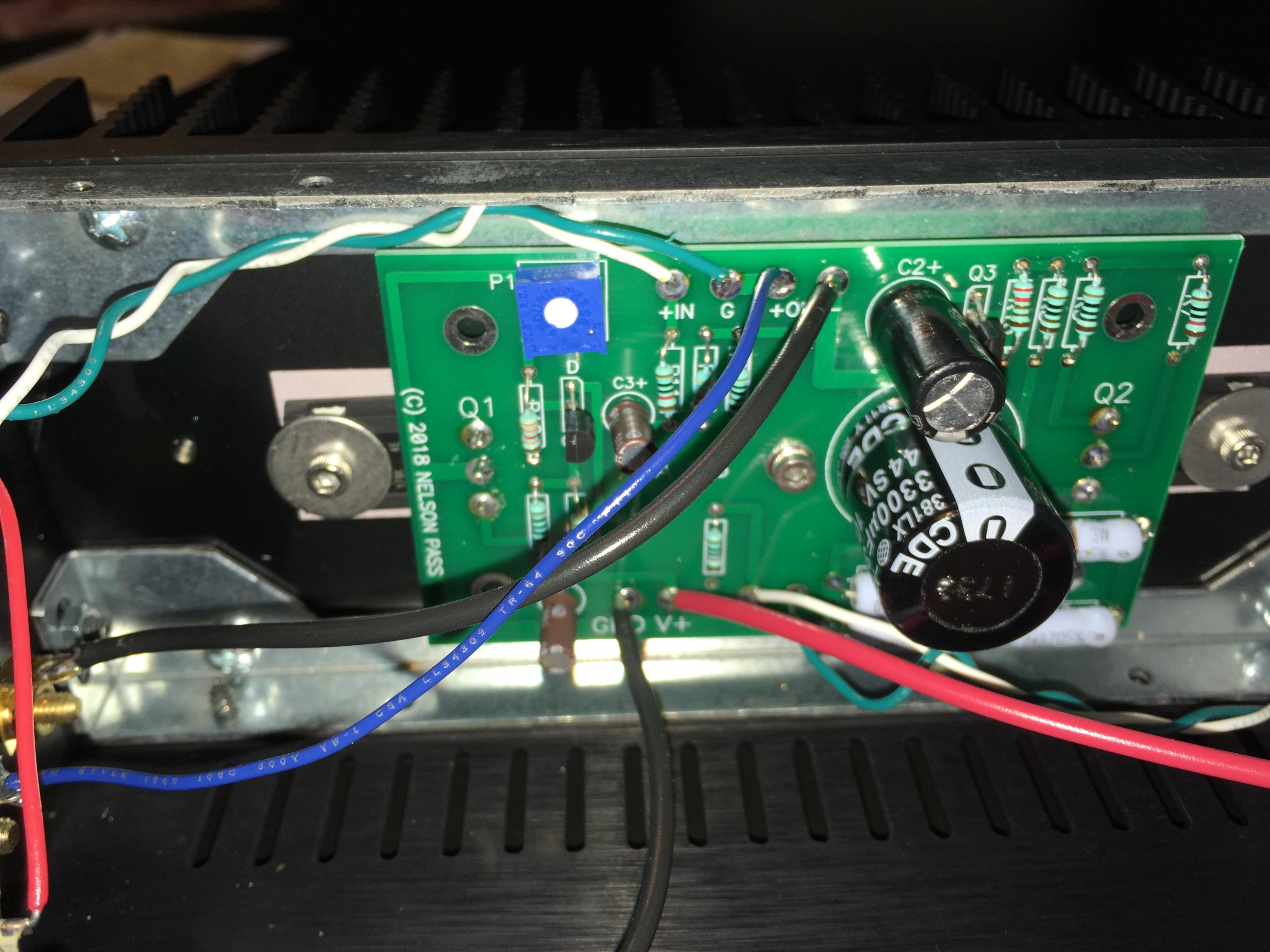

Left channel out after initially OK
I finished my ACA 1.6 a few weeks ago and it sounded great. Now the left channel sound is gone. The LED light is shining, but no sound. Using the voltage checklist recently posted (Thank You!) I find these disparities:
Pot -- Bias at Q1 is 2.33v and is largely unaffected by rotating the pot 'knob' (increases at maximum to 2.7v); This pot initially biased at 12v no problem.
Q1 at D is 22v (should be 12); Q1 at S is 4.36v (should be 0)
Q2 at D is 17.3v (should be 24); Q2 at S is 13.45 (should be 12.9)
R10 on Q4 side is 0.68v (should be 3.5-4.1v)
R15 off Q3b is 13.2 (should be 12.6) and then across the resistor drops to 12.67v (should be 12v)
Other voltage checks are within range.
Many thanks to anyone who can offer some suggestions. I can't see anything obvious as far as solder issues or wiring, but am posting a photo of the problem PCB below.
Jim

Jim, I'd suggest to start with removing pcb and very carefully examine it for cold or missing joints, re-solder any suspects and if nothing obvious found check components values and placement.

Jim, the led is connected through a single resistor to the main voltage and then ground. So having it light up means really only that voltage is going into the PCB, little more.I finished my ACA 1.6 a few weeks ago and it sounded great. Now the left channel sound is gone. The LED light is shining, but no sound...
My troubleshooting skills here are going to be really a starting point, only a few 'baby steps', but could be worth a shot:
- Have you made sure it is not a problem with the source? Have you swapped the right and left RCA inputs. If the sound 'flips' to the other speaker? That would suggest a failure on the source of your music.
- Have you made sure its not a problem with the speakers? Have you swapped the right and left speaker wires? If the same speaker remains playing, then the problem is the speakers and not the amp.
If both those tests remain consistent that you get only sound from the same PCB, try to check:
- if there is no wire o resistor leg that may be protruding too far back on the PCB and touching the heatsink. That could cause some of your behaviors.
- if by chance one of the MOSFETs is not electrically coupled to the heatsink. The thermal screen may have been 'cut' by too much pressure on the MOSFET's screw. This is easiest done by checking if there is continuity between the MOSFET's middle pins and the heatsink when the PSU is disconnected. If there is continuity, then there may be a short to the heatsink.
Other than that, I am of little help, but others will surely come to the rescue with more ideas to try.

Jim,
First thing is as Rafa says then check for poor solder joints, look at the white wire at the RCA connector for example, it looks poor from the picture.
Second can you re check all the readings? There are some discrepancies in the results you posted.
I:'Bias' is measured at Q1-D - you have 2 results ''2.33v and 22v''.
II: R15 'bottom' is joined to Q1-D by the PWB track so should read the same, but you have 12.67v? (Does that alter if you turn the 'bias' pot? If so set it to 12 volts.)
Other odd readings are Q1-S and Q2-D. These are the negative and positive supplies directly to the boards, so should read 0v and 24v unless you have poor connections in the wiring.
Out of interest, where did you put your Negative meter lead for the measurements?
So best to re do the checks and also compare both boards results. If you did not before, use the bare copper buss as your negative meter lead location. Let us know what you get please.

After removing the problem PCB, resoldered some funky looking connections. Now all seems well. Thanks for the help.

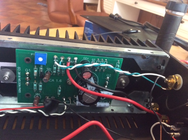

Right channel not working anymore
I've completed my 1st ACA about 2 weeks ago and it worked fine. I pulled it out today to try the unbalanced bridged mono setup (I have a second ACA that works fine) and no sound came out. I configured back to stereo and now the right channel is dead (the left channel is working). I measured voltages and everything is according to spec. I've also compared the internal wiring against the other ACA and could not find any difference. Any ideas where to look or what to check / measure?

zimmer64 If your voltages are correct and match the working side, then check your input and output connections next.
See on the other thread #5958
If the reading is Much higher or open circuit on either, you have a poor connection.
Alan

I have 0.99k ohms between the speaker posts and 50k ohms on the RCA's on both side. So that seems to be ok. Where to go next?

... I have 0.99k ohms between the speaker posts and 50k ohms on the RCA's on both side. So that seems to be ok. Where to go next?
Difficult to say. If the voltages are OK and the input and outputs are OK, it should be working. The picture is difficult to see, but I hoped R11 was not soldered in correctly - next to C3 under the blue wire.
I assume you have tried swapping the input source and speakers left to right? It would not be the first time a faulty input or speaker lead was to blame.
That said, re-check the voltages, using the working side as reference, note any differences.
Then it will be remove the faulty board and check for dry or missed solder joints, wire strands etc.

Thank you Alan. Yes, I have swapped all input and output cables. As it worked fine for a week or so, I guess there is a wonky solder joint somewhere. What strikes me though is, that voltages look fine on both channels, which feel not logical to me. I guess I will put the board and re-flow all joints just to sure.
zimmer64 Michael,
If you are feeling brave...
you might try a power on test with a speaker connected and an input of some sort playing just to the faulty channel. With a wooden coffer stirrer or BIC biro tube, nothing metal, gently prod / tap each component and solder joint in turn. It just might locate a poor connection. Sure to be something simple (I hope).
