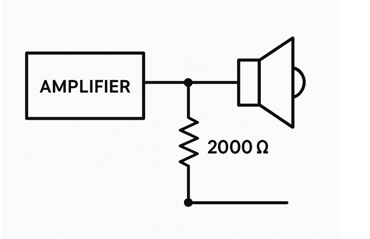

In the amplifier operating mode in this picture, If you put a 2k resistor in parallel with each side of the output, the amp is blissfully unaware that anything is connected to it.
It would look like this - one for each side of the speaker output.

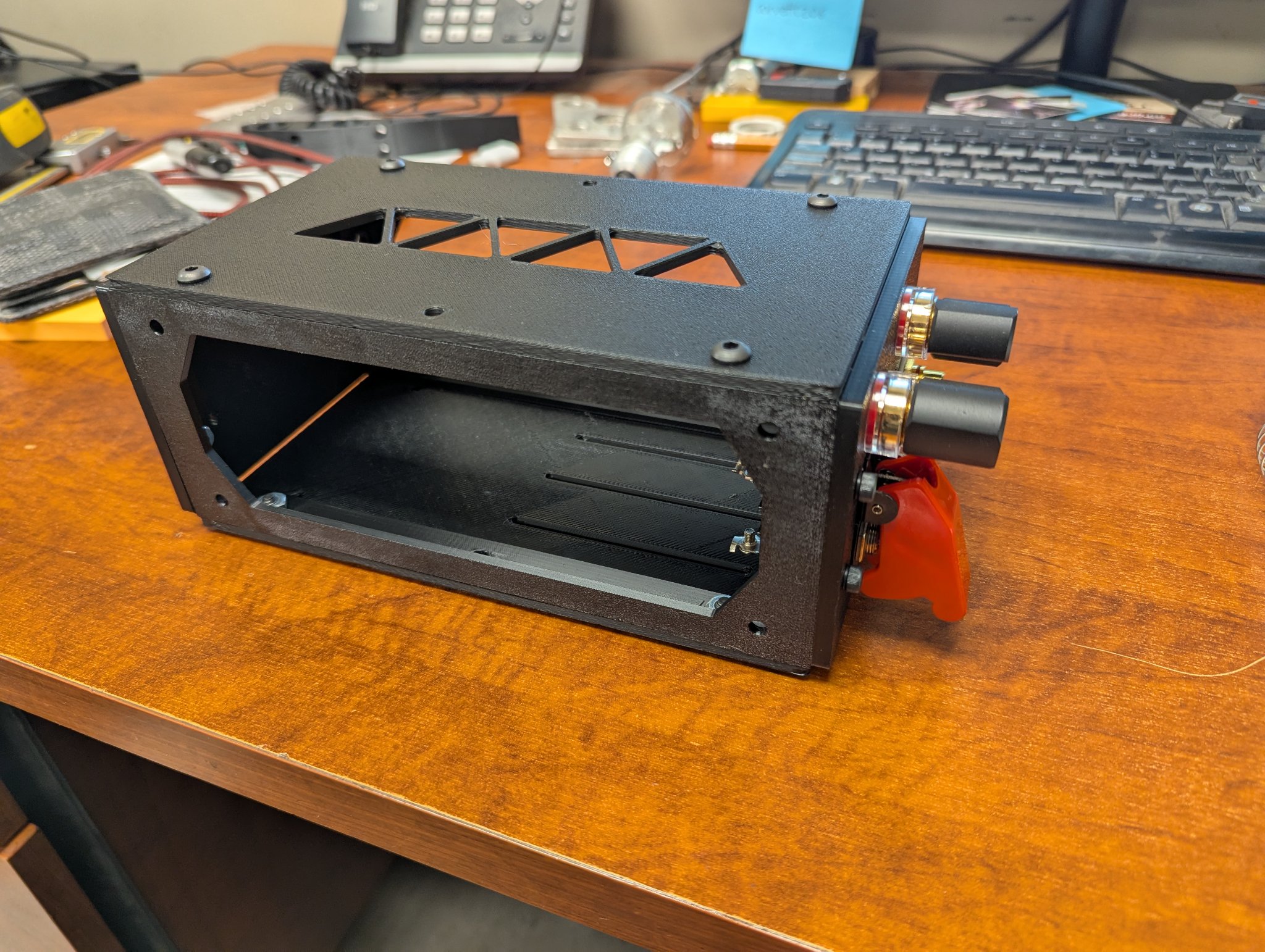

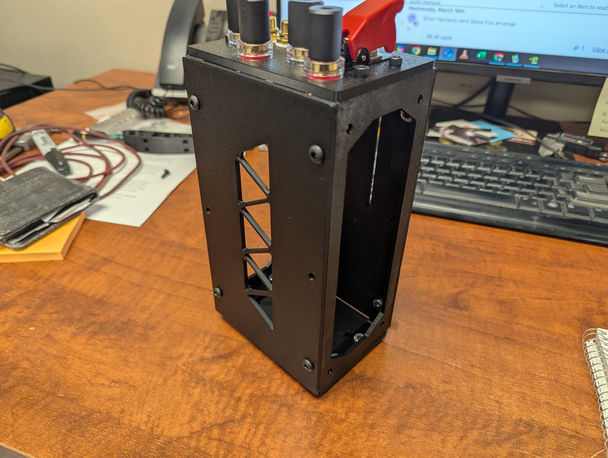

I bought a pair of ACA boards to make nice little monoblocks for my PC setup. Living in Canada makes it pretty hard to justify the cost of the chassis with parts and shipping so I was able to purchase everything from Mouser and I've actually designed some 3D printed chassis in fusion 360. When all is said and done I'll most likely have the top & bottom covers lasercut from 1/8" steel and use high temp filament for the rest.
I still have a few fitment issues to work out on the chassis, but once I'm finished I'll make the files available publicly for anyone to download.

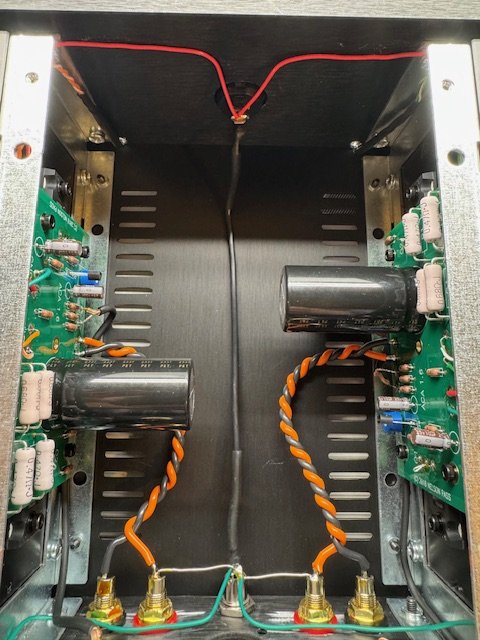

For any others- answered my own question: Saw in the 1.6 build guide I believe - had a rear panel wiring layout that filled the bill without the resistor. I just eliminated the bal input and its working great! Did the Nichicon KG gold tune cap 47k 63V for C1 spot and Elna silmic2's for C2,3 and 4. Will see how these sound for a while then maybe swap out to the aluminum organic caps at 2,3,4 spots. So far sounding really nice!

@blue360cuda Super clean layout! What was your objective in making these changes? Is the difference in sound noticeable?
Thanks! I hate having a rats nest of wires if needing to troubleshoot and like how solid core bends and stays put so things look tidy. The Belden 9497 has a big following with the tube amp guys, which I mainly am, so had a big stash of that lying around - used it for the output wiring here.
Made the changes based on the "ACA with premium parts" post. I did the aluminum organic caps in my first ACA but kept the CD C1 filter cap. Always had good luck with the Elna 'lytics in other projects and happened to have the correct values in my stash so wanted to hear how they sounded. The KG gold tune got good marks by other uses so jumped right for that one. Bought a quad of the KG gold tunes so will probably swap the CD out of my first ACA for a KG as well.
