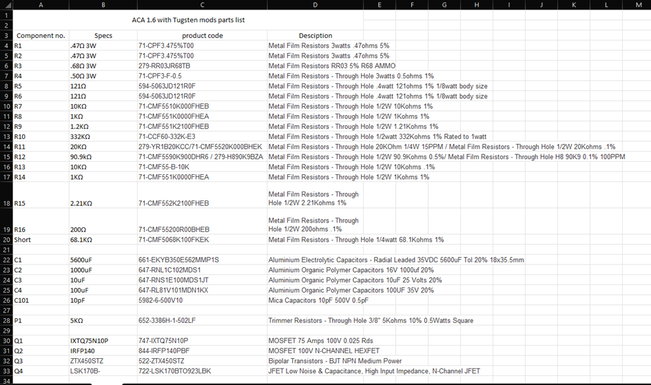

Hi bhjazz & Borats, thanks for your warm welcome. 🙂
After following Tungsten Audio mods threads carefully, I decided to ordered all the below components. Will receive them in a couple of week. Per his recommendation I'll also go for a LPS with 225VA - 2X18V with 2 x 33000mF 35V per board. I might add a resistance between the capacitors to make a CRC filter. I already started building the boxes using aluminum 1,6mm and 10mm for the front face. So mechanics before electronics.
