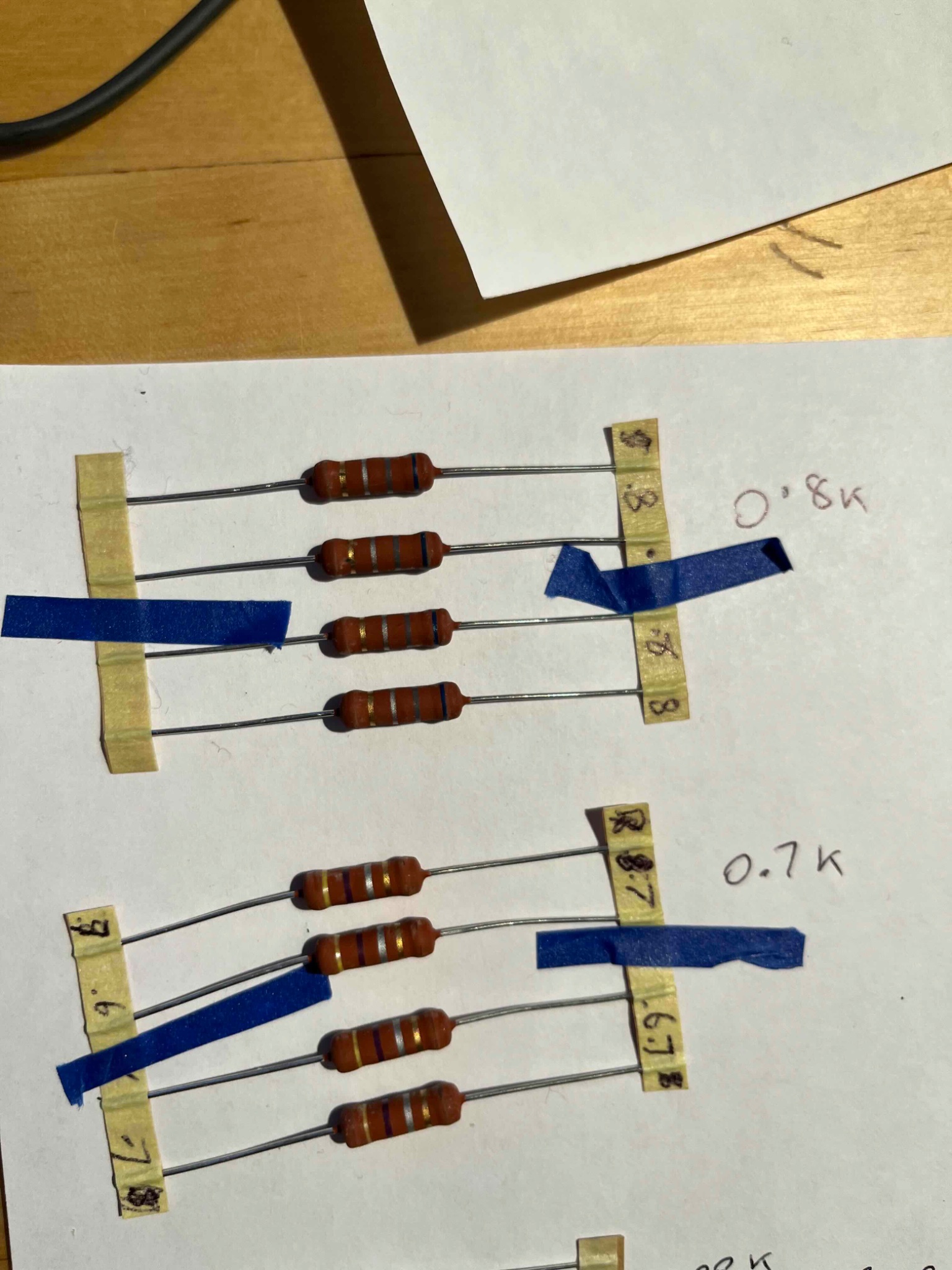

I just received a second ACA 1.8 kit having already built one several months back. The resistors R1-R4 supplied this time (see 1st pic) are different than those from the first kit (2nd pic) and also don't seem to match the specs on the board. Since I intend to use the amps as a pair, I am worried that there may be sonic differences. Any thoughts would be greatly appreciated before I start building. (I couldn't find other postings about this issue.)
There won't be any sonic difference between the two types but if it bothers you then you could fit one of each type per parallel pair. The boards would then be absolutely identical.
When measuring values on a meter remember to account for the meter lead resistance. Low values such as these can easily seem to be 0.1 or 0.2 ohms to high because of that.
