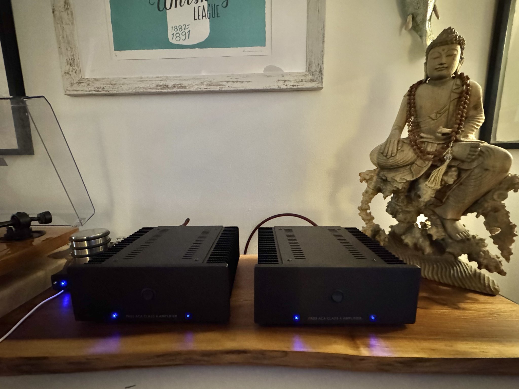

I completed my second ACA amp so that I could run them as mono blocks into my Heresy IV speakers. Whew...a whole lot easier the second time round thanks to everything this group taught me when the first one went awry. I made sure to be more careful with my soldering, used the Cardas solder from DIY, and got the whole thing up and running in just a few careful afternoon sessions.
Some initial general thoughts for anyone wanting to try this out. 1) I prefer the mono blocks with my set up. The power just feels more clear and the soundstage has separation in a really cool distance.
2) The clarity of the bass is noticeable moving from one to the other. Before ACA, bass was thick, with one amp it was thin but more responsive. With two blocks, the bass on tracks like Sade's "Smooth Operator" sounds like a real bass in attack and range.
3) Burn in is a real thing on these amps. I notice a huge improvement after about 2 hours of run time, especially between the new amp and the one that had a few hundred hours on it already. Just do not be disappointed if the initial sound is not ideal. Let it run and wait for a change.
4) For me, these are my endgame amps. I do not listen to loud volumes and this is probably the best I can afford or justify. I really love that I assembled them myself and they give me an "audiophile" sound without further obsession into snake oil or heavy investment. I will finish building my Bottlehead Moreplay next week and that should give me a less clinical sound compared to the preamplifier of the AudioLab 6000a run in pre mode. I know that my Peachtree Nova sounded closer to what I finally want, but I think the tube preamplifier will balance nicely into the ACA class a solid state.
Anyway, lots of learning here and great fun. Thanks for all of the help along the way with the first iteration.

@anthonynchandler Woo HOO! Can't wait to hear your thoughts once the Bottlehead is up and running. What mono mode are you using?
Ahhh, now that you mention mono mode, I just realized that there are two. I thought the second option was for XLR. I was using bridge mode, I think. I will have to build some jumper cables to try out parallel mode tomorrow. Can probably finish the Bottlehead preamp in a week of spare time, but I am enjoying the two amps in mono well enough. Took the sounds to a different place that works better for my room.
@anthonynchandler
my understanding is that bridging or paralleling would increase power and decrease distortion so... I modified my build plans to include a balanced BA2018 to accept balanced inputs from a DAC and a Pearl 3.
I chose the ACA Redux version for the looks.
If you have a recent build, there are three ready-made mono modes.Ahhh, now that you mention mono mode, I just realized that there are two.
Congrats on your ACAs? What version(s) did you build?
Any updates?Ahhh, now that you mention mono mode, I just realized that there are two. I thought the second option was for XLR. I was using bridge mode, I think. I will have to build some jumper cables to try out parallel mode tomorrow. Can probably finish the Bottlehead preamp in a week of spare time, but I am enjoying the two amps in mono well enough. Took the sounds to a different place that works better for my room.
