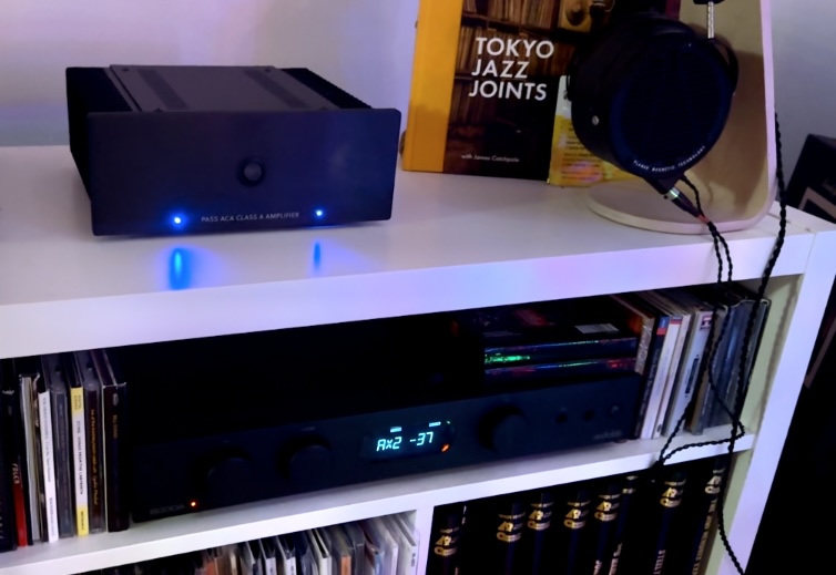

Finally. Finished. ACA Amp is now working.
I would like to thank all of you who helped me along on this build and trying to find the error of my ways. I have to say that it was frustrating, but that, frankly, I learned FAR more about how the electronics actually work than if there were zero problems. I got to see how my multimeter is used, what transistors do, what voltage does, and how to mess everything up.
In the end, I think that my original issue was that I did not solder the Channel A output to the cup properly, which is why I had no sound on that channel.
Then, when I was starting the troubleshooting, I undoubtedly fried one or both of the Channel A mosfets, hence the power surges.
I ordered in replacement mosfets and some backup parts from Mouser and within a few days I had them in hand.
With the board out and disconnected, I pulled the two mosfets and added the new ones. Everything now runs and I biased the pots to approx 12v each.
Plugged into my system, I am using the AudioLab 6000a as the preamp into the ACA in stereo mode out to Heresy IV speakers. Out of the gate it definitely sounds different that the AudioLab as an integrated amp. Seems more crisp and separated than the AL, and I feel like the bass is less. The db level needs to go from -35db to about -19db to get the same volume.
I have a headache after the work, so I will need some time to see what I prefer, and maybe it is more about understanding the differences than saying one is "better".
Thanks again for all of the help and support.

Congratulations!
Now, here is the sad part that no one explained... you're going to enjoy this for a while, then you're going to want to buy a second one so you can run them as mono-blocks. It took me about a year, I think. I now have two ACAs running in bridged mono and recently added the ACP+ preamp, all feeding my Forte IIIs. It sounds fantastic! I think the ACAs pair great with Klipsch.

With some quieter listening tonight, I think I now understand the sound of the amp a bit better: given the low output wattage it sounds best at a lower input from the preamp? When I dial back the db to a -30db (instead of the -19db to match what the AudioLab output as an integrated), the ACA takes on that silent darkness people write about where the music seems to leap out from a solid black. I could see how using it as a monoblock to increase the wattage would change things for a listener. It does make for more difficult listening with an 8 year old singing show tunes in those quiet background spaces, however. Ha ha ha.
Overall, this was a great build and I am happy with the ACA!
