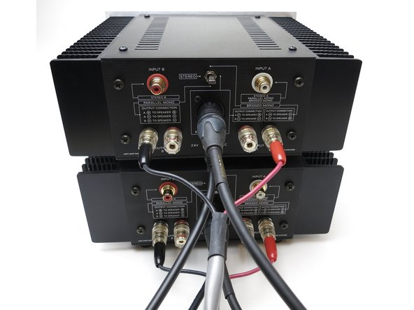

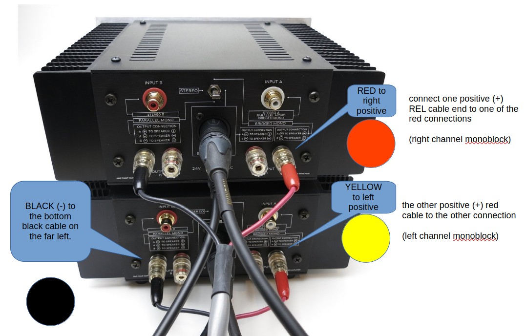

First, take a look at this pic from the build guide at: https://guides.diyaudio.com/Guide/Amp+Camp+Amp+V1.8+Change+Information/10?lang=en Later on you can find step 15 MONO XLR Bridged from that post.
1) This will put the subs in mono (the signal is summed):
Since you would be using two ACAs running balanced mono bridged:
connect one positive (+) REL cable end to one of the red connections,
the other positive (+) red cable to the other connection,
and the last one (-) to the bottom black cable on the far left.
2) This will put the subs in mono for each channel (the signal is not summed):
connect one positive (+) REL cable end to one amp red connection (as per the pic above),
the other positive (+) red cable to <nothing>,
and the last one (-) to the same amp black cable connection on the far left.
The subs, then, end up being one channel or the other.
Finally, I don't know what these connections will do to the ACAs, how they would change the output impedance or anything, really. I will reiterate this information from my earlier post: give REL or an authorized REL dealer a call. They can confirm (or deny) my proposed connection methods and can better describe the impact these connections will have on your ACAs. I'd hate for you to release the magic smoke...or worse.
Cheers!
