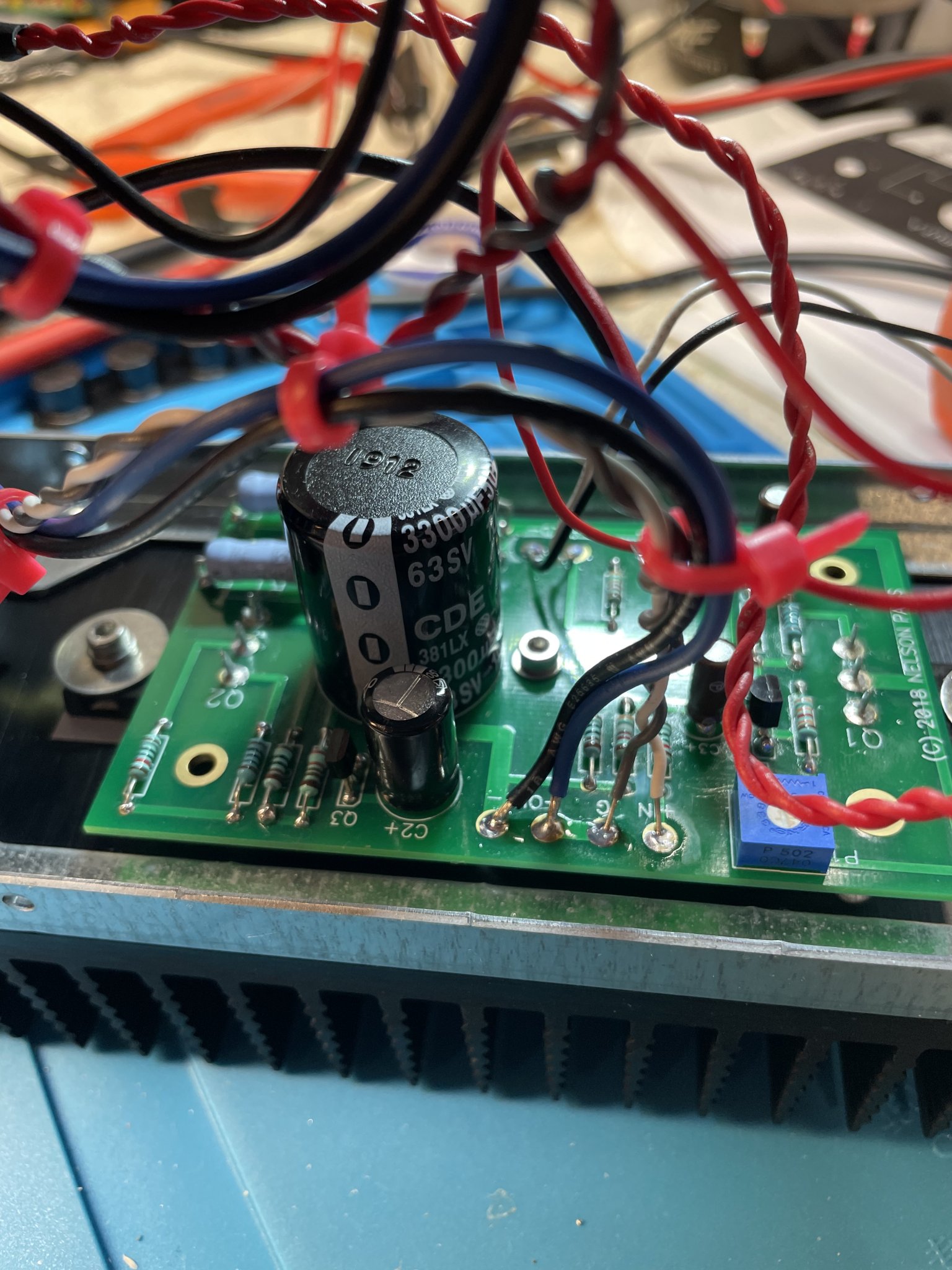

Just finished my aca build and went to set the dc balance voltage on P1 trimpot
Red channel adjusts ok
White channel reads approx 22 volts and adjusting the trim pot does nothing at all
It stays at 22v no matter what
Using pin2 on Q1
Any ideas ??

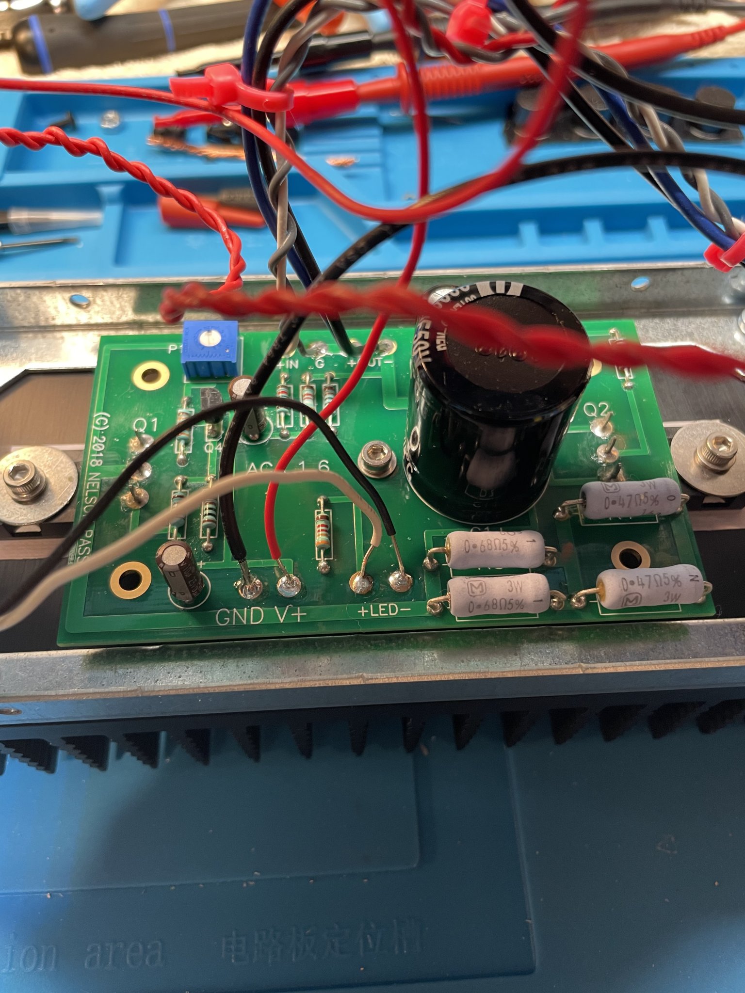

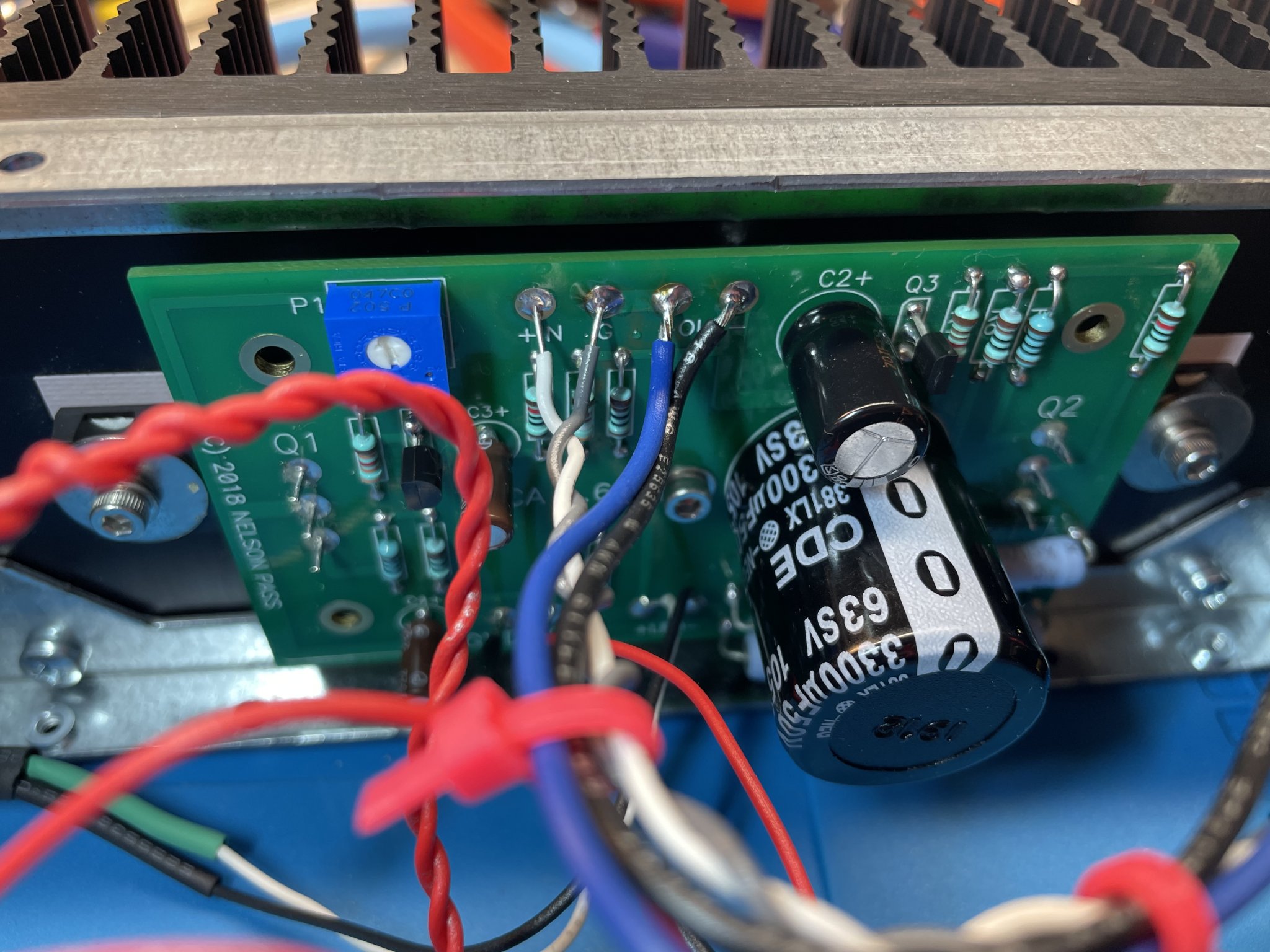

Here are photos of problem board

It's just a wild guess, but if the supply voltage is more or less showing up at the output, I wonder if there is a short somewhere. Unfortunately, that would probably be more visible from the back. Or maybe soemthing is touching the case?
It's difficult to see the components clearly on the board, especially the colour bands on the resistors. An overhead shot of the board that is closer in and sharply in-focus would be very helpful.
One resistor to check is R9. Make sure it is 1k Ohm. And measure the voltage across R9. It should be 4V or so.
And when I said 4V or so across R9, can you adjust the trimmer pot so that the voltage across R9 is at 4V or higher?

My sloppy soldering skills had one of the wires on the back side of the board touching the heatsink
I fixed that and now the trim pot seems to be adjusting properly

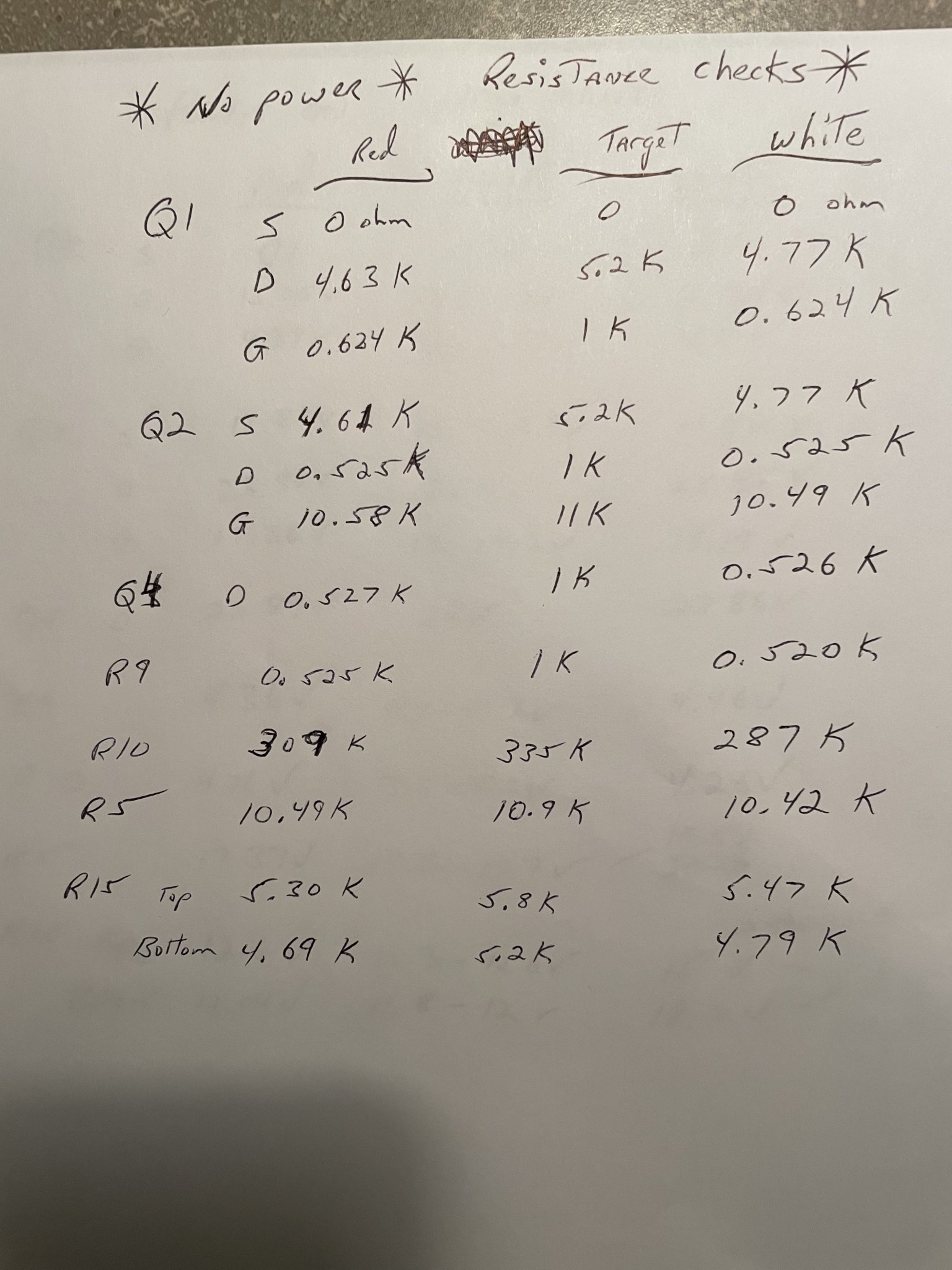

I downloaded and printed out the “test” photos for no power resistance checks and also the powered on voltage check points
The results of these measurements are in the attached photos
I am no expert but maybe R15 on white channel is a problem? It was giving me erratic voltage readings — jumping around and then finally settling down after a couple of minutes and this was after a 25 minute warmup of the amp

Sorry, for some reason I missed seeing all those...
The 12 volts midpoint is an important value and if that's in the right ballpark then it usually means the main DC conditions are basically correct.
R15 result needs rechecking. This is the current regulator for the output stage. Measure across the resistor for accuracy and you should see no more than around 0.7 volts (the base/emitter drop of Q3). If it's much higher than that then we have a problem.
So recheck that first and see where it leads us.
