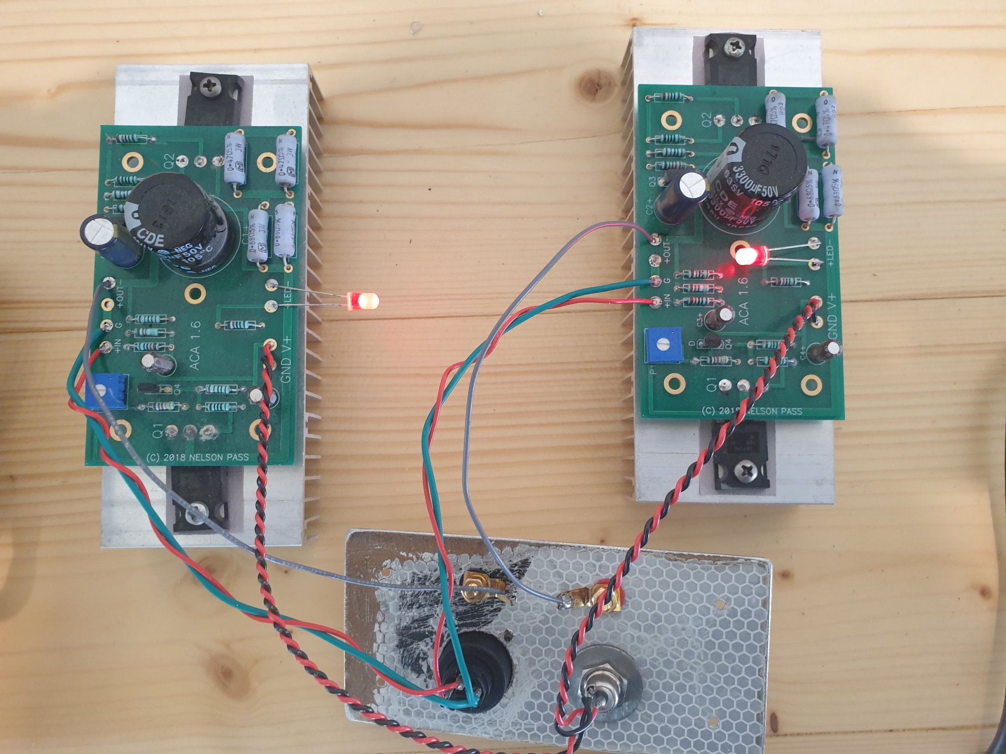

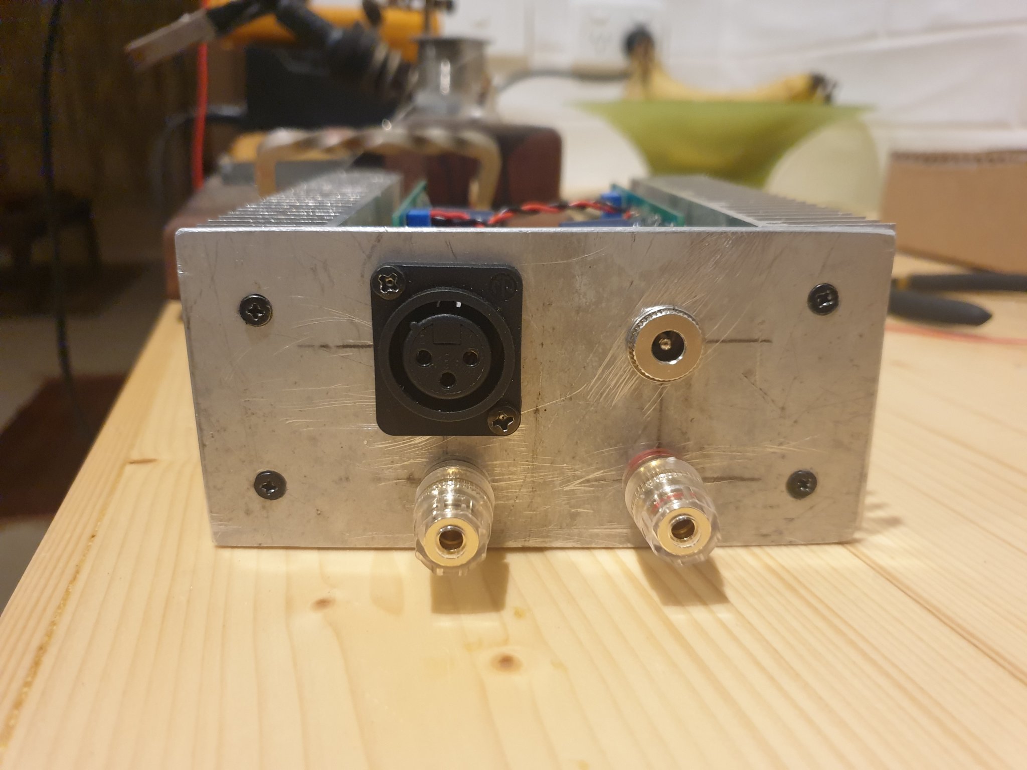

Hi all. I have just completed a set of ACA monoblocks and wishing to run them as balanced monoblocks only ie: 0ne dc inlet, one set of speaker binding posts and one XLR per monoblock and no switches at all. Could someone please provide a wiring sketch for this arrangement as my skillset not sufficiently developed to nut this out. How could I wire up just one led on the front panel for both channels?
wire power wires to both "channels" in case, as usual
take -Out from one pcb to one output terminal**
take -Out from second pcb to second output terminal**
connect XLR pin 1 to GND input pads on both "channel" pcbs
connect XLR pin 2 to one "channel" pcb + Input pad
connect XLR pin 3 to second "channel" pcb + Input pad
simple as that
**due to phase invertion of amp stage, Pa declared hot outputs as "-"

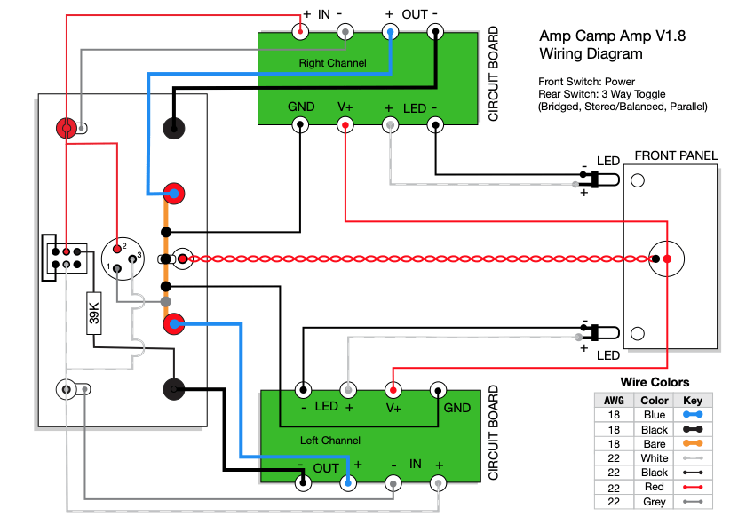

Can someone explain to me how the parallel mode works? If I'm reading the wiring diagram right, we're connecting the output of one side through a 32K resistor to the INPUT of the other side. Is that right?
You have two different transistors in the Q4 position, one flat and one round - are they of the same type? The same applies for your Q3s, one flat, one round. Q3 is a ZTX450 (flat), Q4 is a 2SK170 (round).Wired as per advice. One heatsink seems to get quite warm (LH) after 30 seconds while the other remains cold (RH).
No, that's the balanced mode with RCA input, the second input uses the inverted signal of the first output.Can someone explain to me how the parallel mode works? If I'm reading the wiring diagram right, we're connecting the output of one side through a 32K resistor to the INPUT of the other side. Is that right?
In parallel mode the two inputs are connected to each other and also the two outputs.

I am using the ACA in balanced input mode, so the switch is in the middle position. I see on the internal wiring diagram for the 1.8 ACA that pin 1 is connected to ground. I don't think connecting pin 3 to pin 1 is the right choice...or is it? I imagine there is something else I am missing.

I want to wire this up in dedicated Bridged Mono mode (with the one RCA input). I see on the wiring diagram, the left channel RCA is the only input in this mode. I see that RCA input is wired to the left channel input. But I don't understand the 3-way toggle, how does input get to the right channel? How would I wire that up?

Thanks much.R channel input is taken from L channel speaker black via the 39K resistor.
