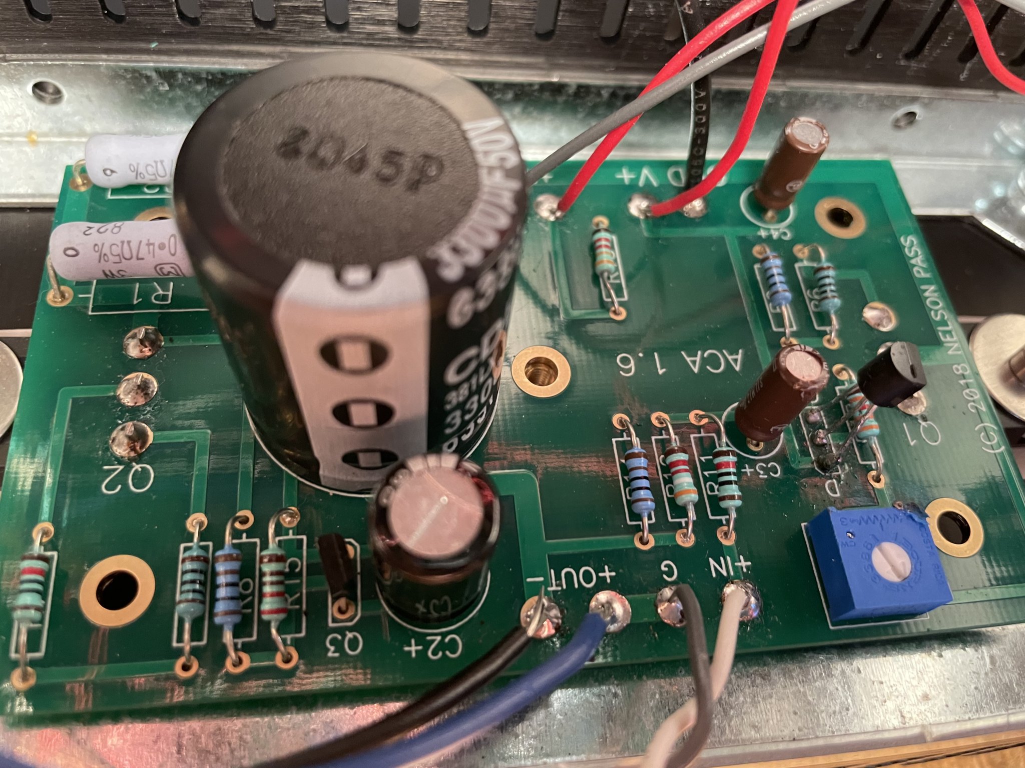

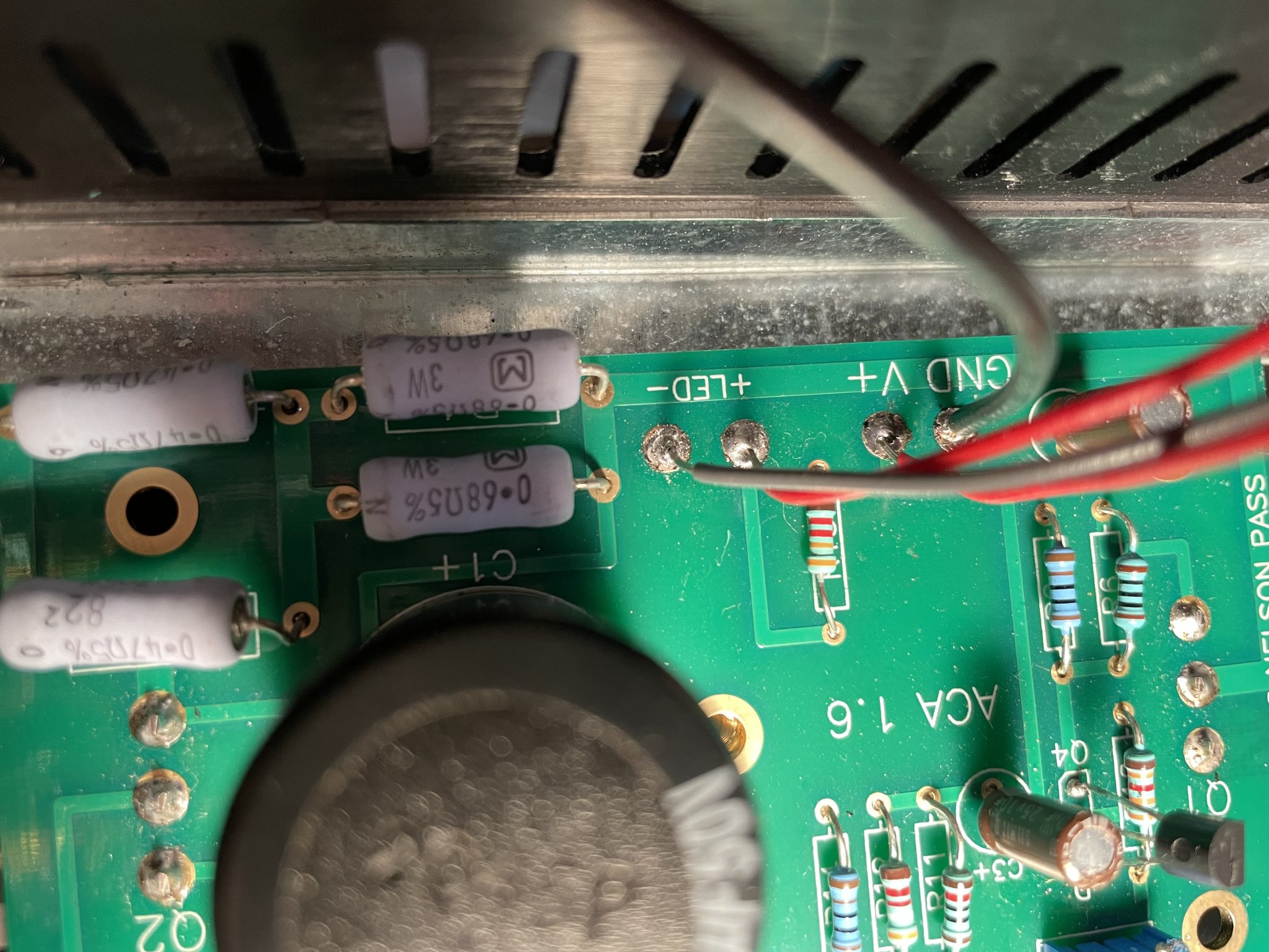

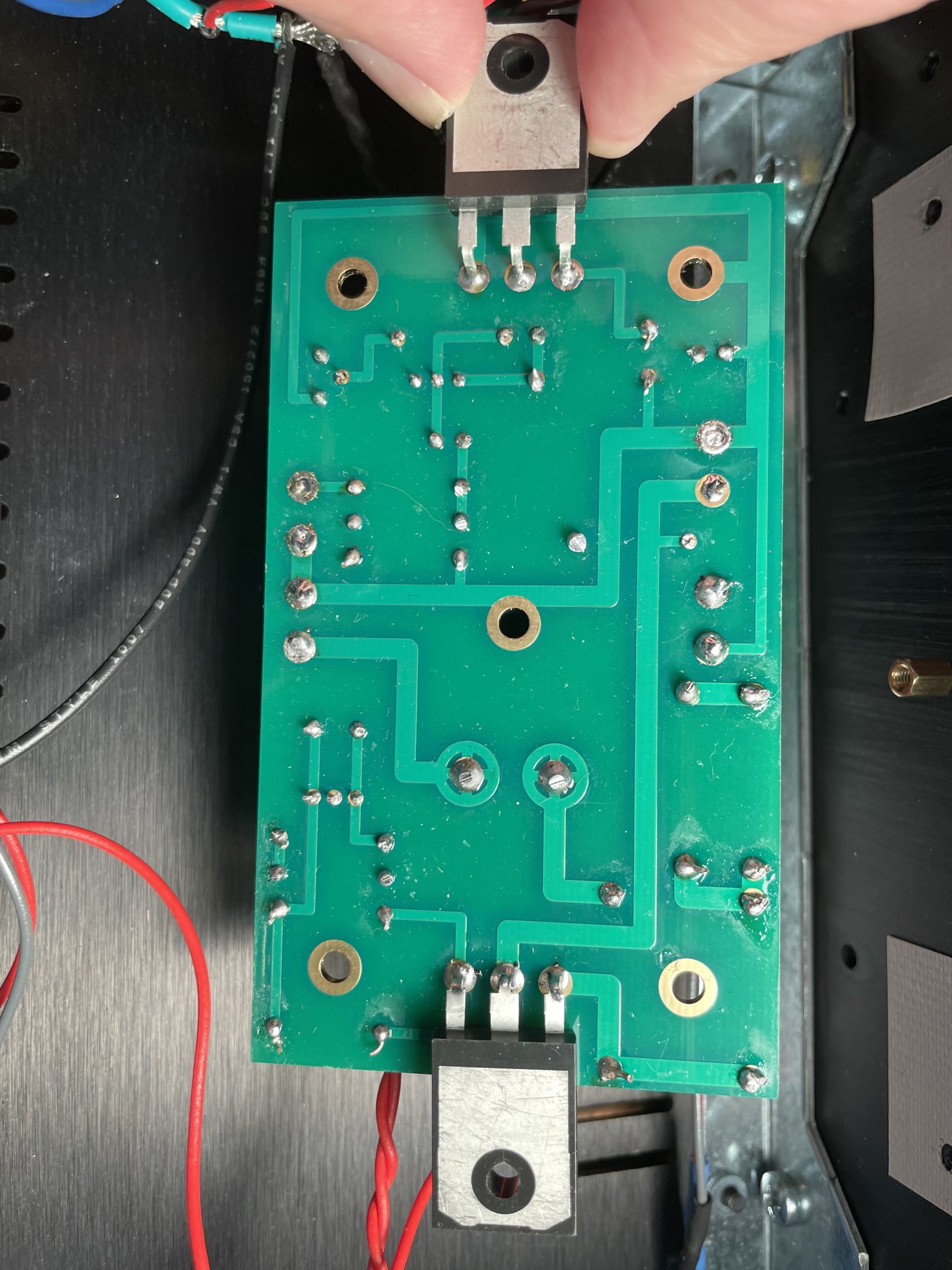

I was given parts for an ACA that its previous owner had given up on. I managed to piece together everything and get it all put together, or so I thought. When I powered it up and checked bias I found that one side was cold, though the LED was on. I measured just over 24v, which didn't change when I adjusted the trimmer. Any ideas for where I might start troubleshooting?

I would resolder all your joints. Some look suspicious. Also, make sure that you trim all the wires that goes THRU the circuit board, so they don't short out when you bolt the boards back onto the heatsinks.I can disassemble it further, obviously.
Cool! Nice find. Glad they are working well!Hey guru, yes I found the problem. One of the JEFT connections was severed. That spot on the board was heavily puckered from heat. Possibly the point where the previous owner had some trouble. All fixed now, bias is normal, listening to it now...sounds good!

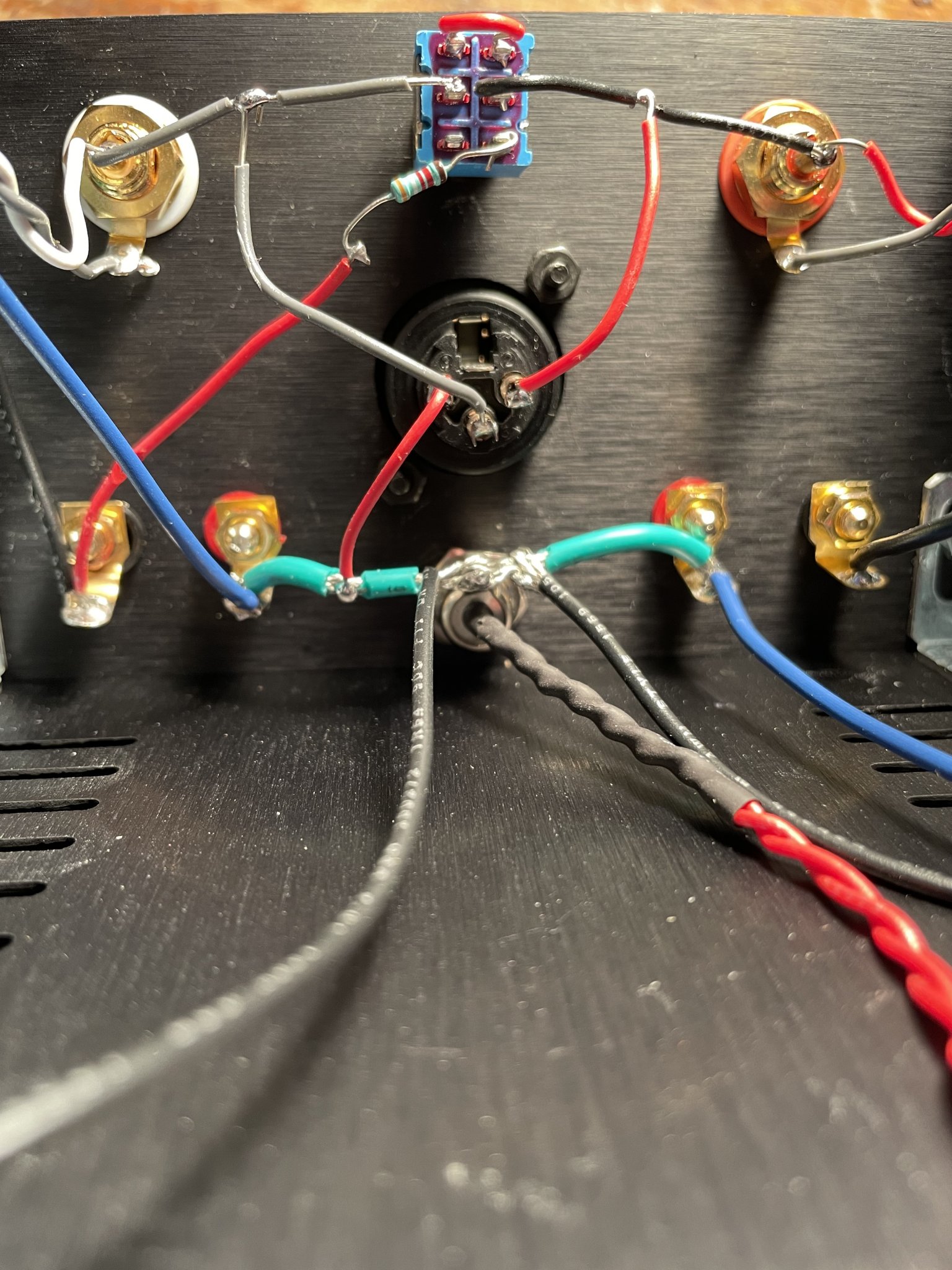

Hello all,
I'm building a pair of ACAs at the moment and was just wondering - is the twisted pair of wires bringing power to the switch from the backplate a twisted pair simply to have gauge equal to the two wires that split off to the V+ on both boards? That is, if you had wire equivalent to double the gauge of the individual wires in the twisted pair, could you simply use one length of that from the power in to the switch? Say 16 or 17 awg for two 20 awg wires?
Cheers!
Cheers!

Hello! I know this is working now but I thought I'd mention that in the third photo it doesn't look like the middle leg on the trimpot has been soldered - not sure if you fixed that one as part of your troubleshooting.
Anything that can carry about 5 to 6 amps will be fine. Two x ACA boards each use 1.5A, so the twisted pair only need to carry 3A. Best to over spec hence the 5 to 6A suggestion. There are current rating tables for AWG gauges.
Excellent. Thanks for that, Alan.
