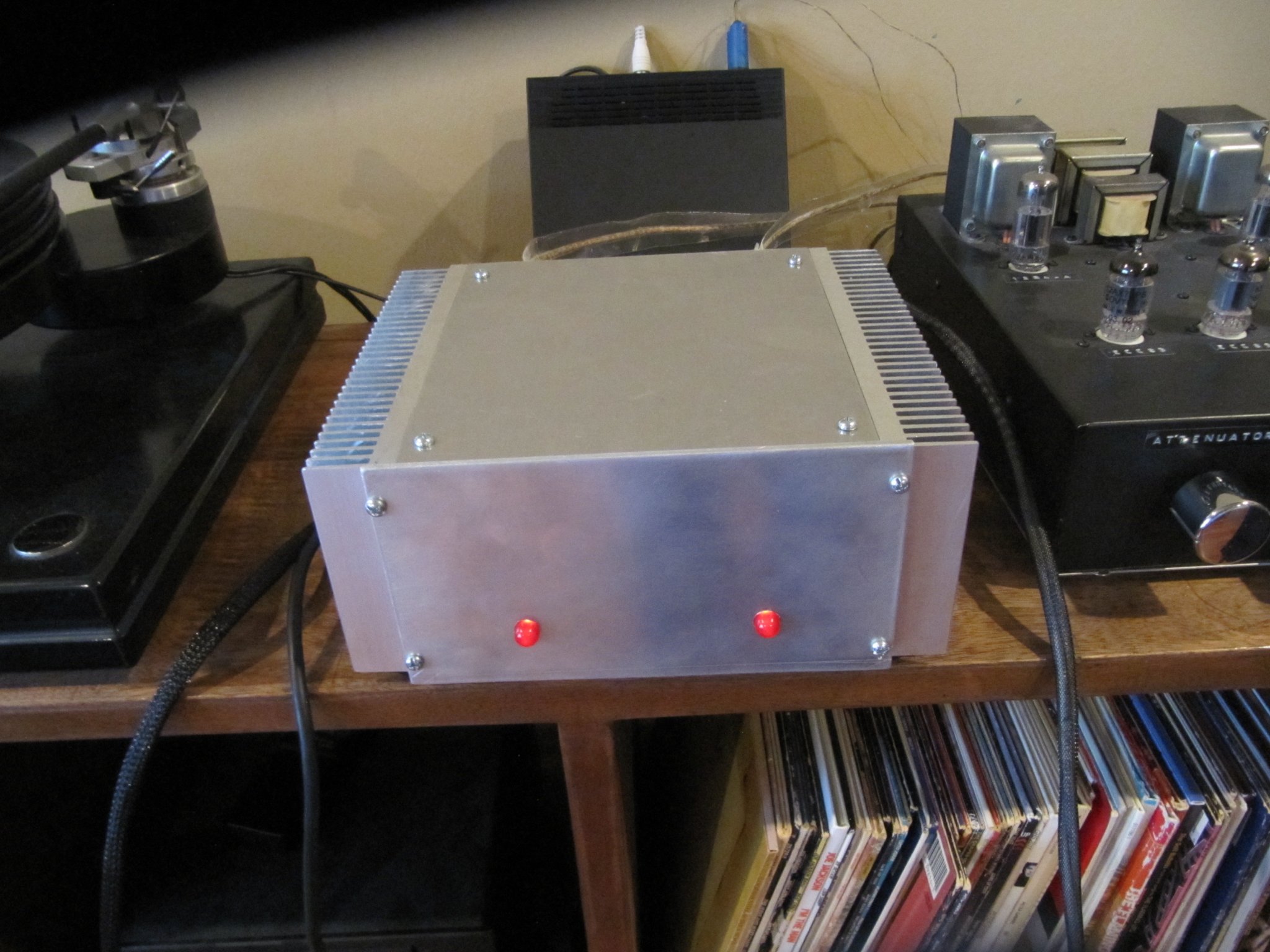

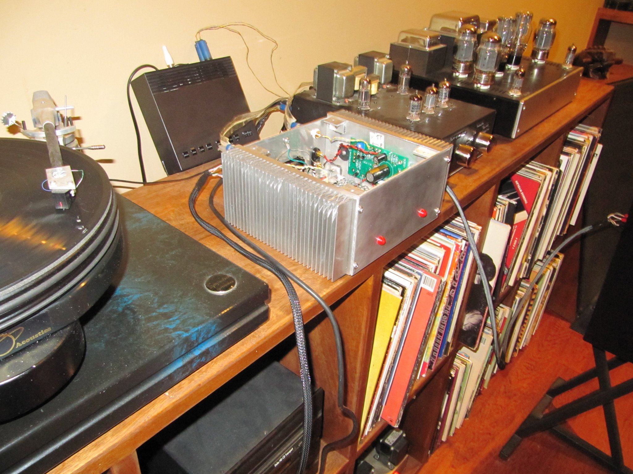

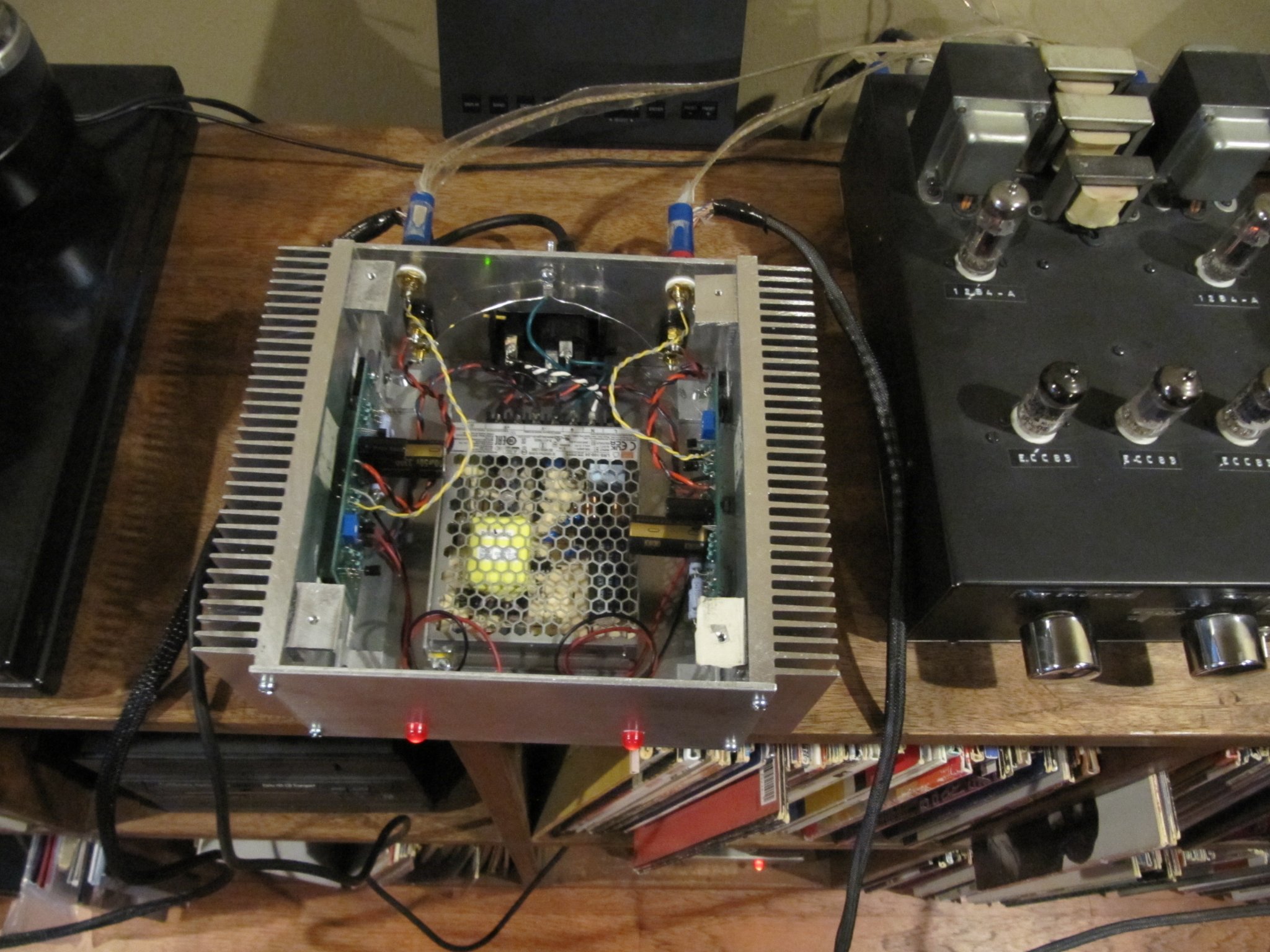

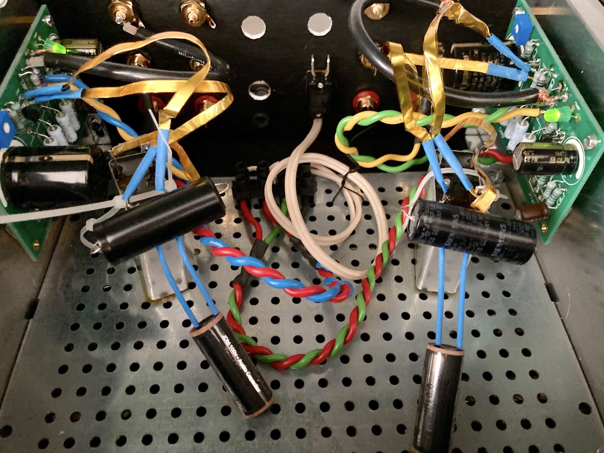

Some of you guys may remember I built a pair of Amp Camp amps back in 2020 while I was recovering from a total hip replacement. You can see my build thread in the ACA amp with Premium parts thread from that time-frame.
Here's just a piccie of the interior as a refresher.

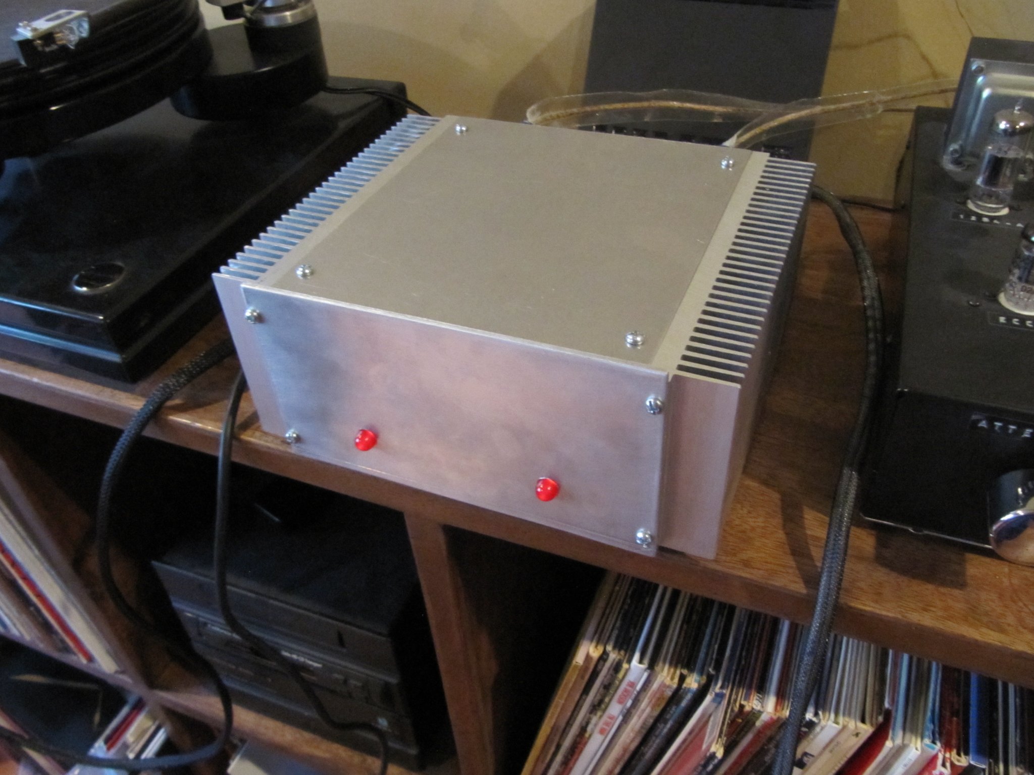

Here's a pic of the ACAs and the Altaira(s). The SG Altaira on top of the ACAs is resting on two HRS Nimbus Spacers and Couplers and is the "analog amplification segment", and is connected using Shunyata Alpha chassis ground cables to the chassis ground terminals of the First Sound preamp's main control unit (MCU) and it's external dual mono power supplies (for a total of 3 ground connections). The Amp Camp amps are also connected to this "analog amplification" Altaira using Venom RCA chassis ground cables ("CGC"s) connected to unused RCA inputs on each each ACA monoblock. The SG Altaira at the back of the photo is dedicated solely to the digital stack, and is connected with a Venom CGC to the Holo May KTE DAC's unused S/PDIF input and an Alpha CGC to EtherREGEN's ground terminal. Each Altaira is connected at it's 7th terminal using Omega CGCs to separate ground terminals to a Shunyata Everest power distributor.
Using this this system with the ALTAIRA system stripped out so much noise, hash, grunge, and grain from the presentation that it completely transformed the quality and performance of the system powered by these wonderful little amps for pretty much every "audio attribute" you can think of. The Altaira system also improved the clarity, imaging, added more body to voice and instruments, more air to the presentation, and the dynamics and "slam" really improved. The "hall" ambience is much more fleshed-out and present, and "vapor trail", that decay you can hear trailing off into the performance space, is notably more "tangible." Most importantly, the system sounds much more natural, "organic", and most-importantly, musically-involving.

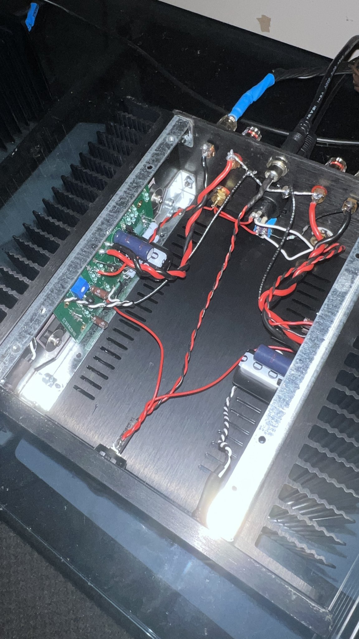

Hey guys,
I recently built and configured my ACA in monoblock configuration.
For some reason my left ACA is playing noticeably lower. I tested this by swapping back and fourth. The other side is much louder. I’m not sure what’s the culprit. Any ideas?
