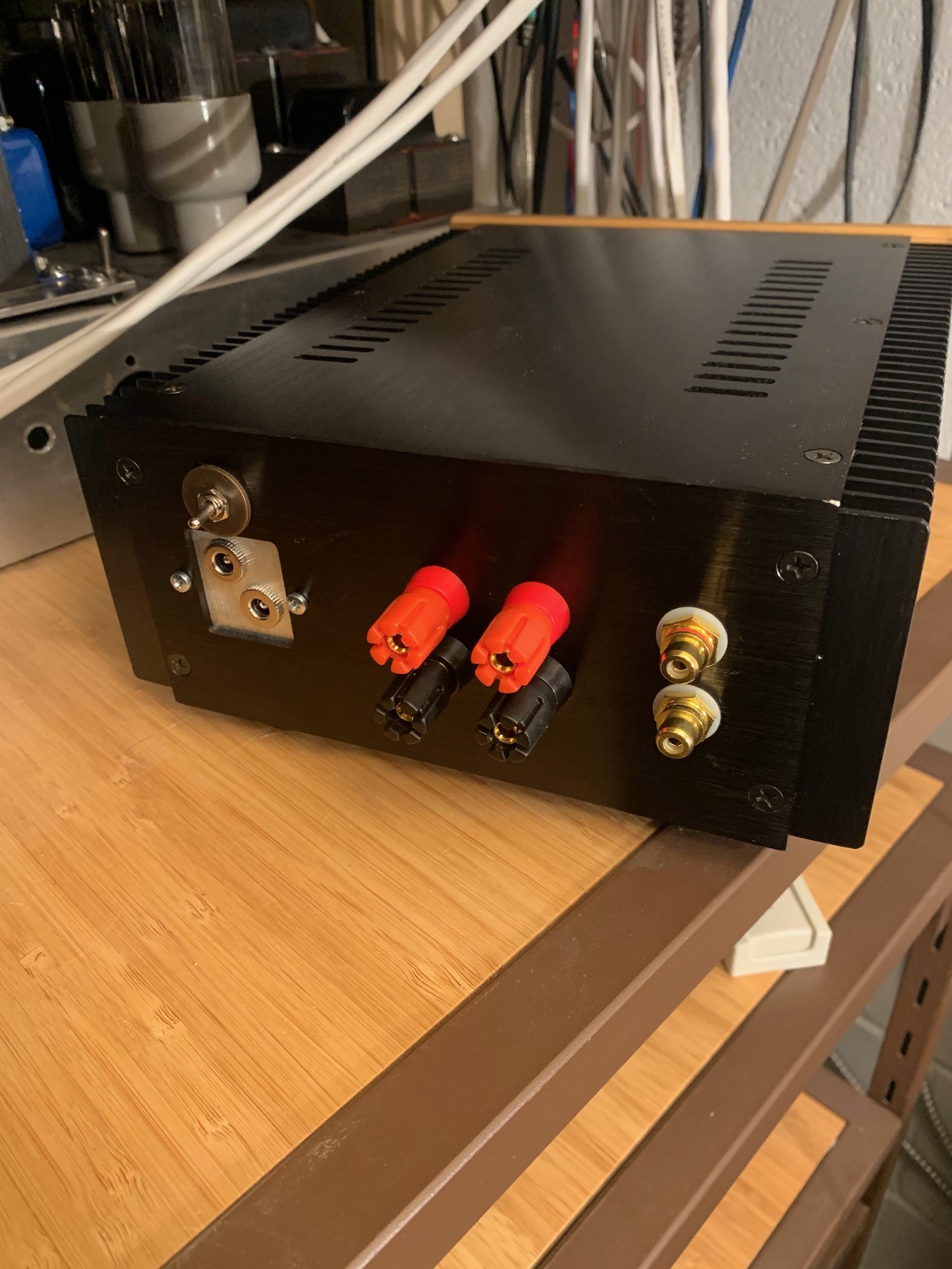

I still have noise coming through the speakers with the 24 Volt laptop supplies on the one chassis stereo ACA I have that is set up for 24 Volt operation. When I plug in the 19 Volt supplies into the same ACA, there is no noise. Does this indicate a problem with the supplies? Also, one 24 Volt supply on one channel, and one 19 volt supply on the other channel results in noise in both channels. Only two 19 volt supplies results in no noise.
there was no need to alter anything in settings of amp, for temporary test with 19V supply
simple - you did change PSU - no noise
back to old PSU - there is noise
conclusion - find permanent replacement for noisy PSU
btw. can you somehow explain arrangement of these two channels, each of them having separate PSU?
from situation of one 19 plus one 24 , there is noise , I'm curious where is common link, through which noise from one PSU/channel can creep in second channel ......

Zen Mod: Thanks for your quick reply. The amplifier is a single stereo chassis with two DC power inlets on a plate on the back panel that was originally made for an IEC inlet. I am using two laptop bricks because I had two identical ones handy rated for 24 Volts and 2.5 Amps each. Because of the separate DC inlets for each channel, I can use a 19 Volt on one channel and a 24 Volt on the other channel for testing purposes. Using two of the 19 volt supplies result in near silence at the speaker. I posted in this thread a few days about my concerns with having a shared ground for the two supplies. Attached is a photo of the back panel of the amp that shows how it is configured.
Other than the noise, which is audible at the listening position because the room is very, very quiet, the amp sounds great.

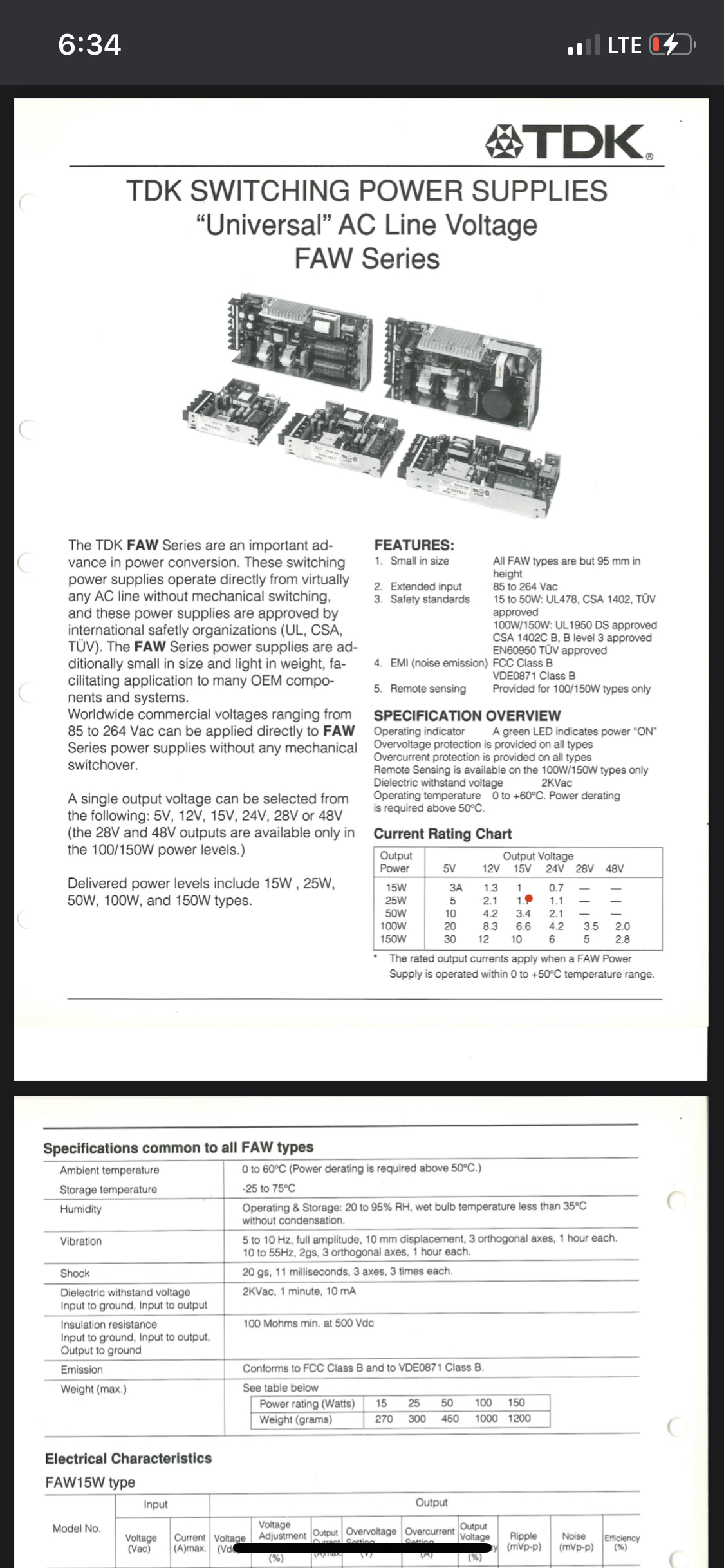

Zen Mod: I went through my stash, and found a TDK FAW24-4R2 supply. It is a 100 Watt supply with 24 Volt DC at 4.2 Amps. Are these kinds of supplies usually better than generic laptop blocks? Also, is 4.2 Amps enough for an ACA?
try and see
one of these certainly good enough for channel
will it feed two, could happen
on the verge, but will do, at least temporary
remember - one channel (R.2 - with Iq raising resistor mod) sucking near 40W at 24V rail
