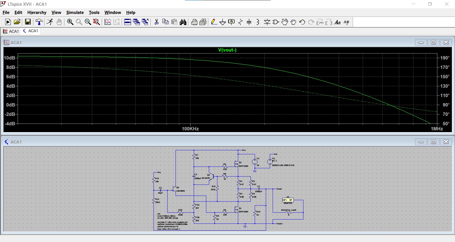

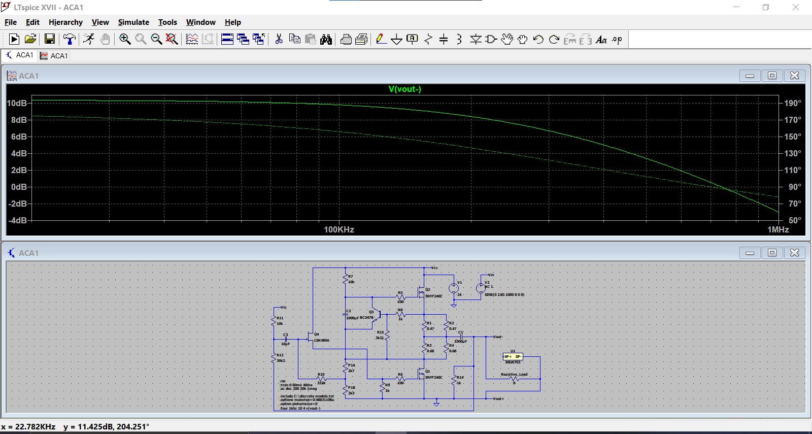

Thank you for the quick responses. I measured them out of circuit and they were all within about +/- 2% of 130. I'll use them because I find as I get older, I hear less and less above 100kH 🙂.

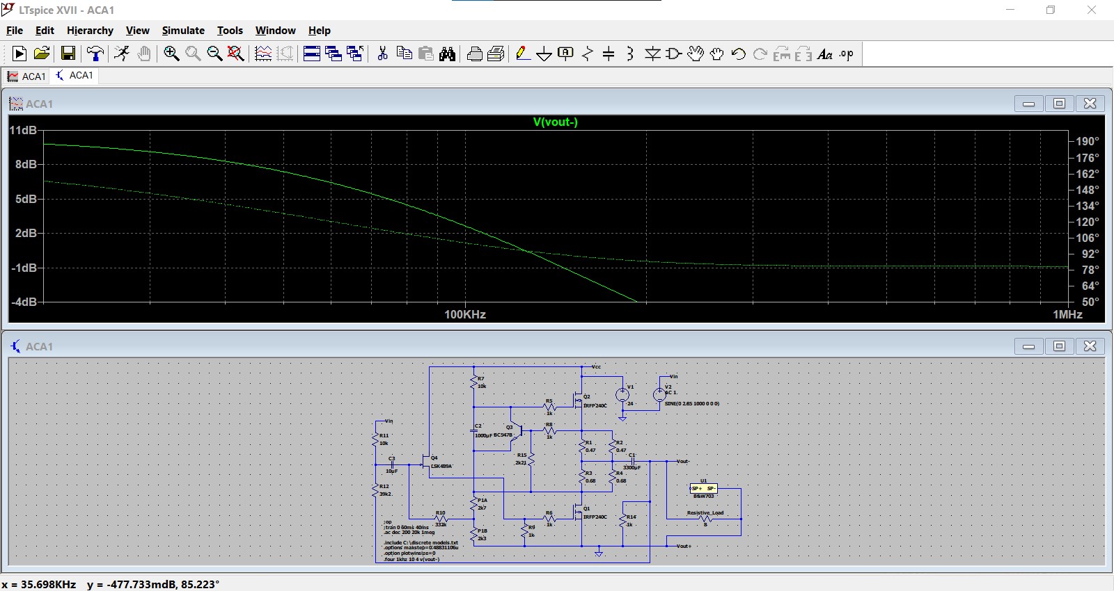

Here is the response of the ACA with 100, 130 and 1k. The scales are similar to highlight differences and the trace starts at 20kHz. 1k is getting to the point where the response starts to fall away past 20khz
Well, according to those graphs, 1K does seem to already present a 2db dip into 20Khz, right? Almost a 1db dip into 10Khz as well.
edit: oh, sorry, this STARTS at 20Khz... nevermind then. sorry.

yes, this is the whole point of the exercise, the higher the grid stopper resistance the lower is the turn over frequency, and as long as it is outside the 20khz band limit, then fine...
