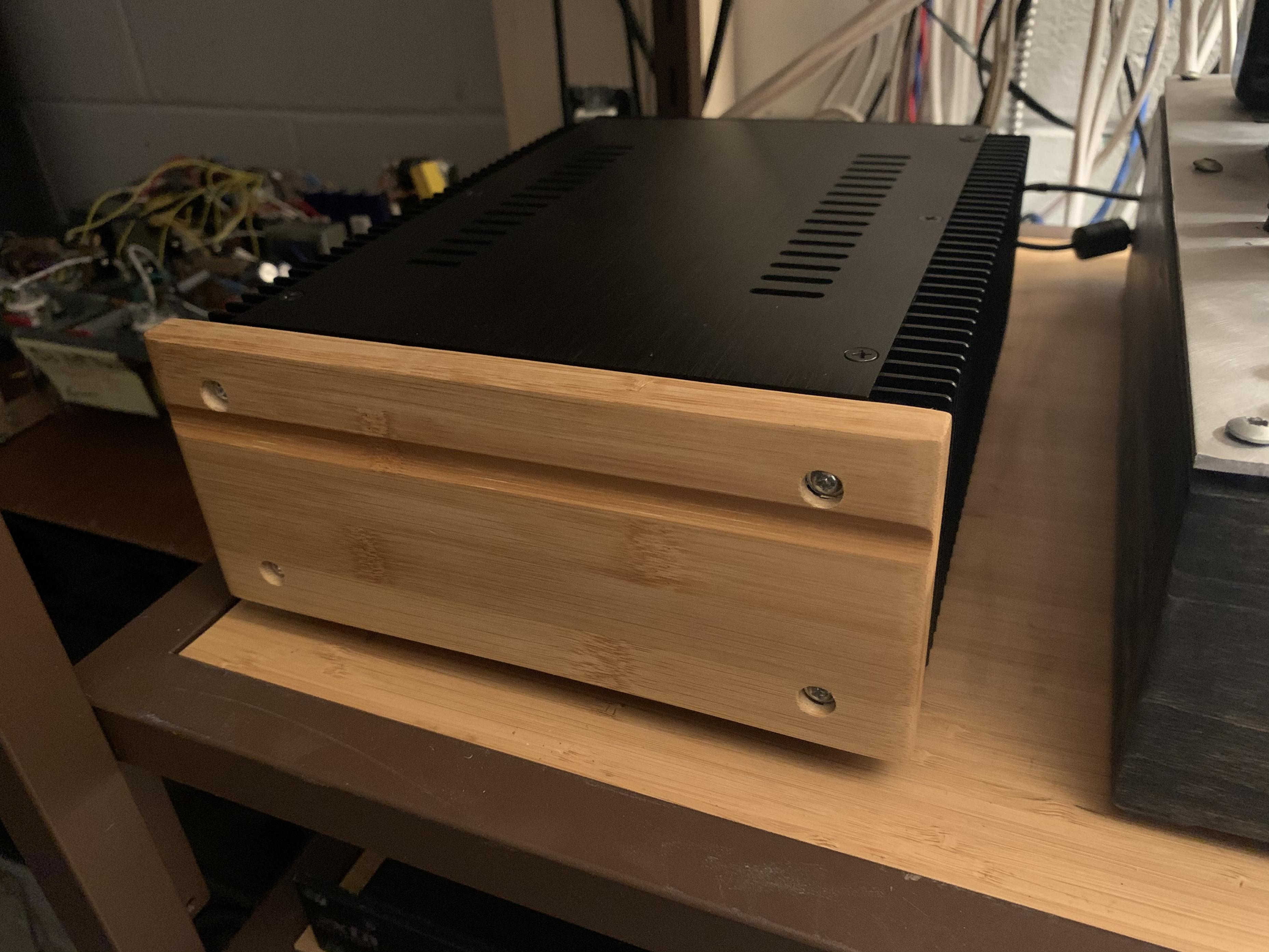

I build SET tube amps for the most part, but have an ACA and really like it. I have a pair of the older style monoblocks, and they have been upgraded to the current spec by using 24 Volts and by doing the necessary circuit changes. I recently completed a new ACA build, and used the feedback resistor value used in the older ACA.
Has anyone built and listened to an ACA with even less feedback than the older model? How about no feedback? Is no feedback advisable?

I built it with the old input and feedback resistor values of 10K and 68.1K. I just finished it tonight and am listening to it right now. It sounds great! Here’s a photo.

Thanks chermann. It sounds great, like a SET amp, with great presence, but with much better bass. I am getting noise through the speakers though. It sounds like a random chattering sound like “tch tch tch”. My listening room is very quiet, so I came hear the noise coming through the speakers from the listening position. It raises the ambient noise in the room, and since it’s pretty much the only noise in the room, it’s noticeable. I am using Klipsch La Scala, which are very high sensitivity, and very sensitive to noise. I don’t recall my old style monoblock ACAs being noisy at all with these same speakers. I’ll have to try them in the same setup tomorrow. I am using the same two 24 Volt laptop supplies that I use with the older monoblock ACAs. Could it be that the noise is coming from the laptop supplies?

as zen mod wrote: noise from both channels?
SMPS can make some noise if the are in hickup mode = to much caps as load
or
SMPS which oare in diel mode are a bit mnoise = strange beep tone, and if they are under load then its quiet.
but noise over the speakers??
Zen Mod: Yes. The amp has both channels in one chassis with two laptop supplies feeding it. I hear the same sound out of one channel when I unplug one of the supplies. It’s very quiet, but audible at the listening position.

chermann: Yes, noise through the speakers. The blocks get warm when in use for a while. They are identical 24 Volt, 2.5 amp supplies. Unplugging one leaves the same noise in the other channel. I have a different 24 Volt supply here, but it needs its plug changed to fit the inlet. I’ll do that and report back. Can I try using a 19 volt laptop brick to see if that makes the noise go away?
only way to try different bricks
Zen Mod: Is it okay to try with a 19 Volt brick as a fast and dirty test? If not, I can change the plug on the 24 Volt one.
