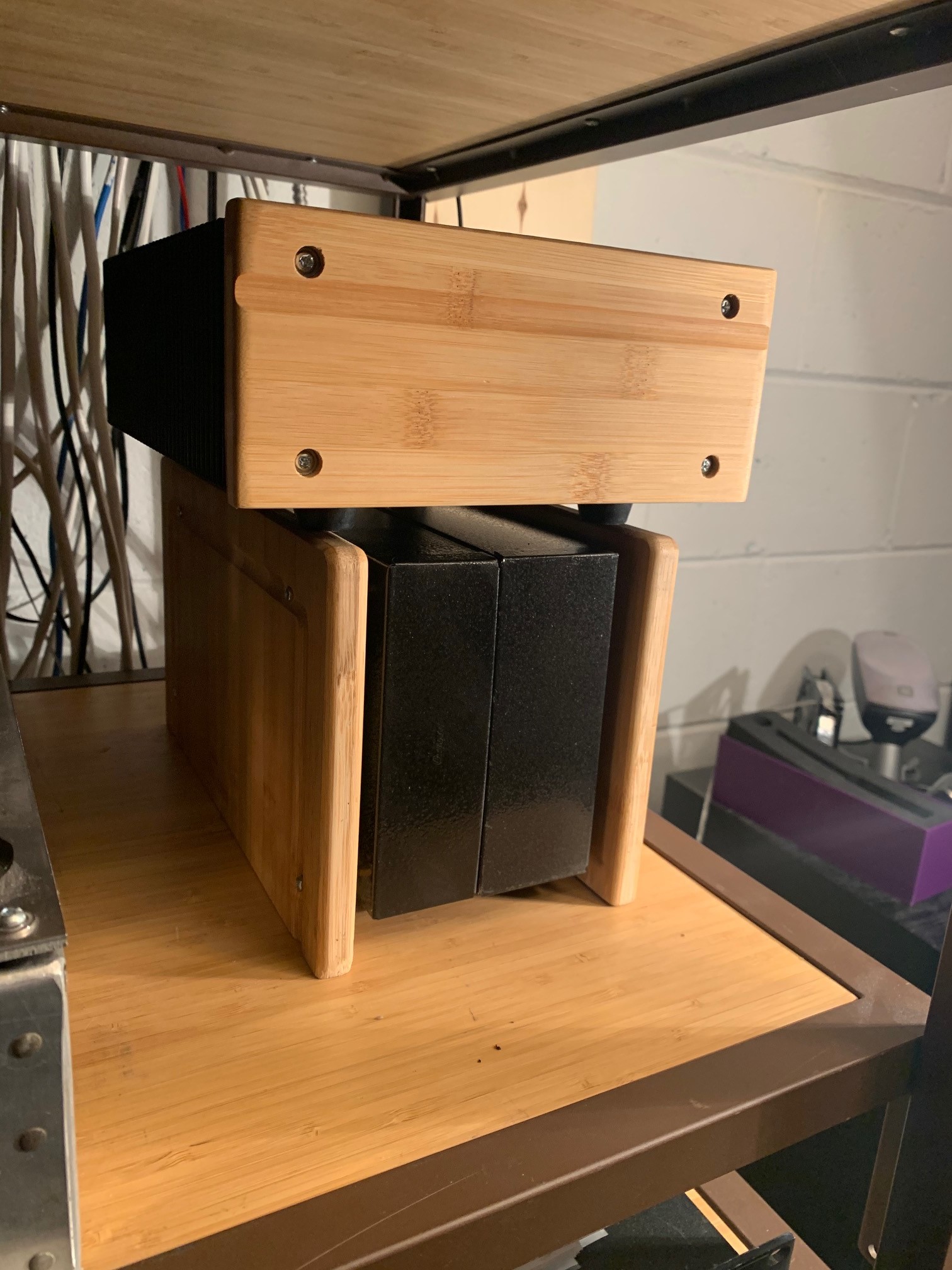

Noise is back
The noise is back. When the TDK power supply was loose and not inside a chassis, it was silent at the speakers. Now that it is in a chassis, it makes the same noise that the 24 Volt laptop supplies did. This noise only happens when the amp signal inputs are connected to my DAC. If I put shorting plugs into the RCA jacks, it is silent again. Attaching the 19 Volt supplies that I use on my monoblock ACAs results in silence at the speakers whether or not the inputs are shorted or attached to the DAC.
This is driving me crazy. Why would the supply be quiet when it is loose, but be noisy when it is in a chassis? If you have any ideas, please let me know.
Attached is a photo of the amp on top of the supply. It's still noisy when placed away from the amp.
Just so I understand. You put supplies in a chassis and you have noise.
Do you extend the supply cord out of the chassis or is there another cord involved connected to a Jack on the chassis?
I found a work around. The chassis underneath the amp is a metal box that contains a TDK FAW24-4R2 supply. It is a 100 Watt supply with 24 Volt DC at 4.2 Amps. This supply has an input for line, neutral and ground. I detached the ground connection, and the noise disappeared. It was probably a ground loop problem of some sort. There was no noise at the speakers with the same supply and the ground wire attached if the rca inputs had shorting plugs in them.

An Idea
If you remove the input source. Do you hear that noise? And what is the input source?
In my case, there is no noise with the input source disconnected. My source is a Musical Fidelity V90 DAC, which is powered by another SMPS.
Reason I ask is.. my DAC is a mini-DSP. It is fed with a USB cable from my MAC mini. The output goes to my ACA amps. It is noiseless.
I can take the same cables from the mini dsp.. and plug them into an emotiva amp and it hears things like an arc in a light switch or a power saw turning on.
There is no earth connection on the Emotiva. And adding one does nothing to help or hurt.
Fortunately, We much prefer the ACA. With all of these observations though I have to wonder if perhaps it is the output impedance vs input impedance. Will dig in a little and see.
