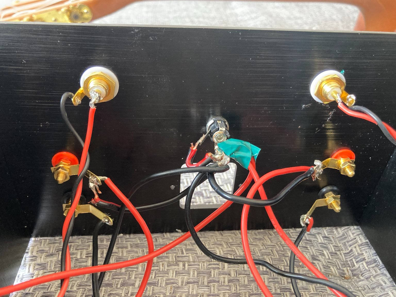

Measure the resistance between the red and black speaker terminals. It should be 500Ω to 1000Ω. If it is a low value you have a short some where. You did insulate the terminals?
Next measure the resistance between the RCA inner and outer ring. It should be about 50kΩ. If it is less something is wrong with the input.

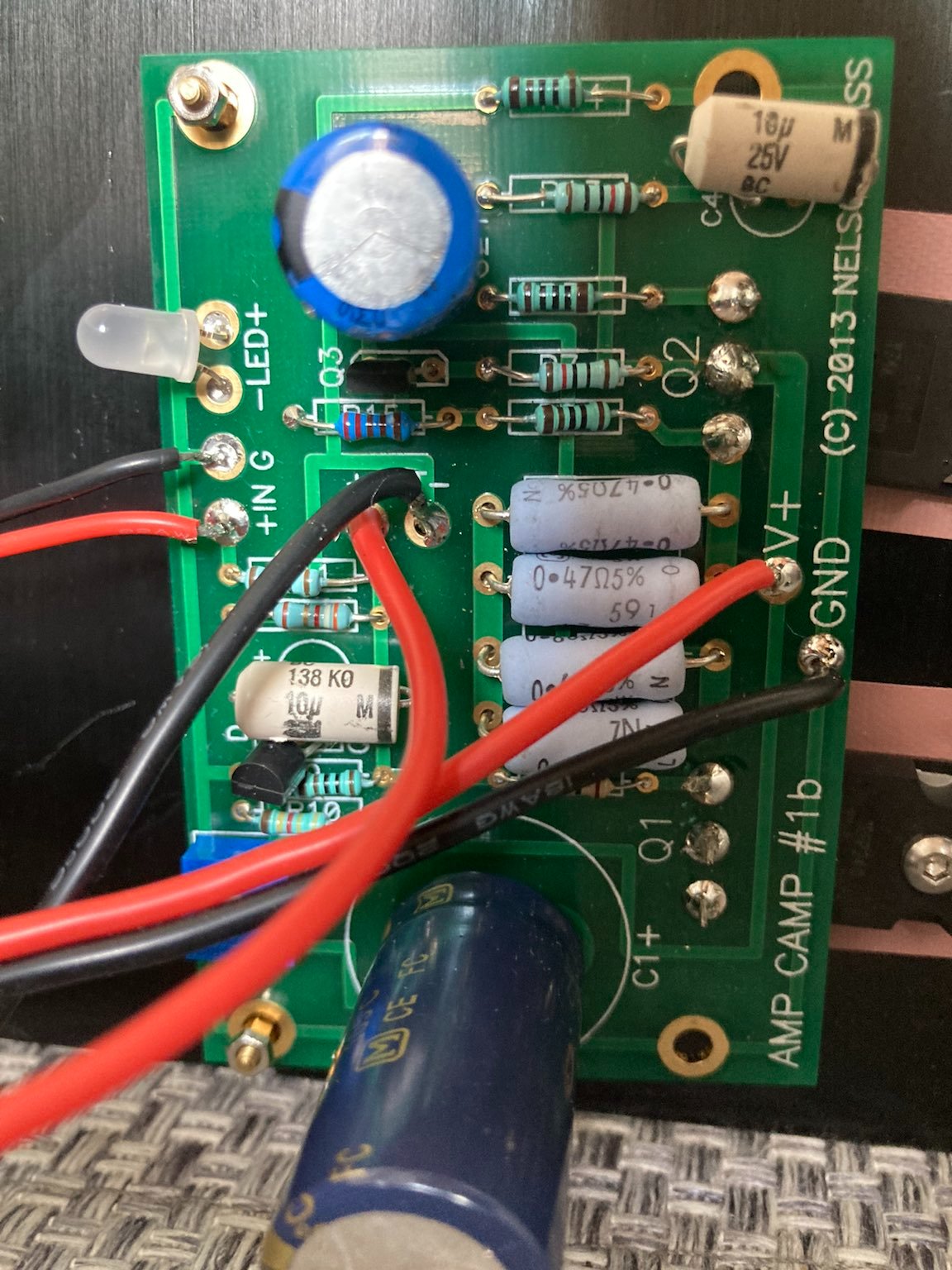

As Mooly says you should measure 0.9 volts between Q2 S and Q1 D. And what ever the problem is is 'common' to both builds.

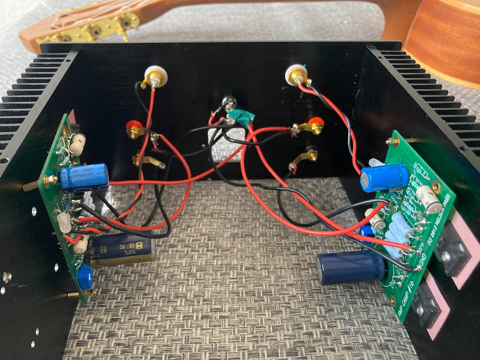

Some pictures of the build would help 'us all' have a look for a problem.

The resistance between the terminals is 800 ohm and between the RCA rings it is 12k Ohm. This is not enough?
And yes the Terminals should be isolated with a plastic ring. I measured the resistance between the terminals and the case and is too high to be measured.

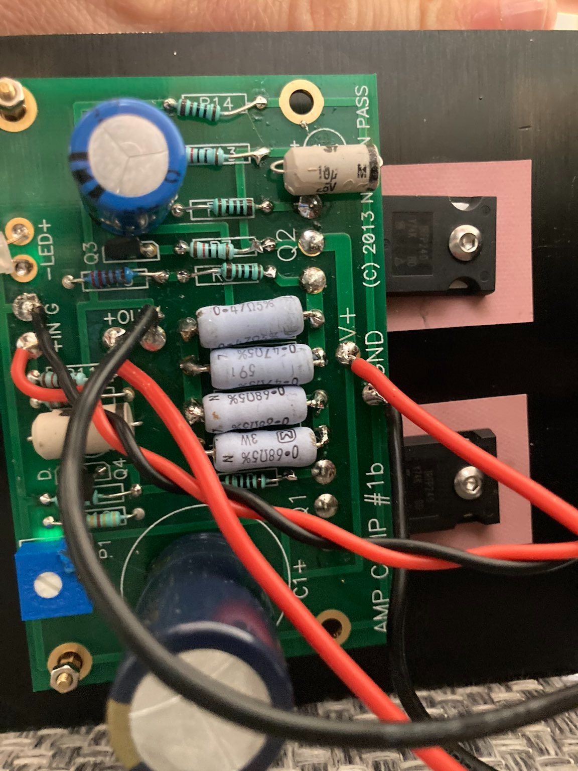

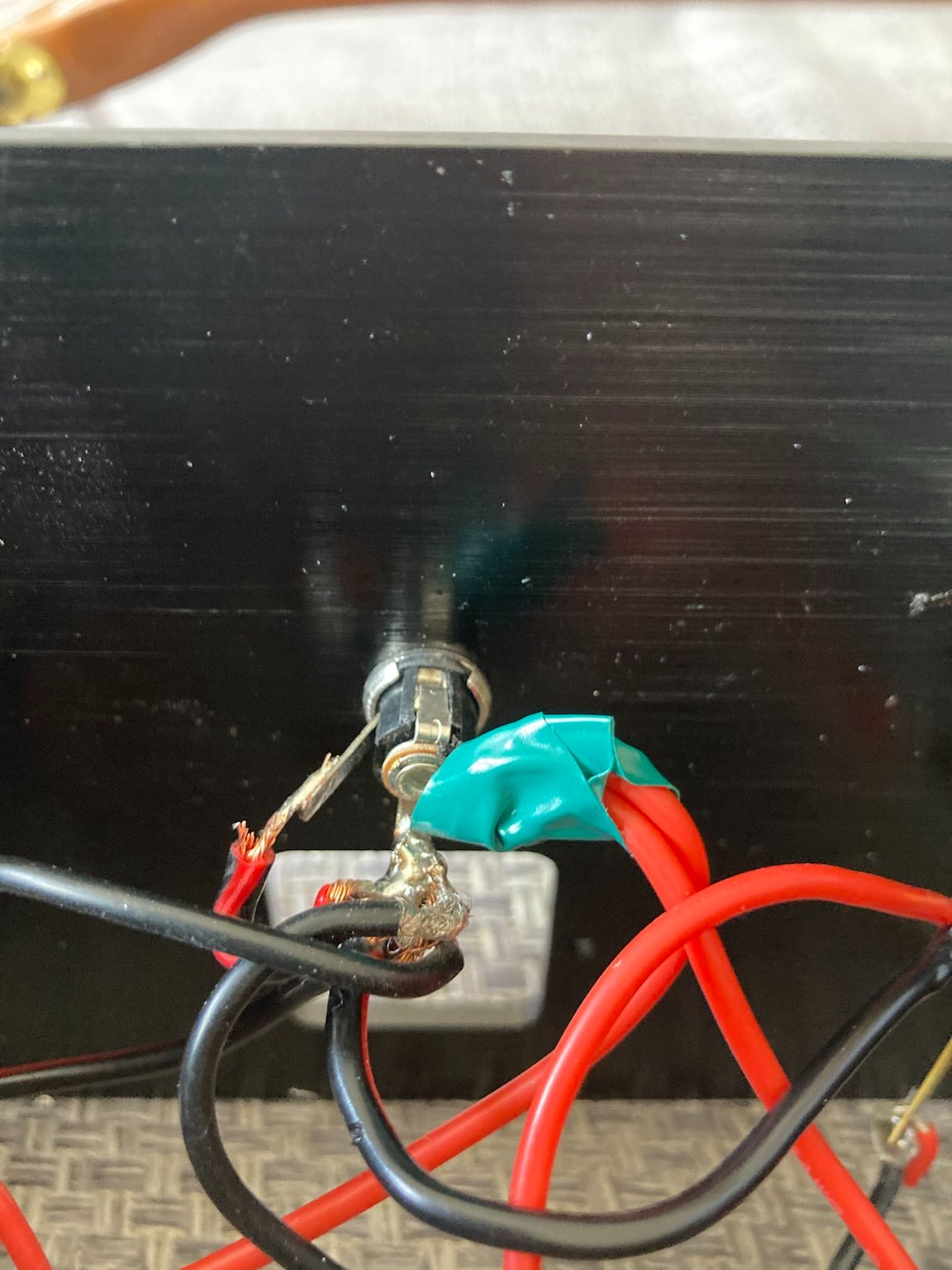

I atached some pics... Not my best work btw... did resolder everything so many times it is uglier then bevor :/.
Black is ground and negative and Red is hot and positive.
Thanks again
Oh found the error. R12 is 40 ohm and not 40k... damn i measured everything. But I didnt read it correctly.... I have to work now, so I dont have the time to resolder. But thanks very much. I will post if this is not the error....
