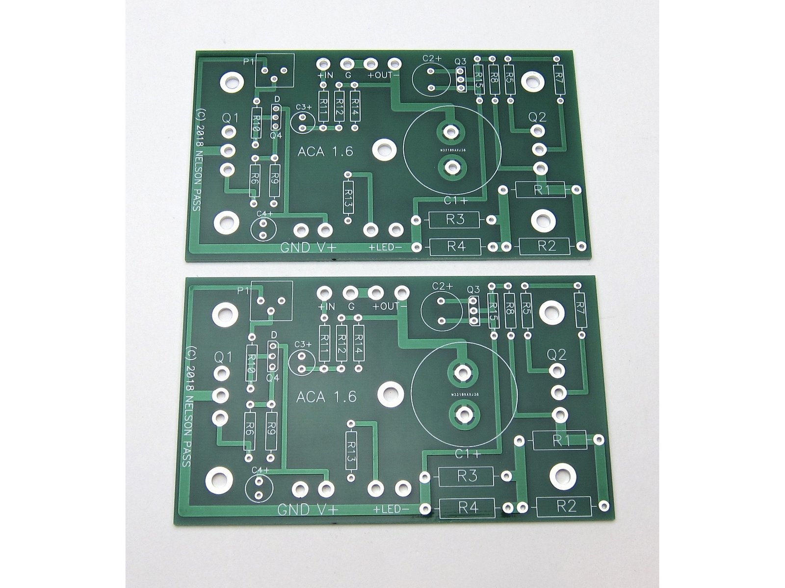

If they are these LEDs Super Bright Blue 5mm LED 3000 mcd 100 Piece Kit with Voltage Dropping Resistors
Then you need the 10kΩ resistors. Do not use the 100Ω or 470Ω ones they are for 5 volt and 12 volt supplies. They might already be on the ACA boards? They are fitted in the R13 positions. See the picture.
You might still find them too bright, order some 39kΩ ones as well.

Yes the R13 resistor on the boards is only to protect the LED from 24v. The amp works fine without it.
As Alan said, A 10k R13 resistor is probably installed on your boards already. If so you can just hook the LED to the holes marked LED on the board. If not, add a resistor to the R13 location.
The 10k is probably the minimum to protect the LED, but in the newer kits we spec a resistor around 30k because builders were complaining the LEDs were much too bright, because the newer LEDs keep getting brighter. So you might want to change the resistor if it’s 10k, to about 30k or 40k or add about a 20k to 30k resistor in-line on one of the wires of the pair to each LED. The values aren’t critical at all as long as you have at least 10k and just about any 5mm dia. LED will work.

Yup there is a resister already on r13...so ready to go with hooking up the LEDs?If they are these LEDs Super Bright Blue 5mm LED 3000 mcd 100 Piece Kit with Voltage Dropping Resistors
I will have to wheck and see what my my 3d one has as it has the LED, and it is not bright at all. I also want my Icepower amps to use the same LEDs and be the same brightness...so I will have to get some for them too.Yes the R13 resistor on the boards is only to protect the LED from 24v. The amp works fine without it.

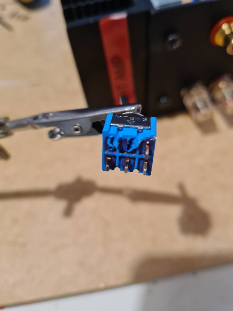

Got too hot desoldering and pulled the metal tabs out...is the switch toast now?
I ask because it appears rhe switch only uses 2 attachment points on o e side, and I do not know if that means the other side is still ok to use.
158% Dodo
Remember it’s double pole on-off-on
Be very careful soldering the on-off front panel switch it’s even easier to ruin with too much heat
I already did the front panel switch. How do I test it before I finish all the wiring?Remember it’s double pole on-off-on
I am using a Weller Wes51, and I am a beginner at this. I have not soldered before. Is there anywhere that would list what to set the dial at for various items...so I can avoid mistakes?

Since you have a 50W station, maybe aim for the 20 ~ 25W equivalent for most parts. Perhaps even a little less?
I suggest you do as I did and purchase some cheap school project 100Ohm resistors in your local electronics store (those literally made for school projects!) and the cheapest board you can get (usually just holes with no copper at all) and try soldering some resistors, get a feeling how long it takes to melt the solder, how it flows and adheres to the resistor.
I wouldn't ventrue the first heating of the iron into the final project. The risk is too high. At least it was for me. I soldered some resistors, some LEDs... cheap things that go for cents of a dollar each to get a feeling of what to expect.
"Always use the lowest temperature that will handle the load that you are soldering. The Weller® electronic control provides maximum power to the heated load even when set to the lowest temperature; therefore, there is no need to use high temperatures to handle heavy soldering loads. By using lower temperatures and properly selecting tip styles, sensitive components will be protected from heat damage".
And soldering flux is your best friend, even if using rosin core solder. Clean up with alcohol and a brush afterward. You’ll be a pro in no time!
