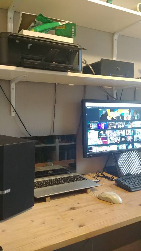

Hi. I have a question about the ACA. I soldered it together and plugged in my Soundcard and some cheap PC loudspeakers. So the sound is really silent. I can barely hear it. The output of the soundcard can drive the speakers way louder by itself. So is it normal that the ACA is, how to say, deamplifing? I don't think so😀. I resoldered everything and checked the connections. No change.
Here some information. I got the board #1b. But I build it like the 1.6 because the only difference seems to be R12, which i adjusted for 39,2K. I also connected the red terminal to the ground as seen in the build guide. The switches are missing because it only runs in stereo mod, the options arent necessary.
Here some measurements.
Output terminals.
0,03V at each terminal (red and black separated) . If I put the tip of the Voltmeter at black and red it is 0V
Channel1
Q2 S=12V D=23,8V G=17,4V
Q1 S= 6,5 mV D=11,98V G=4,6V
Channel2
Q2 S=12,6V D=23,7V G=17,2V
Q1 S=6.6mV D=11,96V G=4,62V
So I thing it is a ground problem or the capacitors are broken. Could this be? Or is there apparently something wrong with the way I build it?
Btw first project of that kind. Only build guitar effects until now and this ACA shall be a Guitar amp.
Thanks for the help and sorry for my bad english

There might be a problem with quiescent current draw.
Lets look at channel 1 first where you say there is 12v on the source of Q2 and 11.98v on the drain of Q1.
That implies only 0.02 volts is across the R1 to R4 low value network and as such no current will flowing.
Are the FET's hot or not? They should be.
There should be around 0.9 volts as measured between source of Q2 and Drain of Q1.
Check the 0.47 and 0.68 ohms are correct values and not high by a factor of 10 or 100.

Thanks. Yes it is getting hot and the values are the right ones. Meassured again and now the source of Q2 is 12,7V ..Oo maybe I didnt wait enough til termal stability. Still very silent. Should I maybe resolder everything again? 🙁
