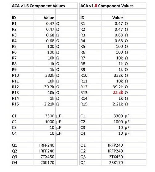

Hi friends, sorry for the amateur inquiries!
Just began to build the ACA amp and I found that I was shipped some incorrect parts. I was supplied 2x extra 332k resistors and I am missing 2x 10k resistors. I emailed the DIY store, but what is the best/fastest way to get these missing parts?
Also I soldered power resistors (2x .47 resistors and 2x .68 resistors) a bit snug to the PCB and only afterwards saw a note in the build guide to allow 1-2mm space as they get hot during use and will damage PCB. I’ve already trimmed them too short to now de/re-solder and add space. How important is this? Should I replace them?

A few options...and I am sure there are more.
You can get all the new parts from Digi-key / Mouser / Arrow etc. etc. You will likely pay more for shipping than for the parts alone unless you happen to need some other things from them. One of them will very likely have what you need.
Alternatively, depending on your location and how long it may take... my guess is that the store will ship you your missing parts. You could very nicely ask if they just might happen to have any of the 0R47 and 0R68 they could ship you along with your missing parts.
It's not hugely important to raise those resistors, but it is nice. You may as well do it the best way you can.

Just a quick sense check here.
The V1.8 kit changes the R13 resistor from 10kΩ (used in the V1.6 kit) to 33.2kΩ. Are you sure the 'extra' resistors are 332KΩ and not actually 33.2kΩ. They make the indicator LED a little less bright, nothing else.
Worth a check. Alan
Oh jeez, I think you’re right! I didn’t see the 1.8 parts list (mine came with the older list). My meter was saying 3.32 but there was an “m” before the Ω do i thought my meter was acting funny and giving me the value in mega ohms, which i thought was 332kΩ, but alas i’m off one decimal point cuz that would be 3320k LOL ... thank you for the heads up!

You need to be sure though. There are 332kΩ (they go in the R10 positions) and 33.2kΩ resistors (that go in the R13 position) in the kit. Do not mix them up.
332kΩ are Orange, Orange, Red, Orange, Black.
33.2kΩ are Orange, Orange, Red, Red, Black.
