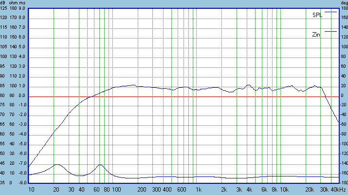

I'm new to ACA and Class A
I've been an audiophile for over 30 years but I've never used a fully Class A amp. I was wondering if I should buy one kit or go for two kits?
What would be the sonic difference between a single stereo vs. mono's?
My listening tastes and wish list is good tonal quality (a clarinet should sound like a clarinet), detail and generally good clean balanced sound.
I currently use an EL84 Sherwood amp as well as a fully restored Marantz 250M. Speakers are Zaph Audio SR71 86db sensitivity.

Your speakers, being low sensitivity, would benefit from a dual mono setup. That said I only have one ACA but I use higher sensitivity speakers, 93dB according to the mfg.
Zaph Audio SR71
Pretty flat impedance, bridged will be fine. You might have to damp the bass a bit.
Note that the Z scale has 10Ω graticules.

I am currently going through the process of evaluating the various set up options of amp(s) and that's part of the fun really of having 2 amps. If you only build one you will never know yourself.
Also there are economies of scale when ordering parts and cases for 2 amps at the same time. If you are ok sourcing components and sockets etc yourself from the likes of digikey or mouser it is just as easy to order for 2 amps. Likewise if you order cases directly from modushop there is usually a price break for buying 2 plus shipping is the same for one or two. This is the first time I have ever had monoblock amps and I am starting to feel like a proper audiophile!!

Hey Sunscreen, I use one ACA with the SR71's in my bedroom driven by a nu-tube preamp. Sound is wonderful, but this system is not played loud, the room is small and I am close to the speakers. Two ACA's would really work well with this speaker, but one will also work.
My system would be quite similar. It's a 12x13 bedroom and I'd be listening at levels around 45-55db max.
