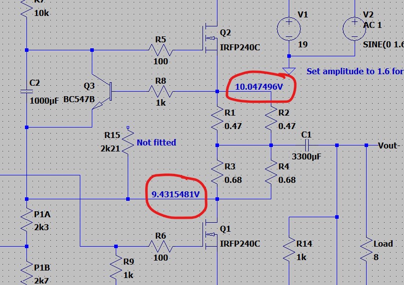

so how can i set the current down lets say 1,2A or so. how is this to calculate?

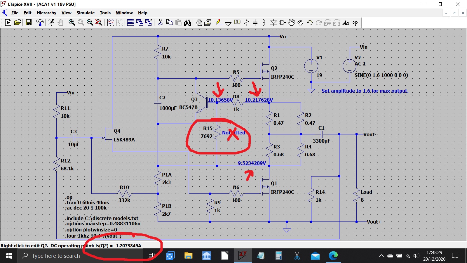

The current is set by the operating point of Q3. When sufficient voltage is developed between the base and emitter (so about 600 to 700mv) the transistor turns on and limits the current.
What current do you get with R15 removed?
Here there is approx 600mv between B and E and the current limits at just over 1 amp
Increasing the value of the 0.47 and 0.68 ohm resistors would develop more volt drop and so allow even lower currents.
R15 and R8 simply form a divider across this already low voltage and allow setting of the current to values higher than the default of no R15 fitted.
So if you can't go low enough with R15 removed then you need to increase the 0.47 and 0.68 ohms a little, say to 0.68 and 0.82 ohm.

And you want around 1.2A?
Something around 8k2 for R15 should achieve that but what you could do is fit a preset and tweak to get exactly what you want, then remove and measure and fit a fixed value in its place.
It is not an exact science to calculate because we do not know exactly what Vbe voltage your Q3 needs but we can come pretty close.
Assume 600 millivolts for Vbe.
The combined effective value of all those series and parallel 0.47 and 0.68 ohms is 0.565 ohms.
A current of 1.2 A would develop V=I*R which is 1.2*0.565 giving 0.678 volts.
We need 600 millivolts and so we need a divider across that combined resistor chain of......
We ignore the base current as it is tiny...
We know R8 = 1k and so we must 'loose' 78 millivolts across R8
That is 0.678V - 0.6V (the voltage across the resistors minus our wanted 600 millivolts)
The current in R8 will be I=V/R so 0.078/1000 which is 0.078 milliamps or 78 microamps.
We know that the remainder of the voltage will have to be developed across R15 which is the value we now calculate.
R=V/I which gives 0.6/78E-6 giving 7692 ohms.
Lets try that in the simulation and see what we get... and its pretty close. It is the voltage Vbe of Q3 that is open to variation in the calculation.

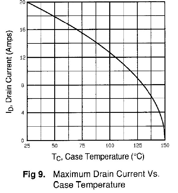

Heat is very subjective and the FET's will be happy at temperatures far above what your fingers will take.
A very good rule of thumb is that if the actual leads coming out the FET will sizzle a drop of water then imo it really is running to hot for comfort but even that is well within acceptable limits.
It is true the amp runs cooler the harder you push it but for normal music and its average value being low I suspect that will not make a huge difference 😉
This is from a data sheet and shows allowable current vs temperature for the FET's.

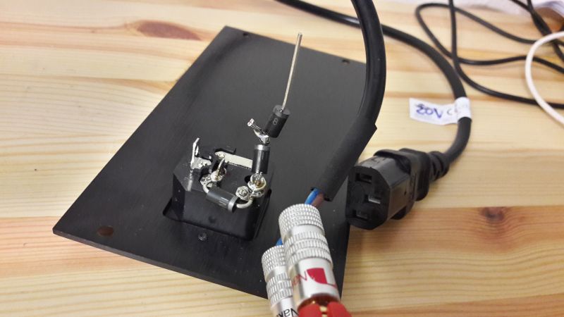

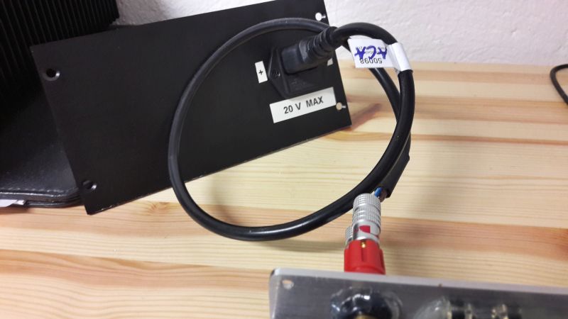

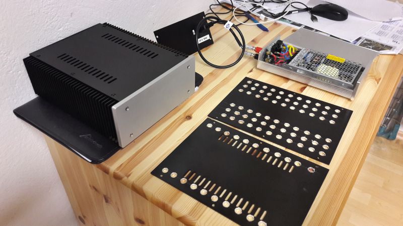

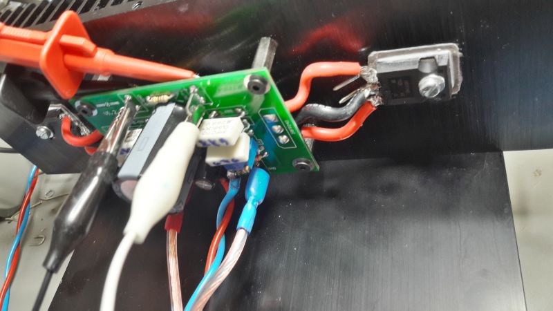

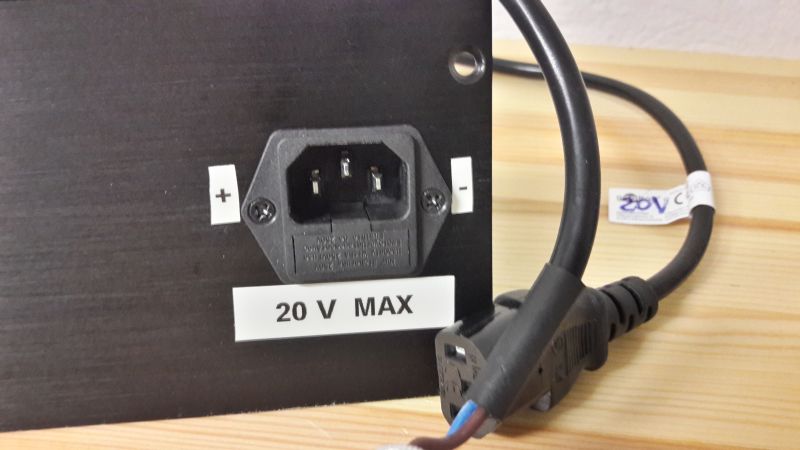

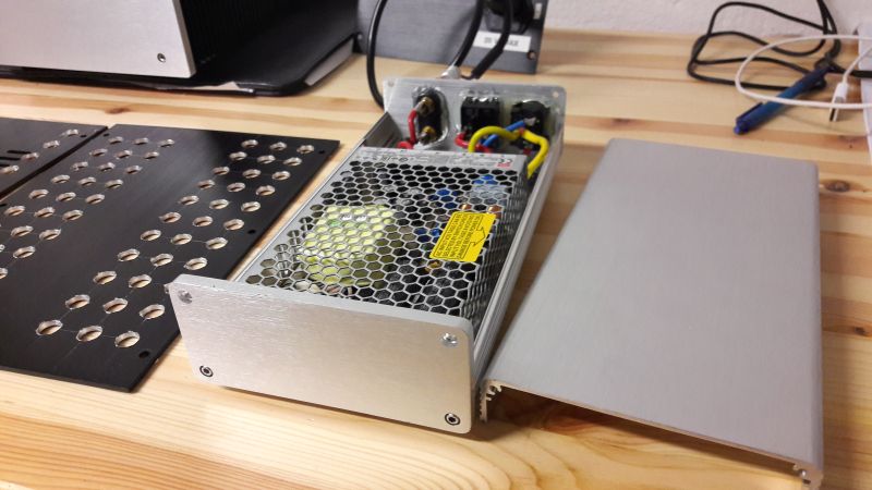

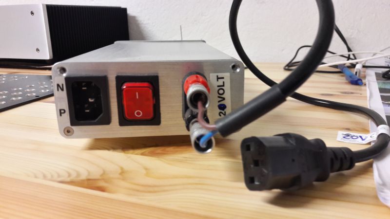

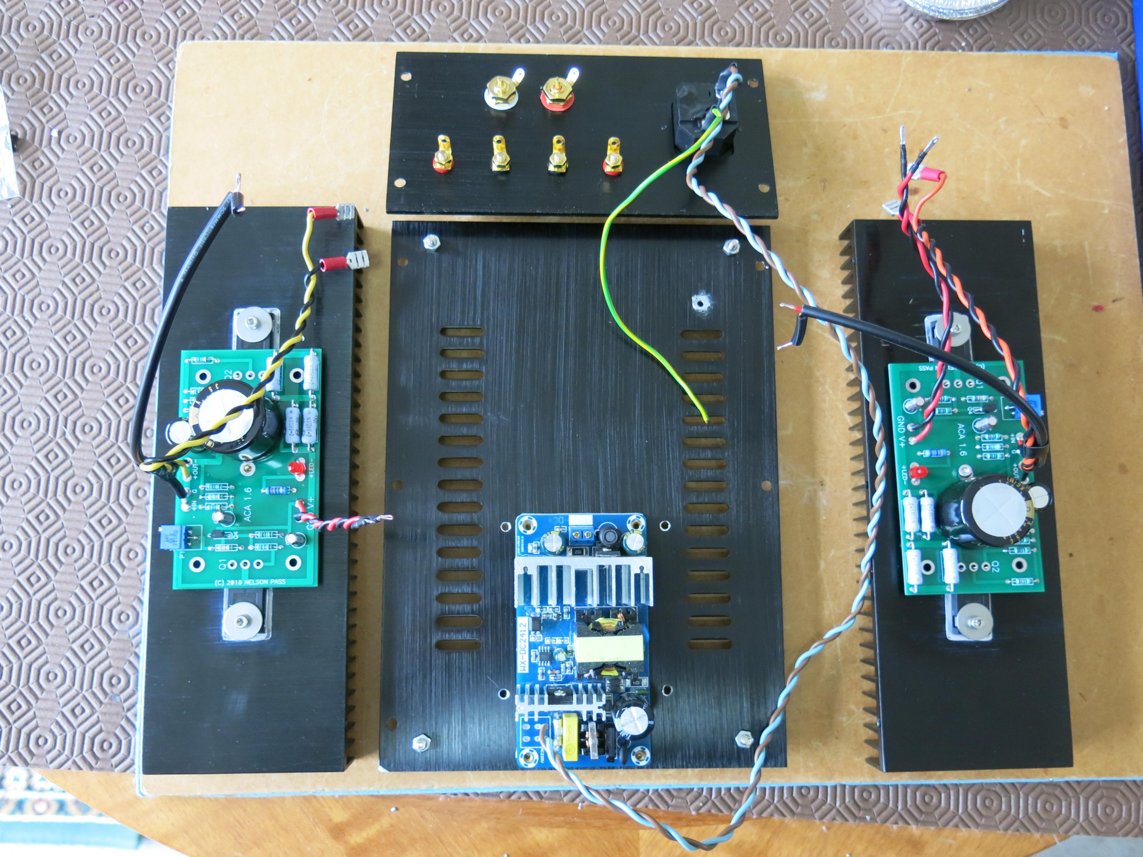

Here are some pics from my today's work
new pcb mounted to housing heat sink
smps + connection to amp + power cable
upper and lower plate drilling 🙂
protection diode and 2 diode for voltage wasting...i will see if i need them or not

Looking good 🙂
I'm not convinced on the diodes tbh. Here's why...
Lets say you have 1.2A flowing and the FET's are biased to the midpoint (the midpoint exact value doesn't matter, it just makes the calculation easer. The total dissipation of the output pair is the same whether set at 9v, 3v or 15v)
So 9v @ 1.2A is 11.4 watt per device. Total 22.8 watt.
Now with the supply at 17.5 volt (two diode drops less) and with the current the same we get 10.5 watt per device, total 21 watt. Very little difference. Also the diodes now dissipate that 'lost' heat, all you have done is change the location of the heat generated.
You can achieve the same reduction by reducing the standing current and yet keep the full available voltage swing. Only when the load impedance of the speaker happens to be low and the swing high would you see limiting occur that bit earlier due to the lower current.
Remember that most speakers have their impedance way over the nominal 4 or 8 ohm value for much of the mid and upper frequencies and so would draw less current there in any case.

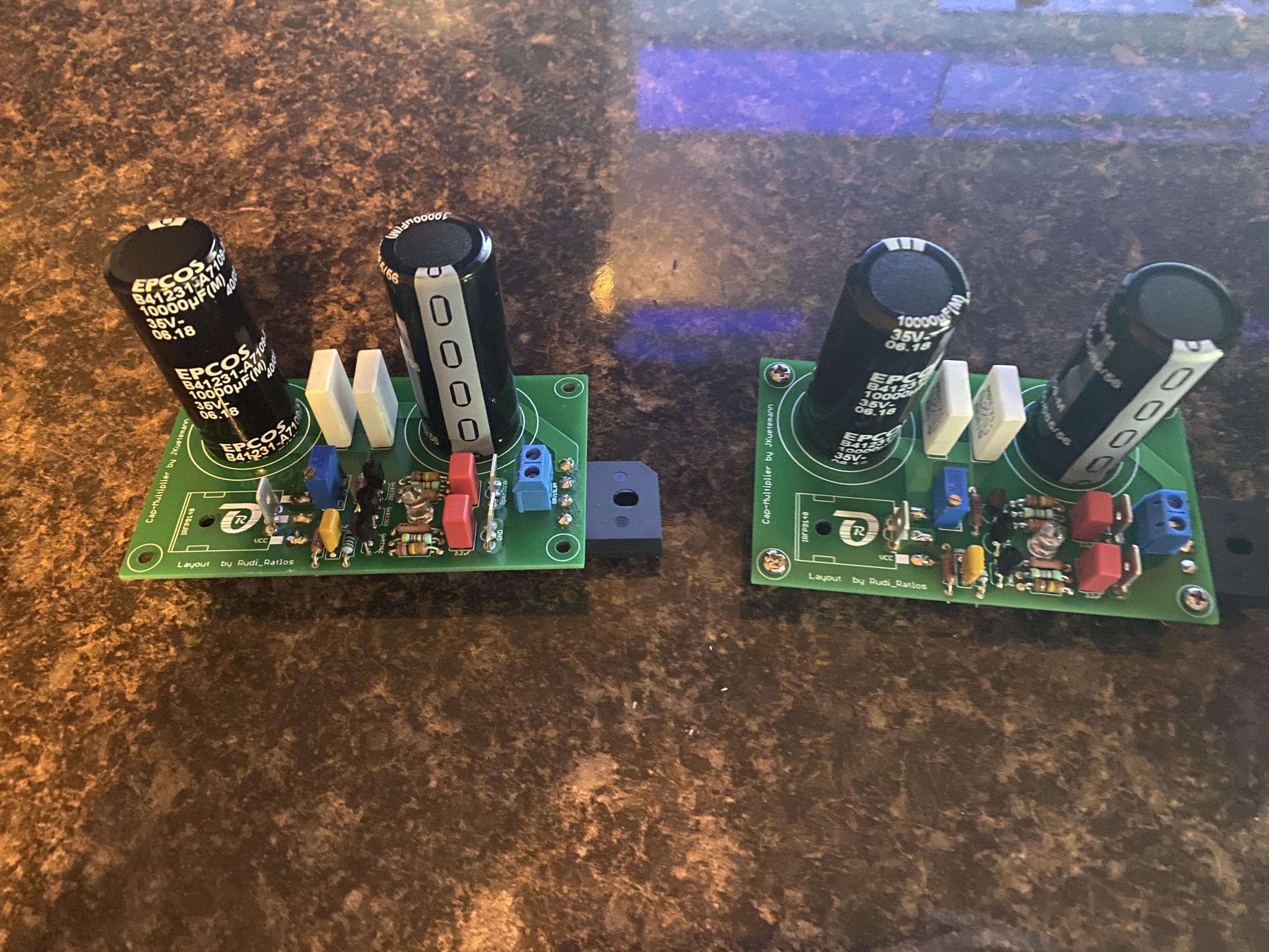

Hoping to get some feedback on building a large external power supply to power two amp camps (4 total boards). I plan to use:
- Pesantue 2u chassis
- 4 of Jason Keutemann’s CapMX Power supply boards (one for each channel)
- 2 AS-2222 transformers
- each amp will have it’s own umbilical cord with 3 pin input
- ground will be shared for each amp and each board will receive its own 25-27V power (voltage sags on the CapMX quite a bit).
I’ve built all in one amps with the CapMX power supply boards and transformers with the amp camps but wanting to try a separate power supply.

I attached a pic of two of the power supplies.
Are there any tips or foreseen problems I may have building a large external chassis like this?
- Amp Camp Amp - ACA
