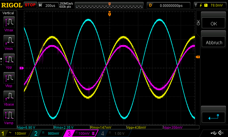

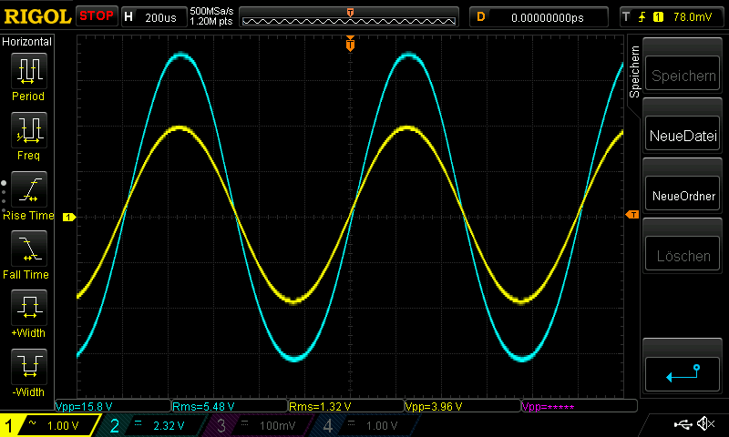

This is very strange then.
Can we go back to basics and revisit post #9254 and those scope shots.
No need to post pictures but can you confirm (and this time use just one channel on the scope for both measurements) that you really are seeing around 5.5 volts rms output for just 420mv rms input.

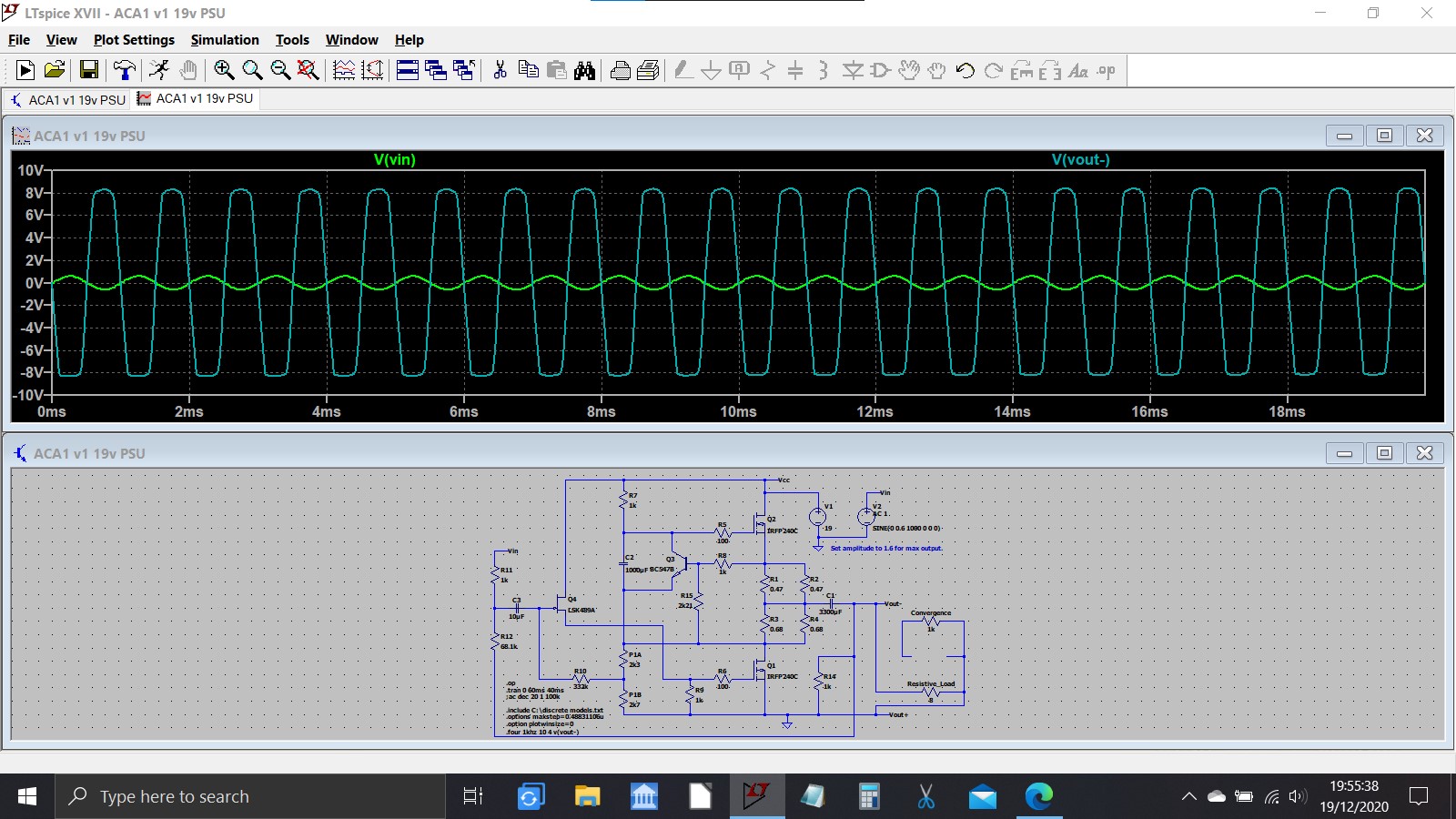

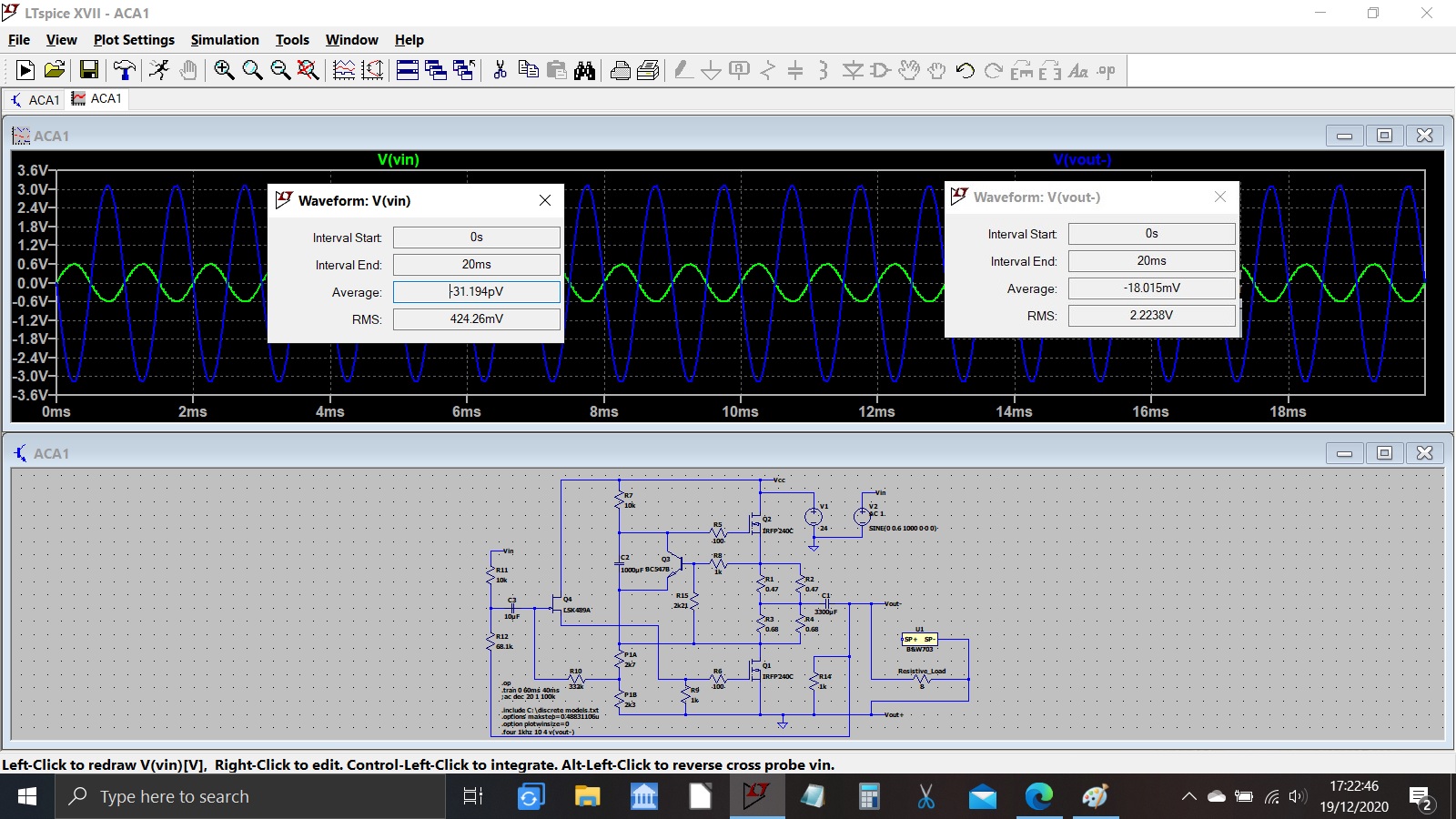

I've set that up in the simulation we have for this amp to show you what you should get. This is using the 68.1k and 10k gain set networks of the earlier version you have.
Removing the 8 ohm load should show only a very small increase in output.

Hi to all
thanks for your help but i found it...shame on me...🙄
Mooly reminds me at the bad feedback network and i looked with channel 3 after the 68k resistor and found nearly the same input signal. that made me crazy! --> finally i found my mistake. i sort after measuring the resistors in the wrong box and then i soldered it...no recheck again.🙄🙄🙄
so i used at R11 input and R7 instead of a 10k resistor a 1k resistor !!!
now the amp is working fine gain about 4,6 and the max power is about 3,75Watt with the supply 19V and the set of 10,2V.

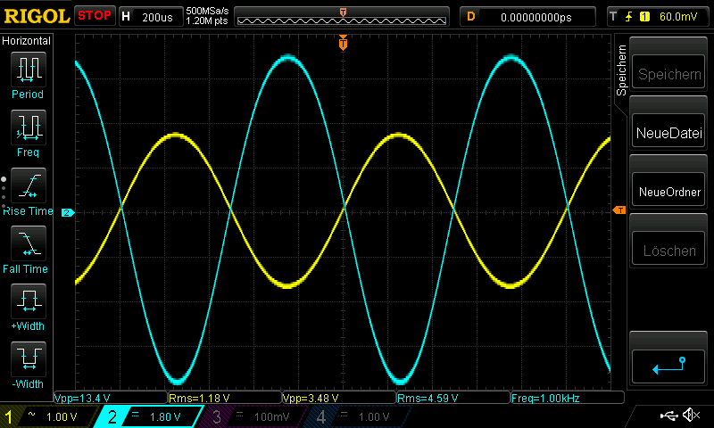

pic 1 19Vsupply_set at 10V 8R load 1khz sine in 200mVrms_gain 4,57
pic 2 max power 19Vsupply_set at 10V 8R load 1khz sine in 1320mVrms_gain 4,57_power about 3,75Watt
pic 3 is the 3 channel after the feedback resistor before input cap.

Putting those values into the simulation gives your original fault 😉

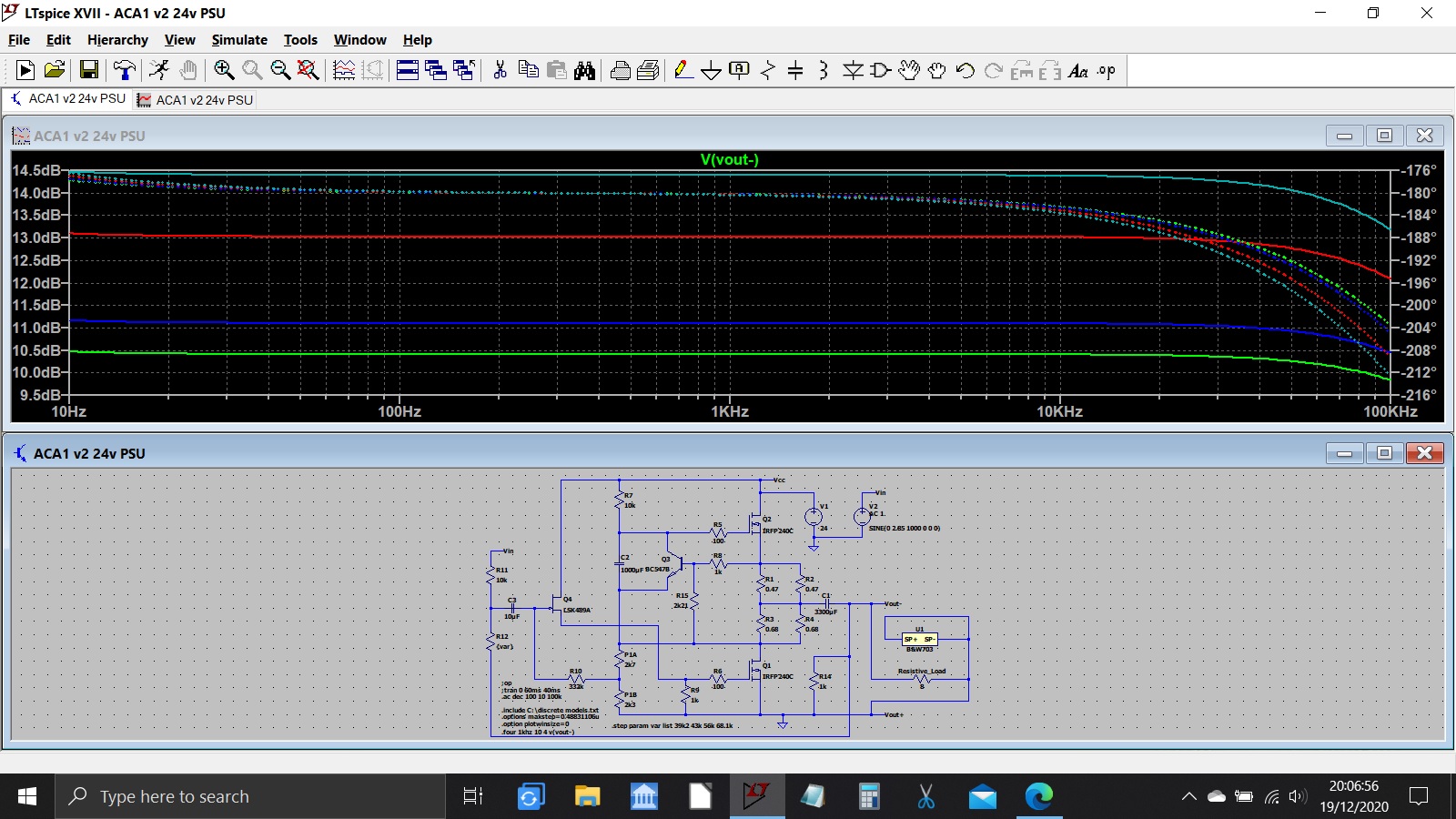

Hi Mooly
thanks for the LT spice simulations.
i just add this R15 on my board and checked my supply what i want to use. is a single supply with 24V but real 23,88V under load its stable with 23,87V.
here:
AC 85 265V to DC 12V 24V 6A 100W Switching Power Supply Board Power Supply Module|Switching Power Supply| - AliExpress
i tested it with some 20mF caps no hick up or other strange things during starting...
with just adding the R15 and keep the 68k Rf and 4 ohm load i get a gain of 4.
i try with max input voltage = 1,2vrms to set the point where is in the middle.
i adjust in the middle 11,94V
see pic1
the problem is the lab supply is set to 23,88 and it push 1,54A inside the amp and i get very fast about 76°C on each IRFP240 !!
is that too much?! do i have to use 39k at Rf?
thx
