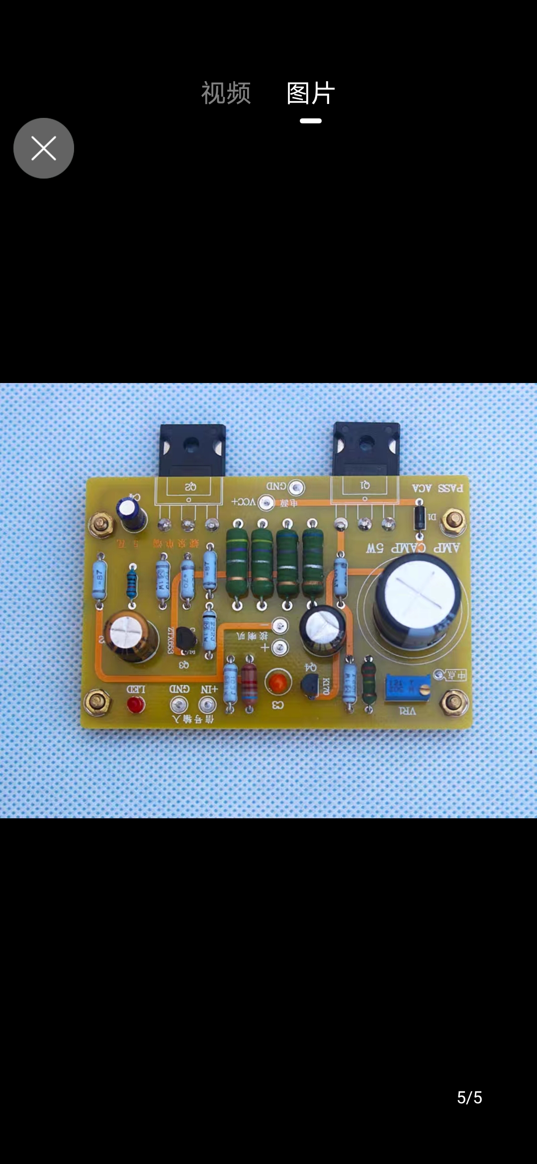

That board design lends itself well to the modifications that I like for the ACA.
I missed the latest R changes but love the results of the input/feedback and cap mods. Many thanks for sharing your results.

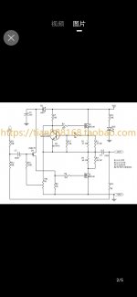

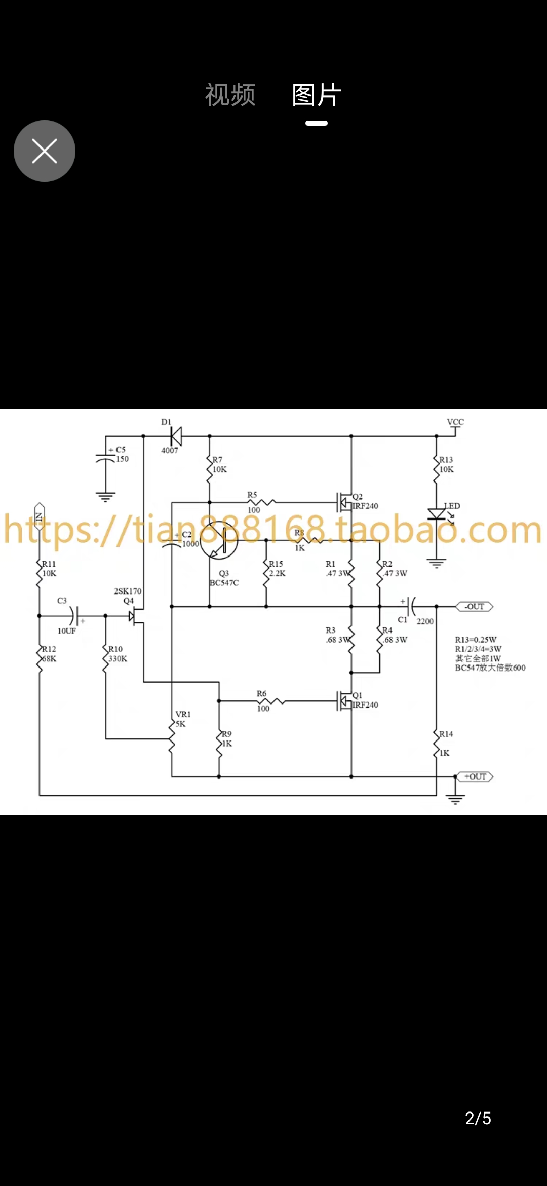

The latest R change of r5 and r6 which value 100 change to 121 , what is the purpose of this change?
