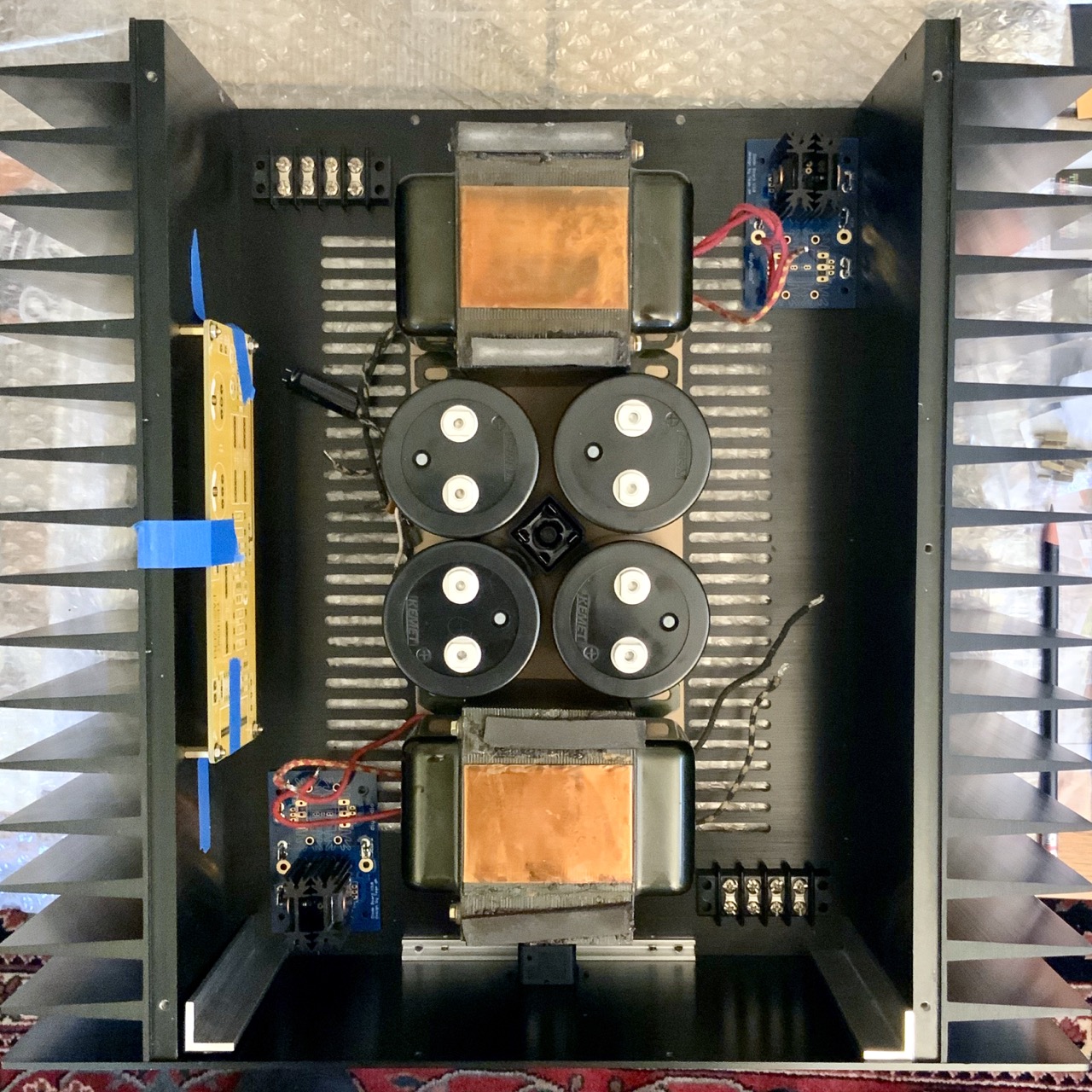

Then I went on to build other First Watt clones, but not before making a pair of larger ACAs using higher voltage linear PSUs and the old Hafler DH-220 chassis. I never tried connecting those as monoblocks, because one has a different set of Mosfets – the IRFP140. Check out ACA amp with premium parts. The development went on from there.
The ACA had been a wonderful gateway, as it was intended. I went on to build an M2x, Aleph J and F6. They all sound great in their own way. After building the M2x with a shared PSU, the others were built with dual-mono supplies. The F6 is the most heavily modified of the trio; the Aleph J was just given a really good set of PSUs.
Now I'm working on an enhanced version of the original "Penultimate" Zen V4, the amp which I regard as parental lineage for the ACA. See where the old Hafler transformers are going to be put to good use.
