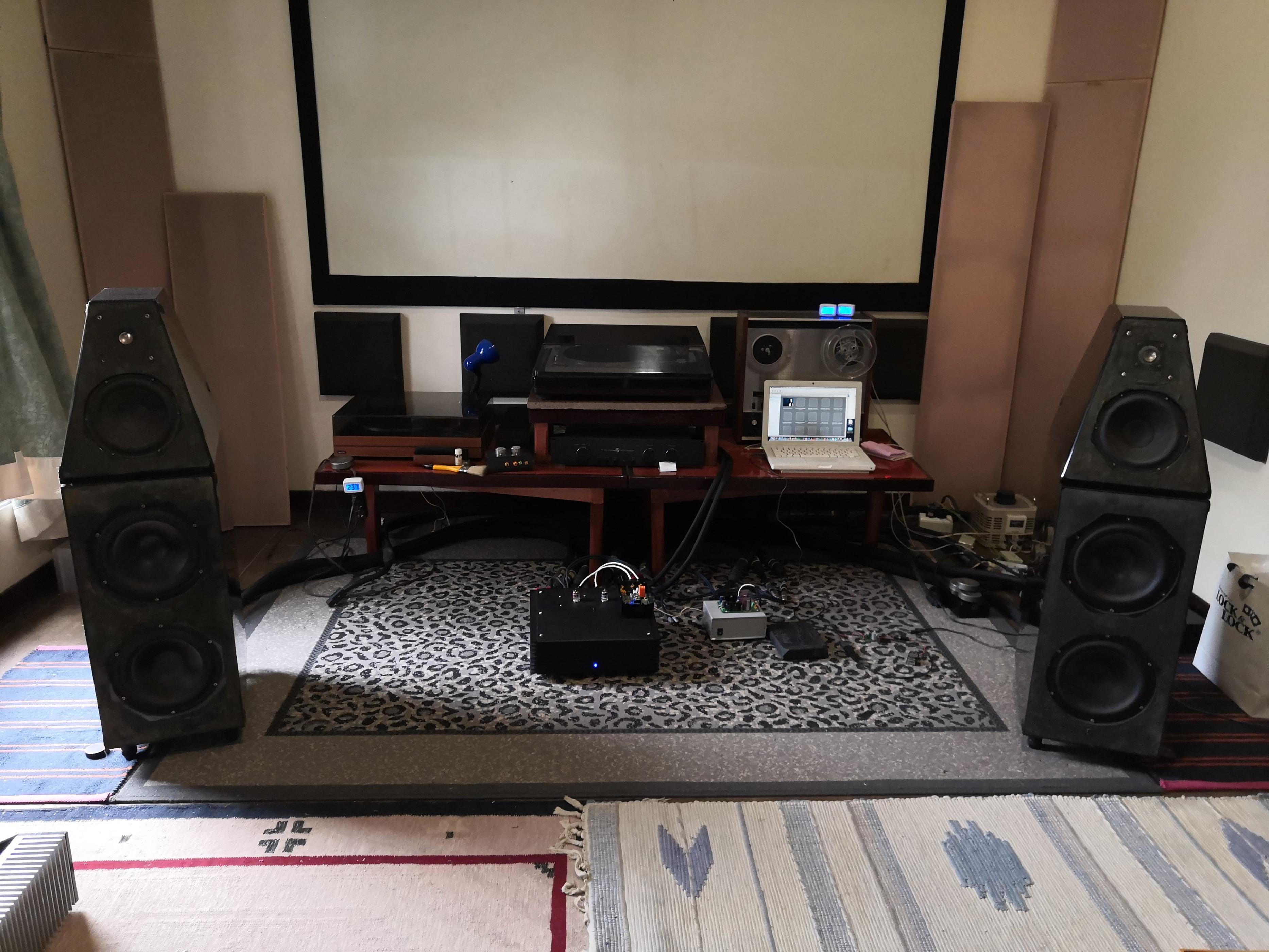

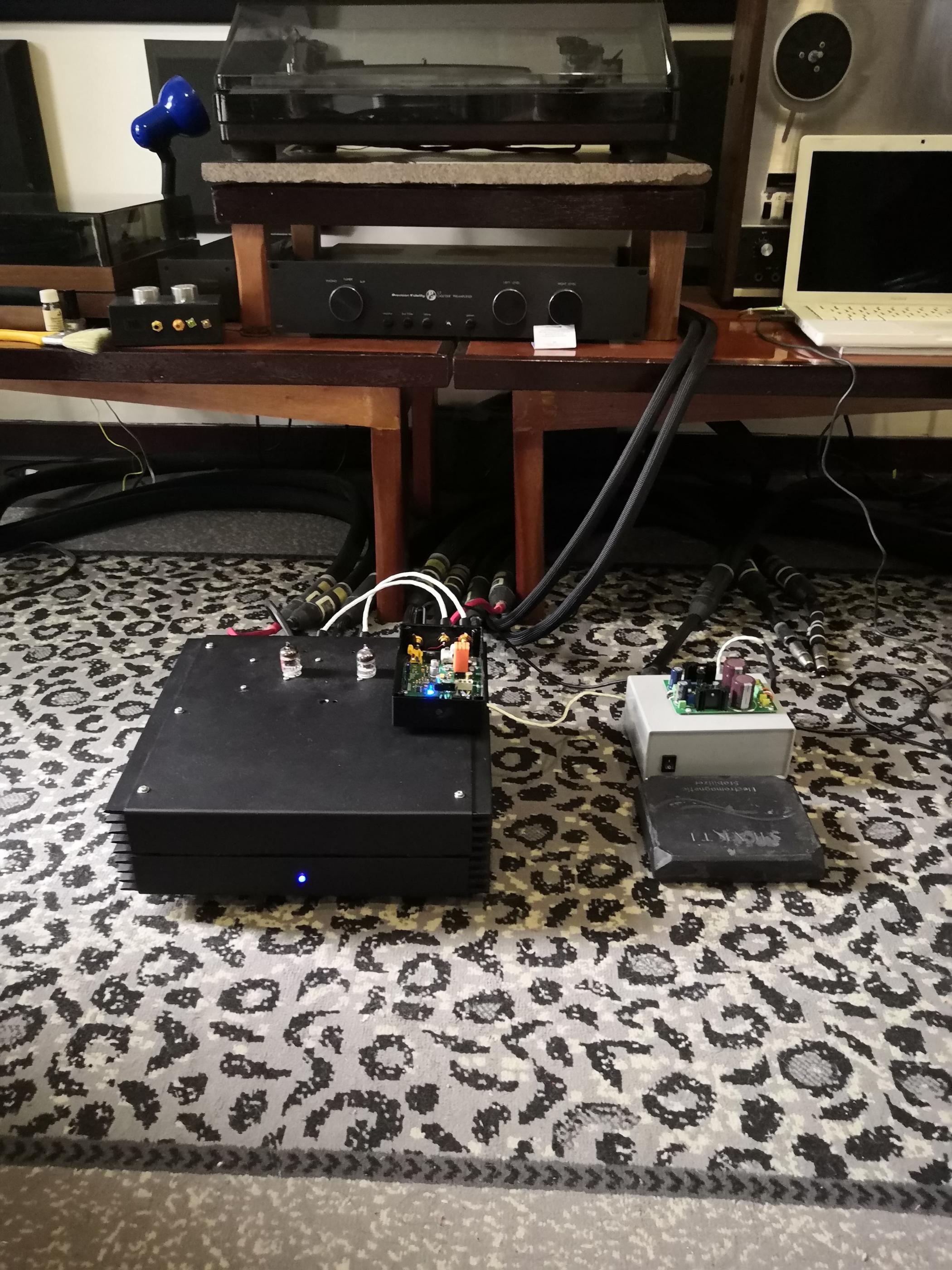

i have a bridged ACA drive Wilson watt puppies, and sounded magnificently.....
highs shimmered, bass was tight and controlled, realistic....
