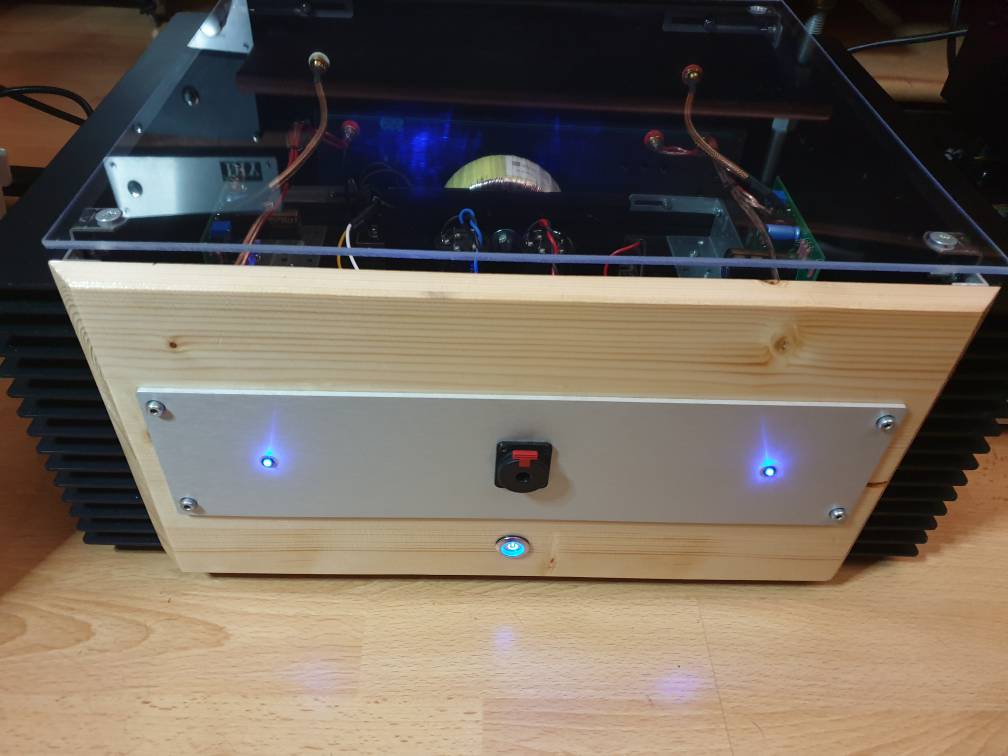

how to convert from speaker output to 3.5mm
Very easy, just wire your amp output to the 3.5 mm socket, L to L, R to R, common ground.
Mount the socket on the front panel for convenience.
Or if you don't want to spoil the look of the amp keep the socket at the back.
Just do not connect speakers to the posts.
You'll find wiring diagrams all over the net.
I would recommend wiring a 6.5 mm socket with a lock, like this one:

Just make yourself a 3-wire fly lead from the speaker output to the socket (loose) and try your HD 650.
If you like the result make the change more permanent.
Or if you are like me use it that way for as long as you can.
Nothing's more permanent than the temporary measures.

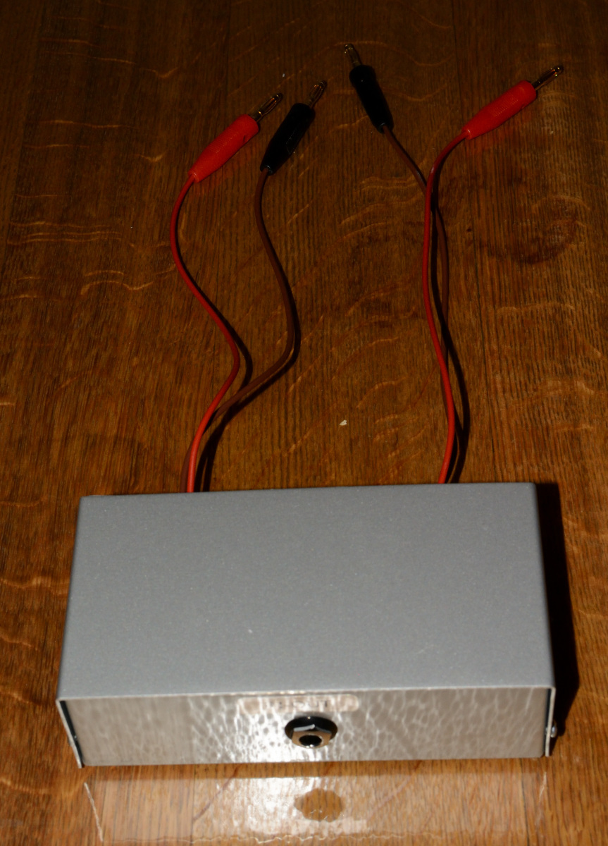

It might be a box like this you what. It interfaces from banan speaker plug to stereo female jack. Inside the box is a 8 ohm load resistor pr. channel to ensure proper load of amp (original made for tube amp) and across 8 ohm load resistors a voltage divider is made which reduces the signal so it fits to headphones. Also it protects a bit in case of short circuit....

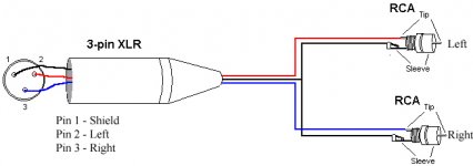

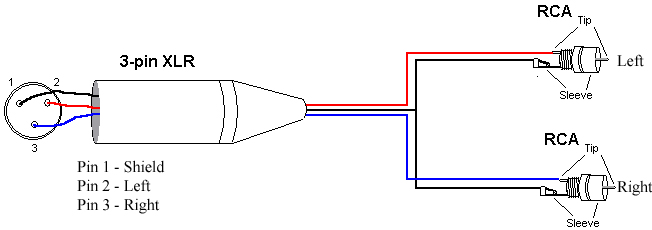

Hi, I am building two aca and would like to run stereo thru them using the XLR input. They will both be in a single enclosure. I am confused about mirrored pairs and making sure the phase is correct. Is wiring each as a monoblock the right move? Would someone point me to a post or help me understand how to wire two aca as a stereo pair, please.
XLR:
pin 1 ground
pin 2 positive
pin 3 negative
so for example you can do:
pin 1 common ground to both channels
pin 2 Left
pin 3 Right
look here:
How to Wire an XLR to Two RCA Connectors
I'm sure other members will come up with different and likely better suggestions.
AFAIK, if you stick to the building guide, you will have your ACAs prepared for monoblock (bridged) operation —one left channel, the other unit the right channel?
Confusing answer.
The question was running stereo ACA with the XLR connector as input to both channels, Left and Right.
Otherwise you are right, the guide covers the option.

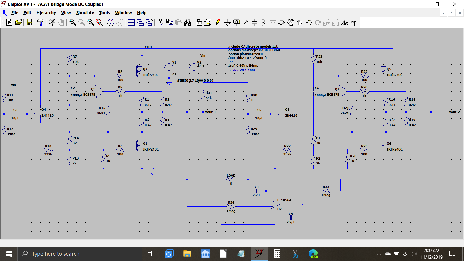

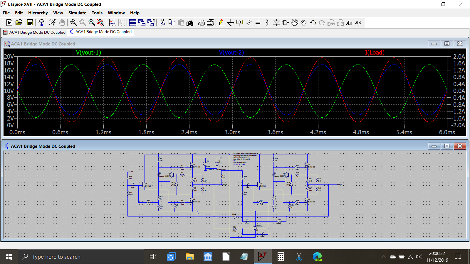

Hi.We want to make bridged ACA amplifier with RCA input to eliminate output capacitors.(4 ACA board in one case but not balanced amp,RCA input.May also build B1 buffer inside of amp)My friend told that we can not make a DC protect circuit to protect speakers.We want to make a delay circuit when start up and save speakers for any DC if one block of amplifier damaged.Is it not possible?
Would be anyone sharing experience of comparing ACA and other amp and the speaker been using in comparison.
Thanks, but I am looking for the monoblock wiring details for each channel. Each channel is a monoblock.
It may be possible. You could use an opamp as a type of servo. This would sample the DC voltage at the output of amp 1 and then using that as a reference bias amp 2 to achieve the exact same DC output conditions.
Two resistors and two caps plus one opamp.
The problem (imo) with bridging the ACA is that because the output impedance is so high, the load affects the absolute output voltage of 'amp 1' and then we use that altered voltage as the input to amp 2.
I think it would be better to do the phase splitting at the inputs using an opamp... however 🙂
