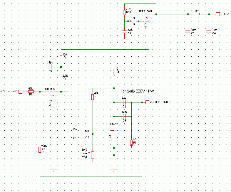

Are you think of this sort of unit?
De-Lite Amplifier - diyAudio
Close but, not exactly, see attachments below.
De-lite uses a completely different, depletion mode MosFet.
As for light bulbs in Oz try this:
Linear Globes available from Bunnings Warehouse
Linear Halogen Lights, Light Bulbs & Globes | LightOnline
Have fun.
