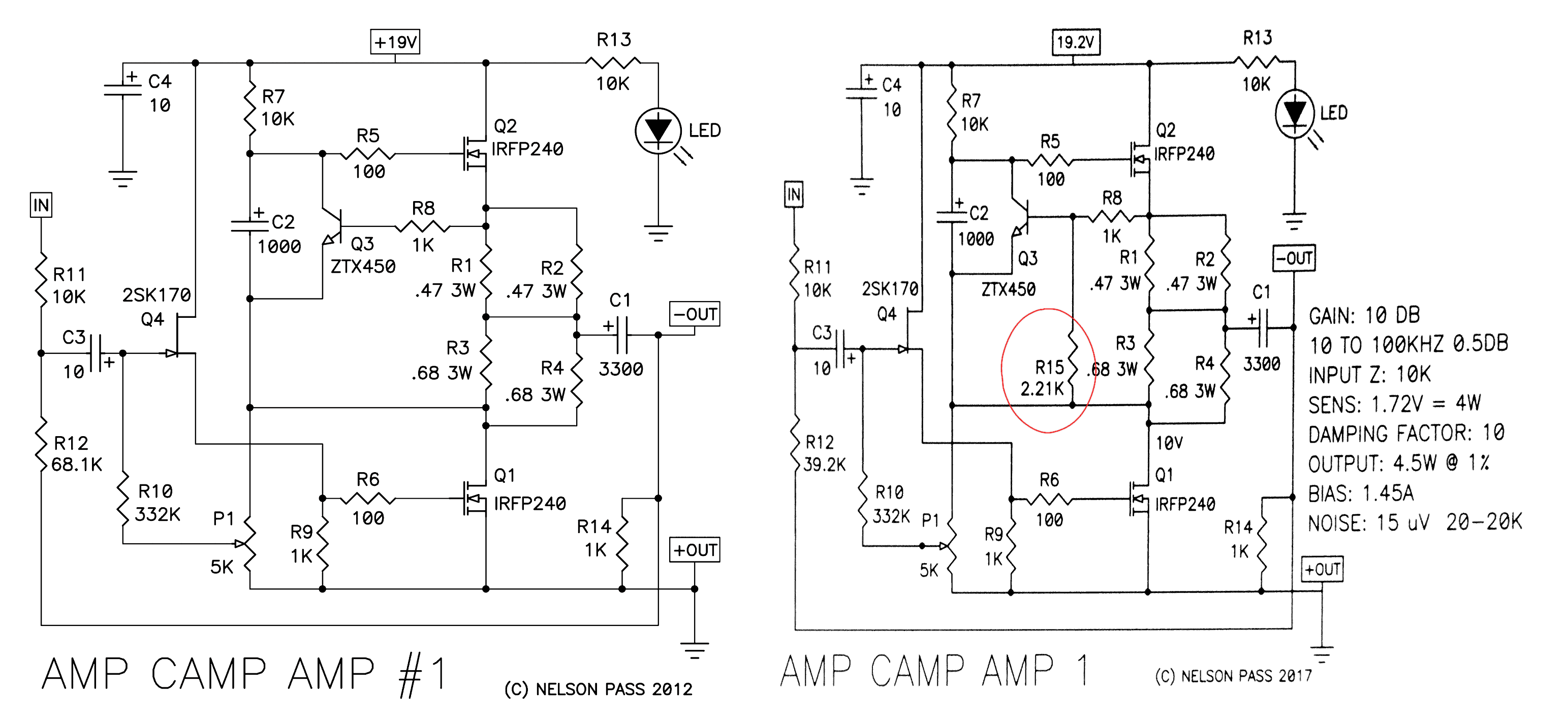

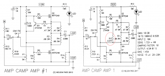

Converting from five wants 19 V to 24 V 8 W
Can’t one just substitute a 24V PS in the old one and get 8w?
I have been scheming to add a 24v analog supply to the original monoBloks. And something to make the 2 amp chassis a single one.
dave
I was looking for the information so I could copy and paste the link it’s in one of the amp camp amp build guides. Depending what version PCB you have 1.0 and then the later 1.1b
On the early version I remember seeing a picture of doing a jumper with a resistor that you add I’m trying to remember if it mentioned resistor placement on the later version R12 and this is going from a bad memory.
Which it sounds like you have the earlier version PCB because when I purchased the later version the circuitboard had the place for the resistor to be mounted.
Go search back into earlier build guides and I remember seeing the modification photo on how to do it I’m very sure somebody knows exactly what I’m talking about and I’ll provide a link in the next post.
frugal-phile™
Joined 2001
It looks like it would be simple enuff where to jumper a 2.2k r onto the old boards.

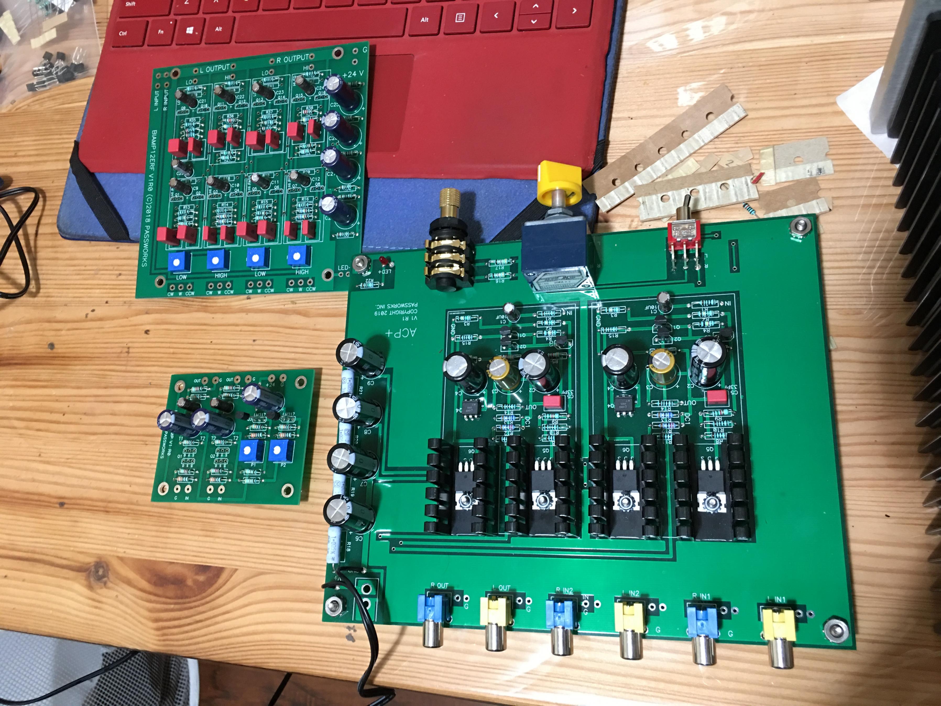

Get a pair of higher efficiency speakers full range 96-98 Or higher, run the ACP+ It is CLASS A. It already has a warm sound to. If you wanted to be anymore gooey like, Maybe adding the H2.
For all of us who were at Burning Amp This year we got to hear what that one WATT can do with those large 15 inch speakers I think it’ll be more than enough for near field. And I guess if somebody can chime in you had to have two way speakers you could get a very high efficiency Twitter and add in the LX mini instead of a crossover so you don’t eat up any power.
PS. You may have to add a resistor, talk to somebody with some experience to match your speaker to the ACP+ it likes 32 ohms or was it 38 ohms
