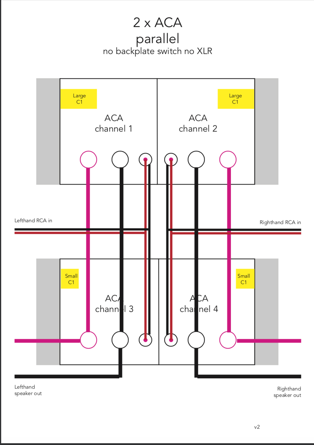

If you are sure the Black terminals are connected to the GND / 0 volt line then they will all be connected together through the power supply leads, so no output...
So the 'Parallel v2' scheme cannot work.
V3 is what you would need to do. I have left a wire between 2 of the black terminals to bond the 0 v / GND of both ACAs together.

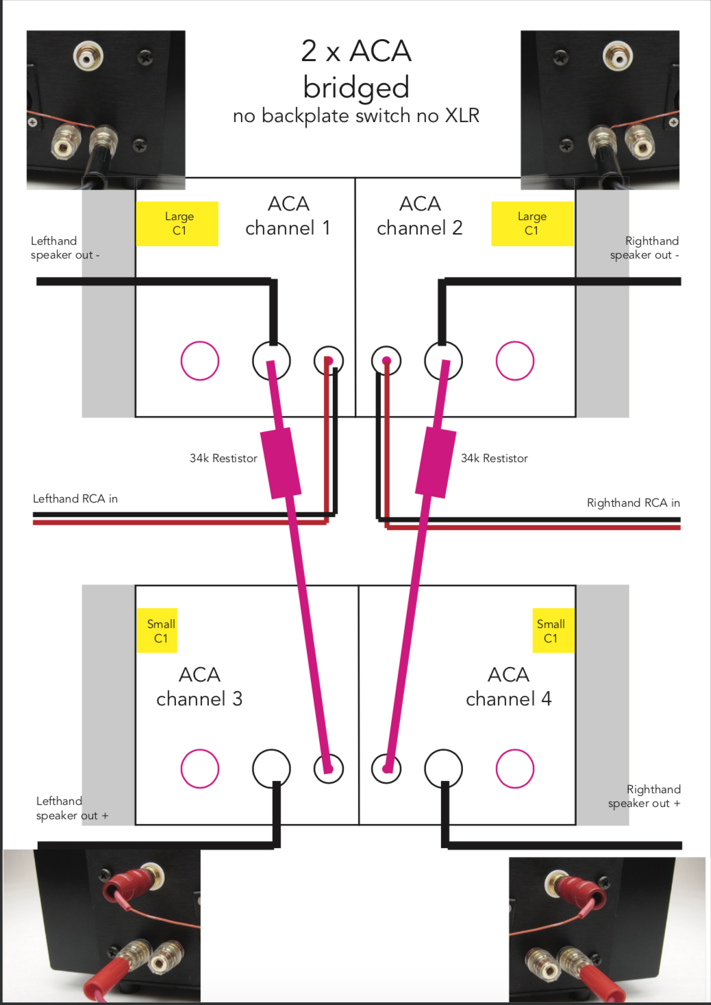

Looking into this a bit more I see something I hadn't appreciated before the ACA now sold and referred in the build guides using the diyaudio chassis has one power supply which is used to power both channels. got my act's from the diyaudio shop with the heatsinks and all parts and at that time those parts included power switches and power sockets to run with one power supply per channel so from day one the two channels have been completely isolated from each other with no common ground. which also accounts for the annoying fact that my input and output does not match that's shown in the build guide!
I don't want to resolver the caps or other option in and out terminals/sockets wiring vertically to avoid this is exactly the same as horizontal I realise now as I have in effect four completely independent amplifiers there are no grounds or power supply shared between them at the moment.
if running parallel is a matter of linking all inputs and outputs, is that's right? then I am thinking that v2 of the layout will work? and also the v2 brides should work as is.
Im going away now to think it through again. thanks for all the insight so far

Now I understand where you are!
Yes the first kit (which you have) does have different instructions too, no wonder we had (literally) crossed wires!
The parallel picture v2 you posted is correct.
The bridged picture now needs a little clarification to be sure.
If you do a simple continuity test (use the 2k range) from the outer ring of the RCA connector (which is GND) to the Black output terminal and the reading is 800 - 1000 ohms then your picture is correct. If it is zero ohms then move everything to the Red terminals.
Either way you will have to common the GND lines of the pair you make into monoblocks. Easiest is to link the terminals, that measure zero ohms in the above test, together.
Hope that makes sense???
