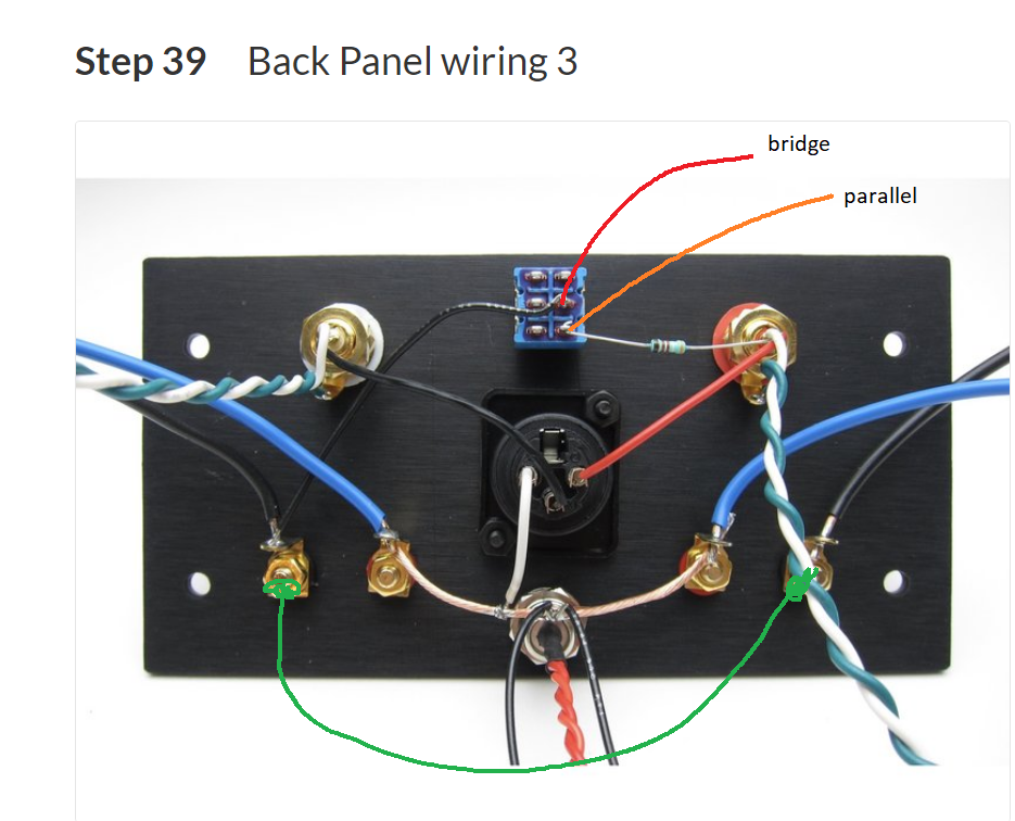

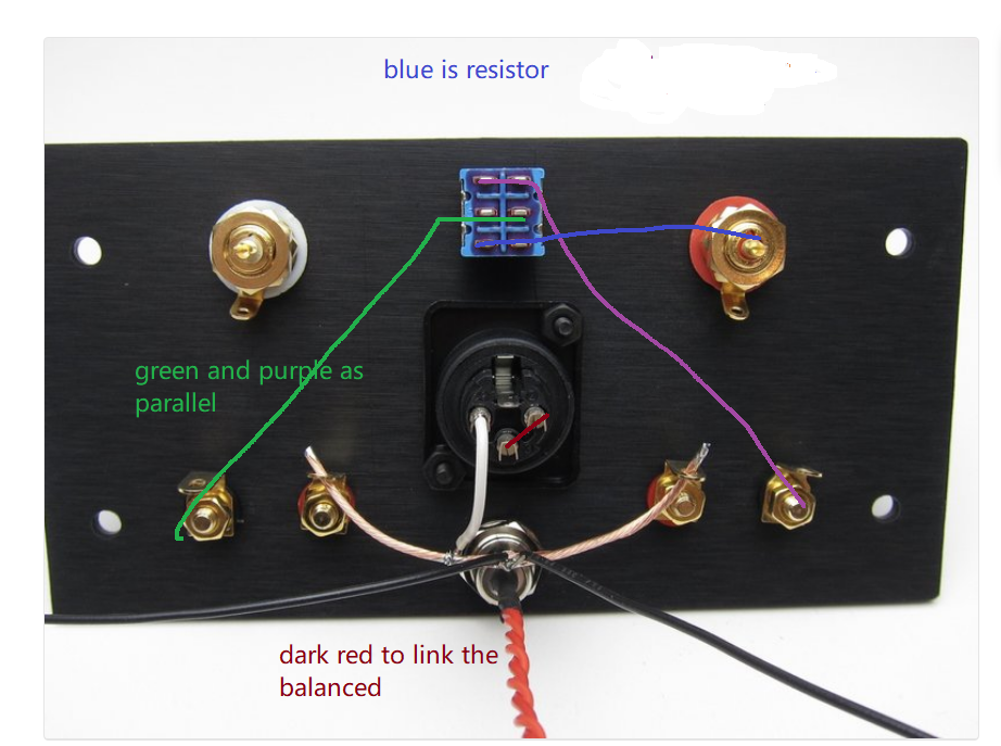

It will not. You have omitted the switch' other (available) contact, and wired the ACA outputs permanently for the parallel mode of operation.
Parallel:
- inputs are paralleled by means of the little XLR connector that I plugged at the back
- outputs (negatives) are paralleled by means of the switch shorting the middle pins (one ACA module output), and the top pins (the other ACA module output).
Output can be taken of any (all) posts
Bridged:
- the switch will have to short the middle pins and the bottom pins (by doing this, it will also disconnect the outputs' parallel connection)
- you can wire the speakers now between two negative posts (two outputs).
Bridged:
Parallel:
Bridged:
is this correct? im new to diy.
thanks for the help anyway.
The lines you added on the computer are a bit confusing. Can you show the photo without the extra lines?
sure, no problem🙂

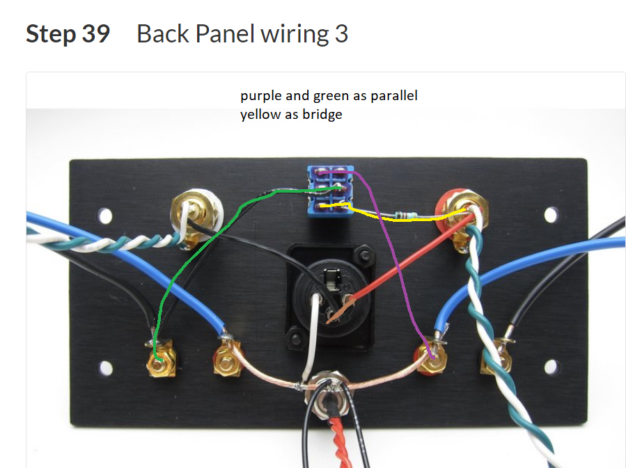

parallel: the purple wire should go from the top switch contacts to the other negative. the RCA middle pins should be shorted as well.
bridged: yellow wire not required
sure, no problem🙂
everything is follow the step 39 except this, am i right?
the yellow(blue in the photo) should be the resistor,
what do u mean by shorted rca?
in this case, is it balance cable no longer needed as the + - already link together (dark red)

i see, what if i maintain the original switch and without using stereo?
like, switch up bridge and switch down parallel. but xlr will not be functioning (as the + - is linked). is it like that?
im totally new thats why i hope that i can maintain with all the original parts.
Yes it will work just as you say.
Up = Bridged (via RCA) mode.
Down = Parallel mode.
The only question is the quality of the original switch contacts for the parallel speaker connection. No harm in trying it though.

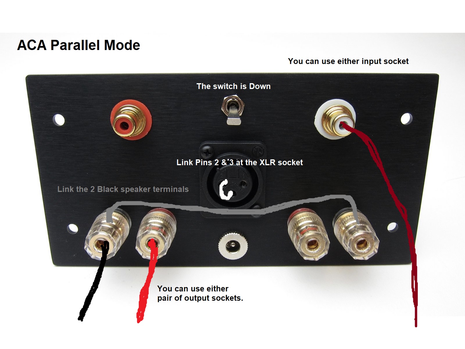

Now I understand where you are!
Yes the first kit (which you have) does have different instructions too, no wonder we had (literally) crossed wires!
The parallel picture v2 you posted is correct.
The bridged picture now needs a little clarification to be sure.
If you do a simple continuity test (use the 2k range) from the outer ring of the RCA connector (which is GND) to the Black output terminal and the reading is 800 - 1000 ohms then your picture is correct. If it is zero ohms then move everything to the Red terminals.
Either way you will have to common the GND lines of the pair you make into monoblocks. Easiest is to link the terminals, that measure zero ohms in the above test, together.
Hope that makes sense???
Hi thanks ill do that's and yes I had not relied the differences before so ill go forward and test as I go!!
... if i maintain all the ori parts ,
up for bridge mono - down for xlr and stereo, ( to become parallel, joint the -ve speaker output)
therefore for down mode, , there is only 2 option. which is (xlr and stereo) or parallel.
am i right?
If you keep the original parts and wire it as in the Build Guide,
The switch Up = only for Bridged mode (RCA input) see Step 55.
The switch Down = Stereo amplifier or XLR input and
For Parallel mode the switch has to be Down, join the two Black speaker connections and the Red and White RCA inputs. This is easiest if you link pins 2 and 3 of the XLR socket. (Make a 'U' from a paper clip or suitable stiff wire.)
Alan

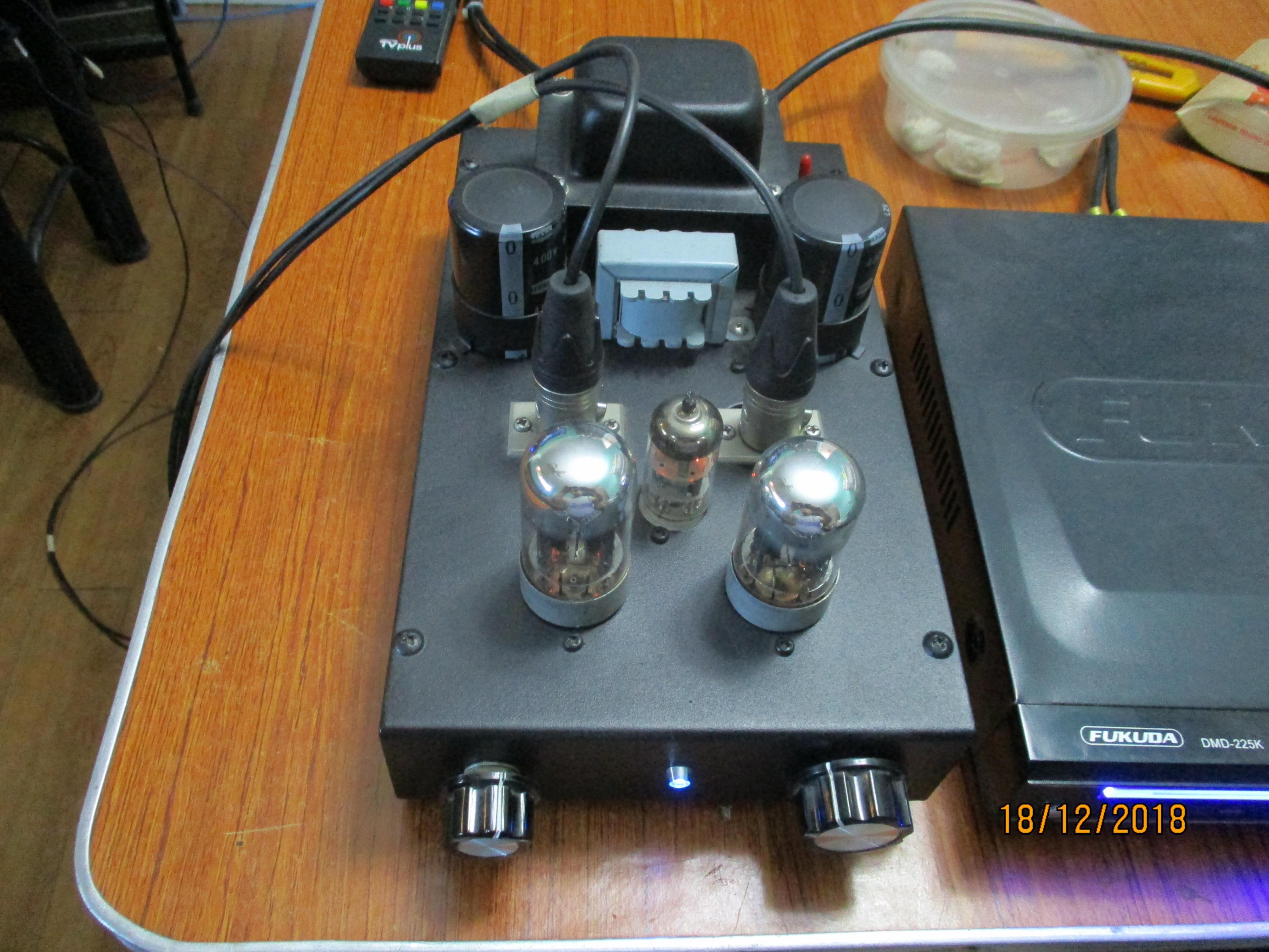

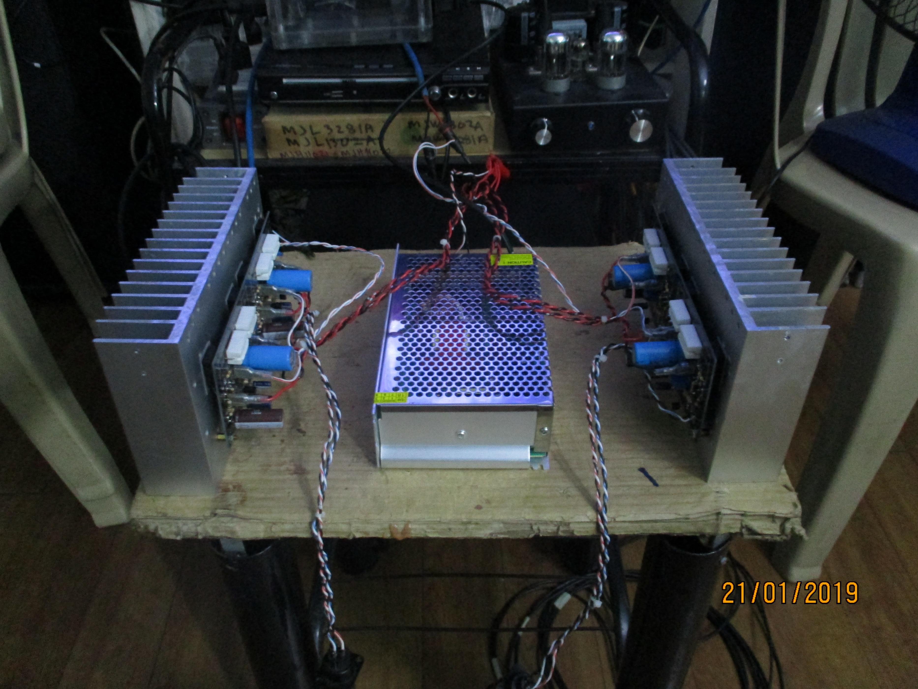

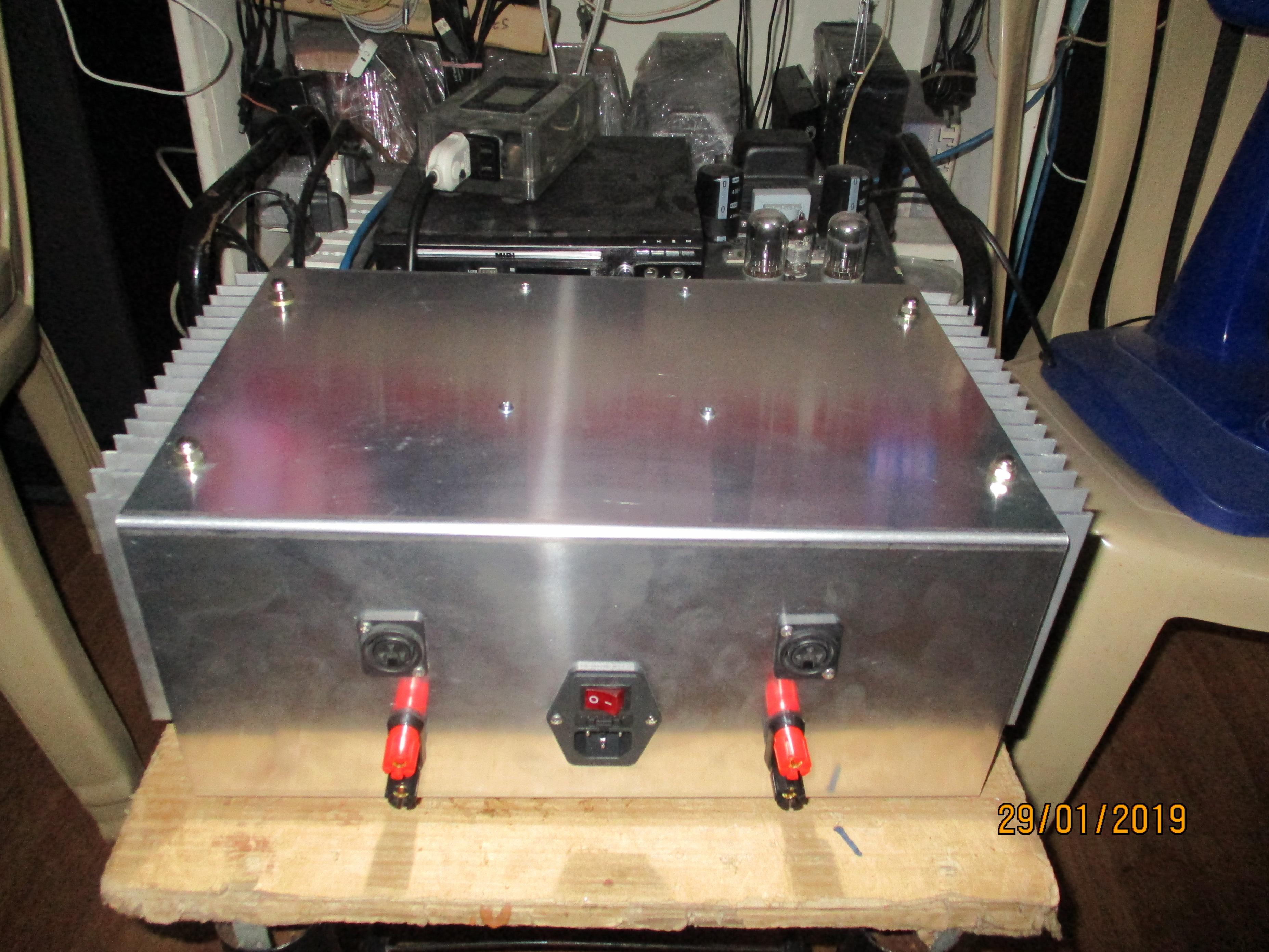

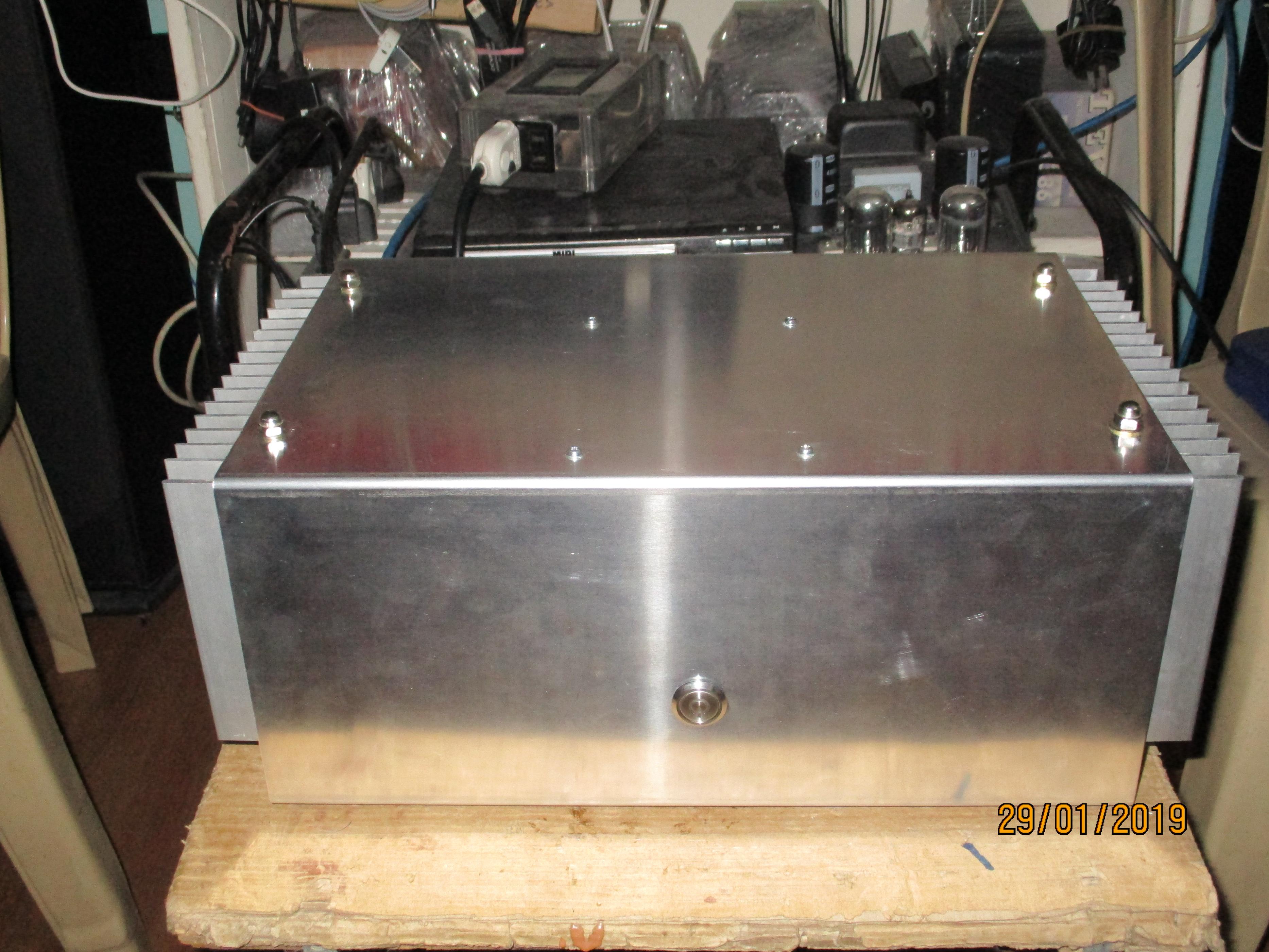

Balanced ACA
balanced ACA....XLR inputs and a SY Impasse clone tube preamp combo....

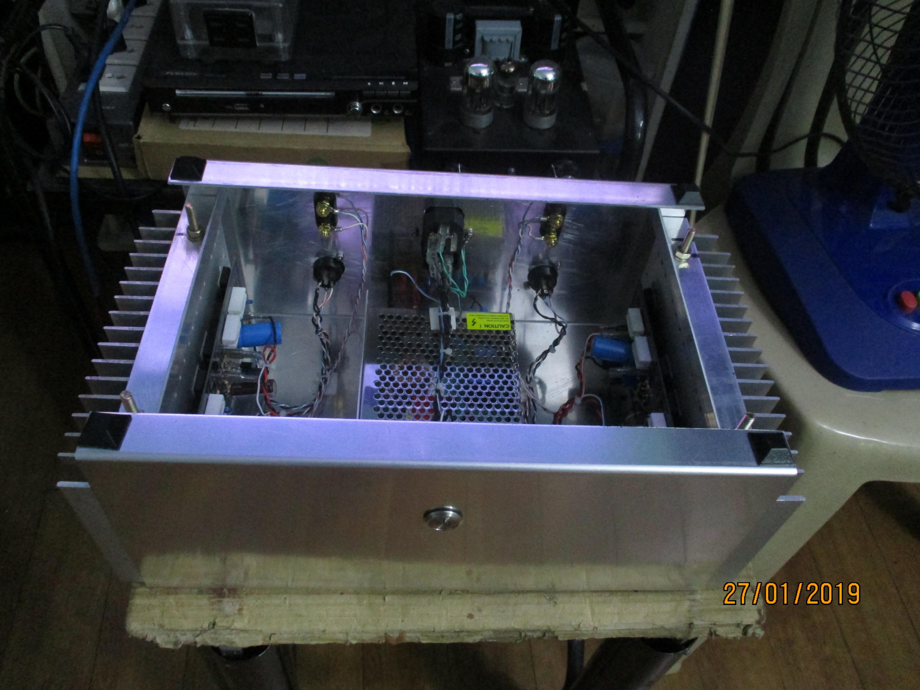

Impressive!
Did you make your own PCBs (for the ACA)?
Stan
Impressive!
Stan

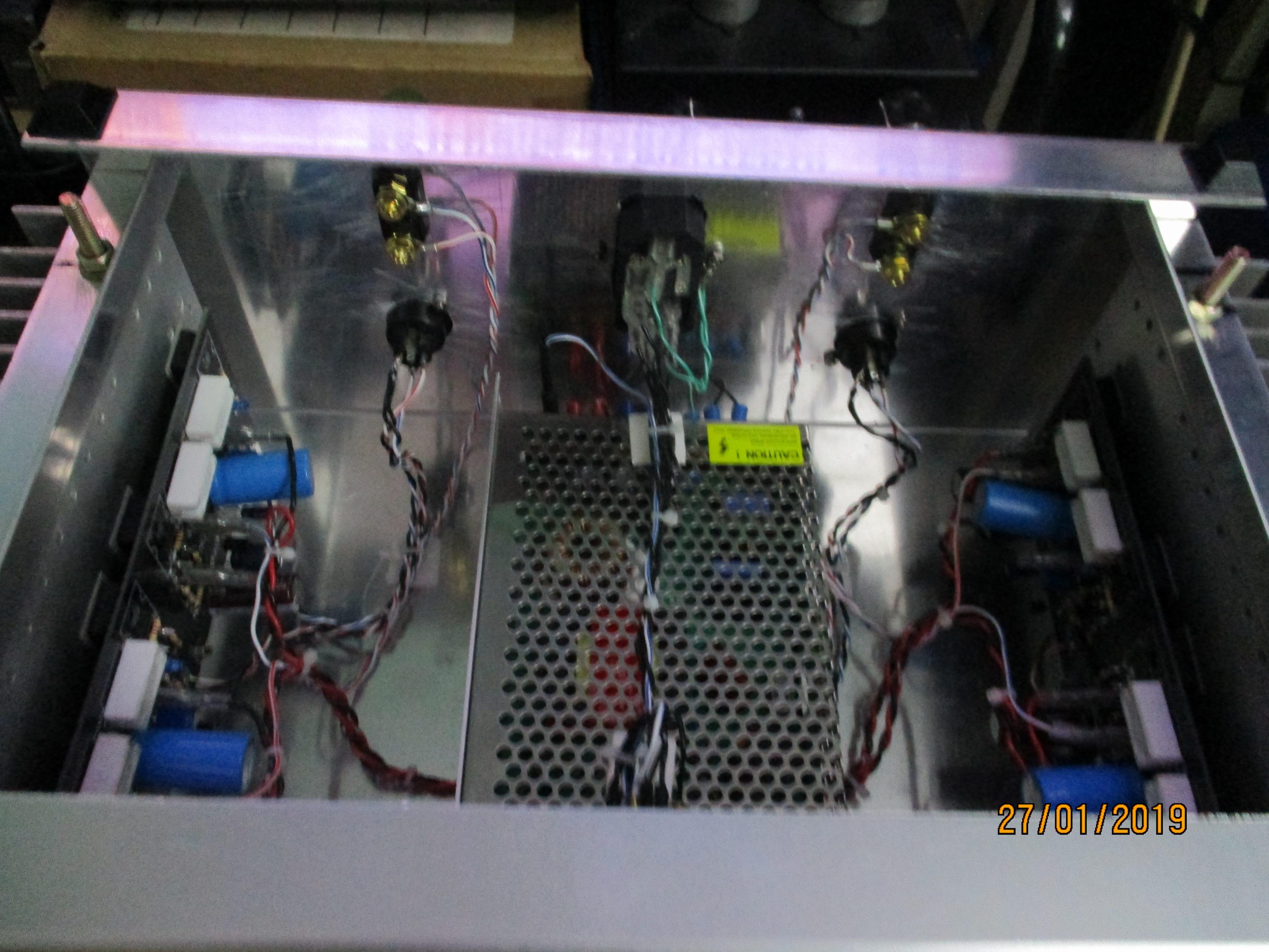

yes, two channels in one board....
