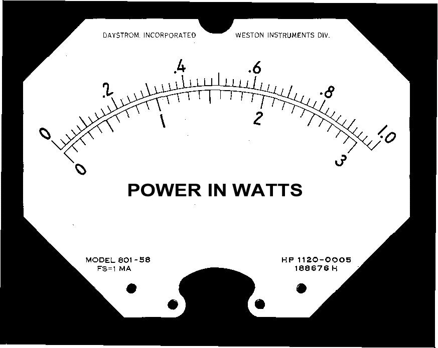

"We approach a watt sometimes but mostly average .2 watts and an occasional peak up around a watt. Beautiful sounding amp!"

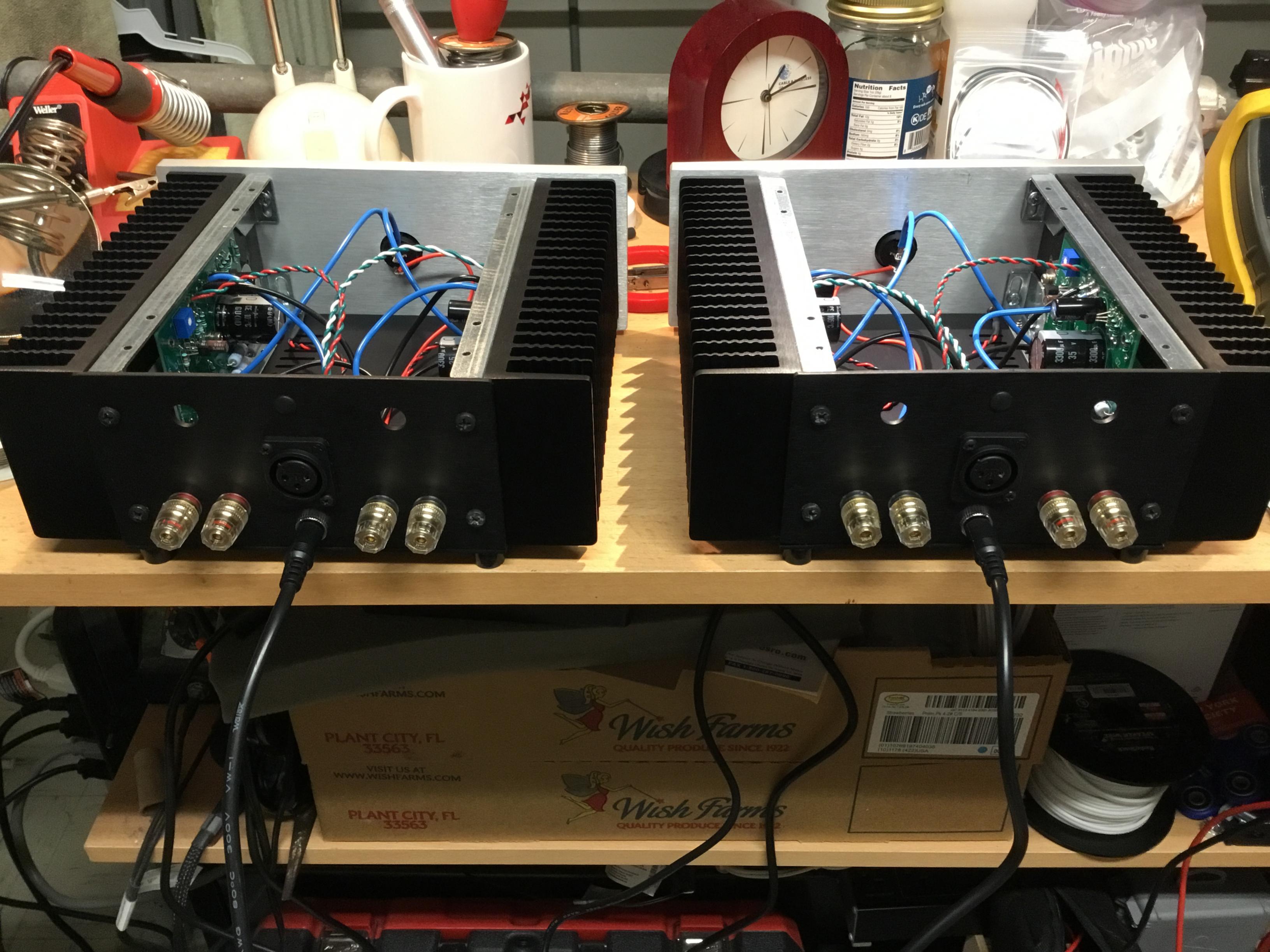

I think my last post was some where in the 300s. My last visit was Dec 10, 2018. 1 year later my ACA v1.6 balanced monoblocks are still doing well.

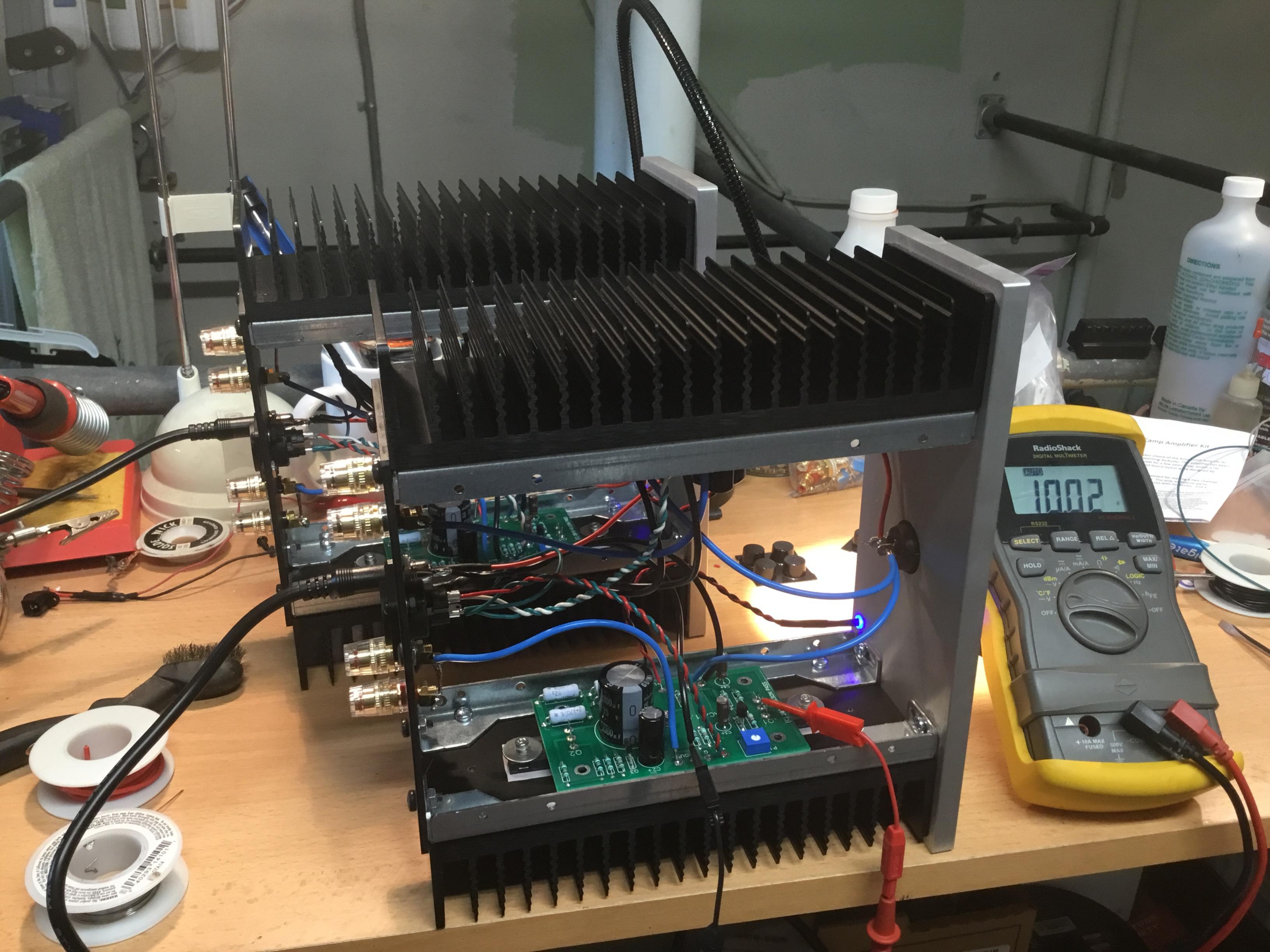

Thanks, good idea. I did as you suggested. Build is complete. Both are now breaking in.

Early on I noticed I wasn't consistently getting the same THD numbers as Nelson, I was just adjusting the bias by looking at sine waves on the oscilloscope. Once I started using a DVM to adjust the bias, the numbers were more consistent and much closer to Nelson's numbers. I think I even posted graphs showing how THD changes when you change the bias. Bottom line, adjust the bias to 12V and you'll probably hear the difference.
setting the bias to 1/2 the B+ or say 12v on a 24vdc psu gives you a maximum output swing, setting the bias current a bit higher, gives you lower distortions...
