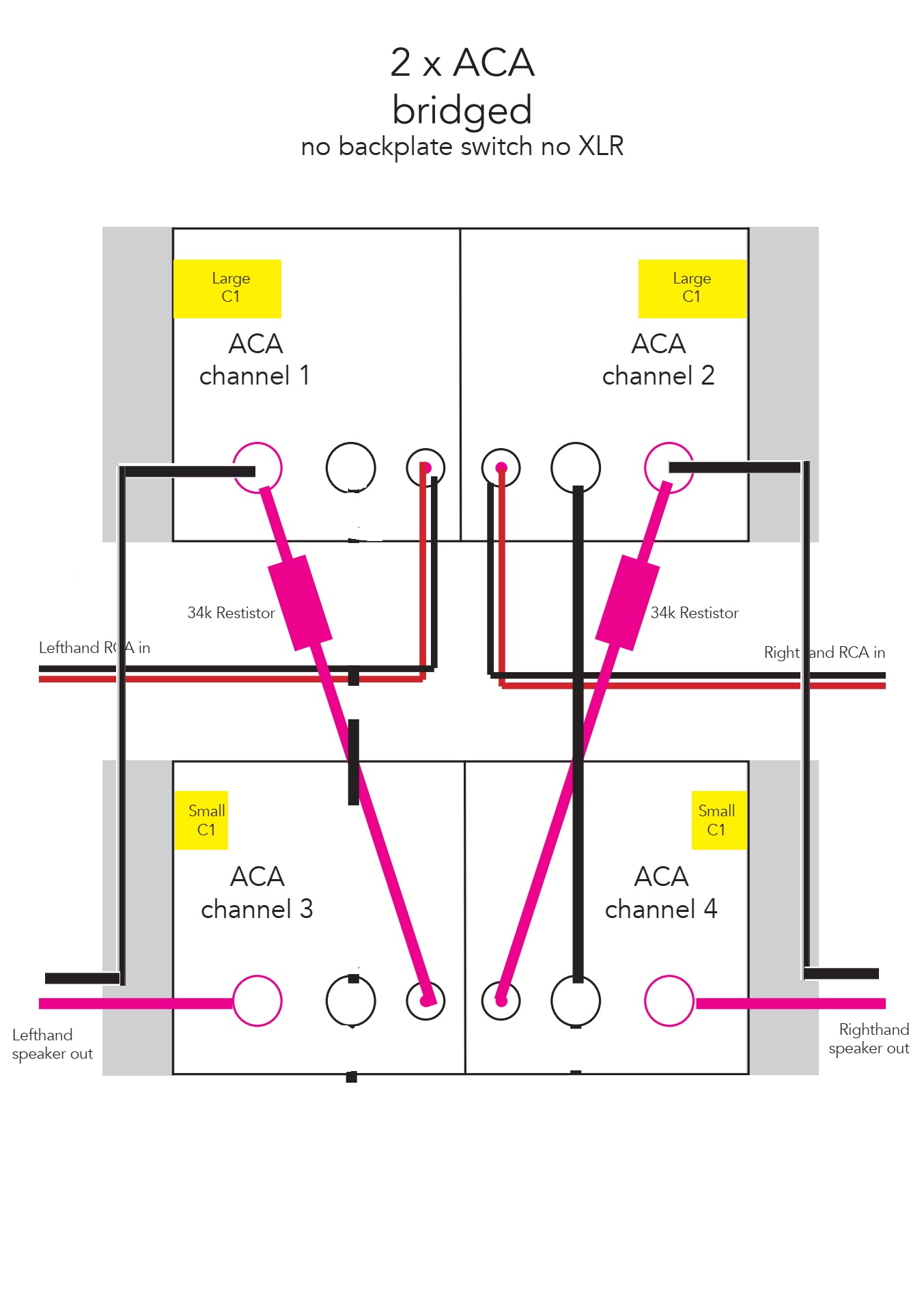

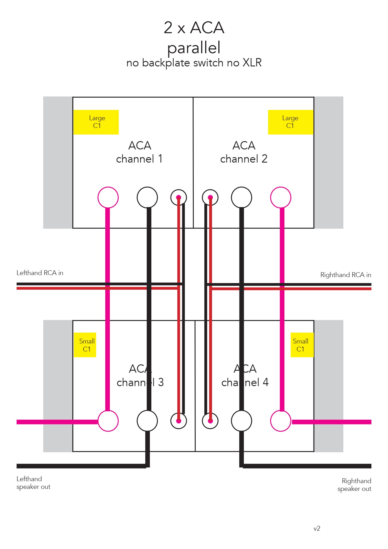

Trying ACA bridged and paralleled
Hi all
Im getting near to to trying ACA bridged and paralleled. I have made some schematics of what I think are the correct wiring for the two options. one ACA will be mounted on top of the other with a fan between. I want to tie the channels together vertically due to different spec c1 in each stereo ACA, so I have one of each flavour in each channel (I blow one and replaced both sides of one ACA).
Ive arranged the schematics to match the input/output layout I have on the backplate and there are also a couple of photos to show same.
I think I have it right any comment would be very welcome thanks

Sorry but neither is correct.
'RCA Bridge' mode:
If you use the ACA build guide as reference, the Red outputs are joined and are actually the -ve or GND line. The Black outputs are the independent outputs. It looks like you have swapped these round in your schematic. That does not matter if you remember the 'RCA Bridge' mode uses the two independent outputs. The two Black terminals in the Build guide or the two Red terminals as you have drawn them. The common -ve / GND (black as you have drawn it) is not used.
'Parallel' mode:
Assuming you have swapped the red and black terminals round (as above) then you should add a link between the two black output terminals as well. Otherwise you will be using the power supply and input cable returns as the link...
I assume the Large C / Small C is to drive two units per speaker? That will only work if you have 4 amplifiers. When you mono block the ACAs you will have just two...
Hi thanks for the repley
the small c and Big c represent the reason for splitting vertically rather than doing the same on each amp, they represent c1 capacitors being the difference between the two stereo amps.
the speaker outputs + and - are swopped round from the ace build guide my. + red speaker terminals are on the outside.
So I think Im right in saying all I have to do is link the black - ve outputs as you say. I had assumed that's they only needed to be linked at imputes but will add that's link.

OK lets get a couple of things confirmed before we go any further.
First, Which output terminals on your builds go to the GND (0v) line? Red or Black?
Second, what does Large C and Small C mean? Physical size or capacity or..?
IMHO horizontal would be better, neater and easier than the vertical build idea. What power supply(ies) are you intending to use?
The parallel picture is fine as it stands.
The Bridged mode depends on the answer to the first question.

black 0v neg -
red v positive +
both caps are the same capacity and voltage as per ACA BOM so as they are different I need to split so one of each on each bridged channel otherwise it will make me uneasy!

If you are sure the Black terminals are connected to the GND / 0 volt line then they will all be connected together through the power supply leads, so no output...
So the 'Parallel v2' scheme cannot work.
V3 is what you would need to do. I have left a wire between 2 of the black terminals to bond the 0 v / GND of both ACAs together.
If you are using two power supplies, then it will be much better to go 'horizontal' (however you want to configure your caps...) then each monoblock will have its own power supply rather than 'share' half and half with the other block.

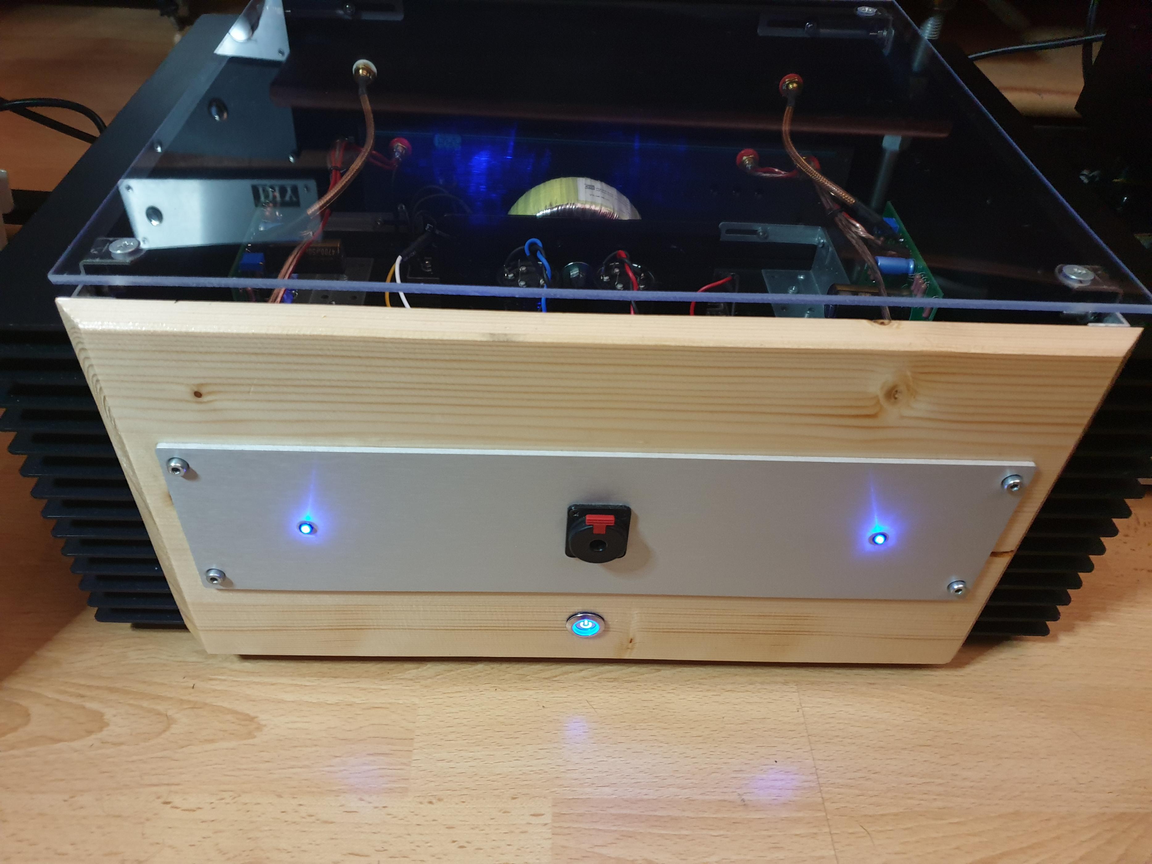

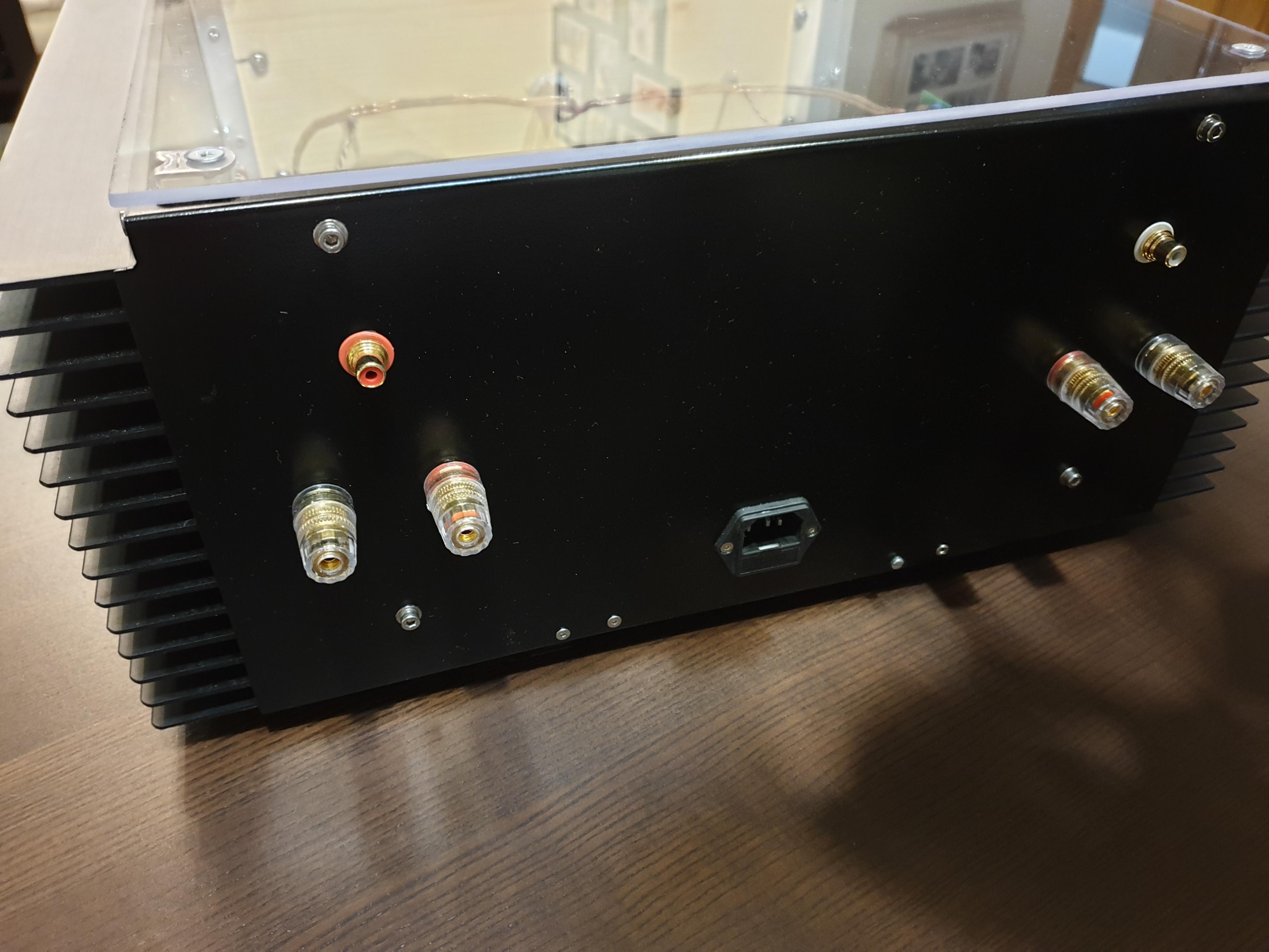

My ACA ready for speakers or headphones.
For the cabinet I used recycled material that I had in my workshop, including big heatsinks.
I am using B+19vdc. I don´t rule out changing to B+24vdc in the future but for the moment I am satisfied with the performance. 🙄
I think it's a good option (and economical) if you use planar headphones like Audeze, Mrspeakers.... With the HD800 I am enjoying a lot.
With more sensitive headphones type Grade, Fostex ... sounds great but I think it is more prone to noises.
As for the construction, what has given me the most problems is the arrangement of the transformer. I had to spend a lot of time moving it until I found a place/position where no noise induced.
