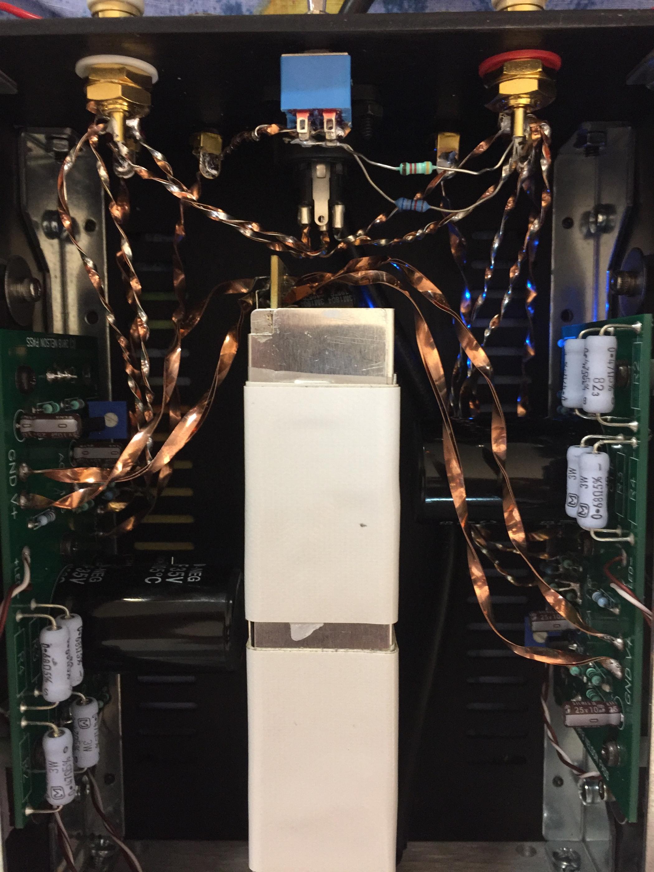

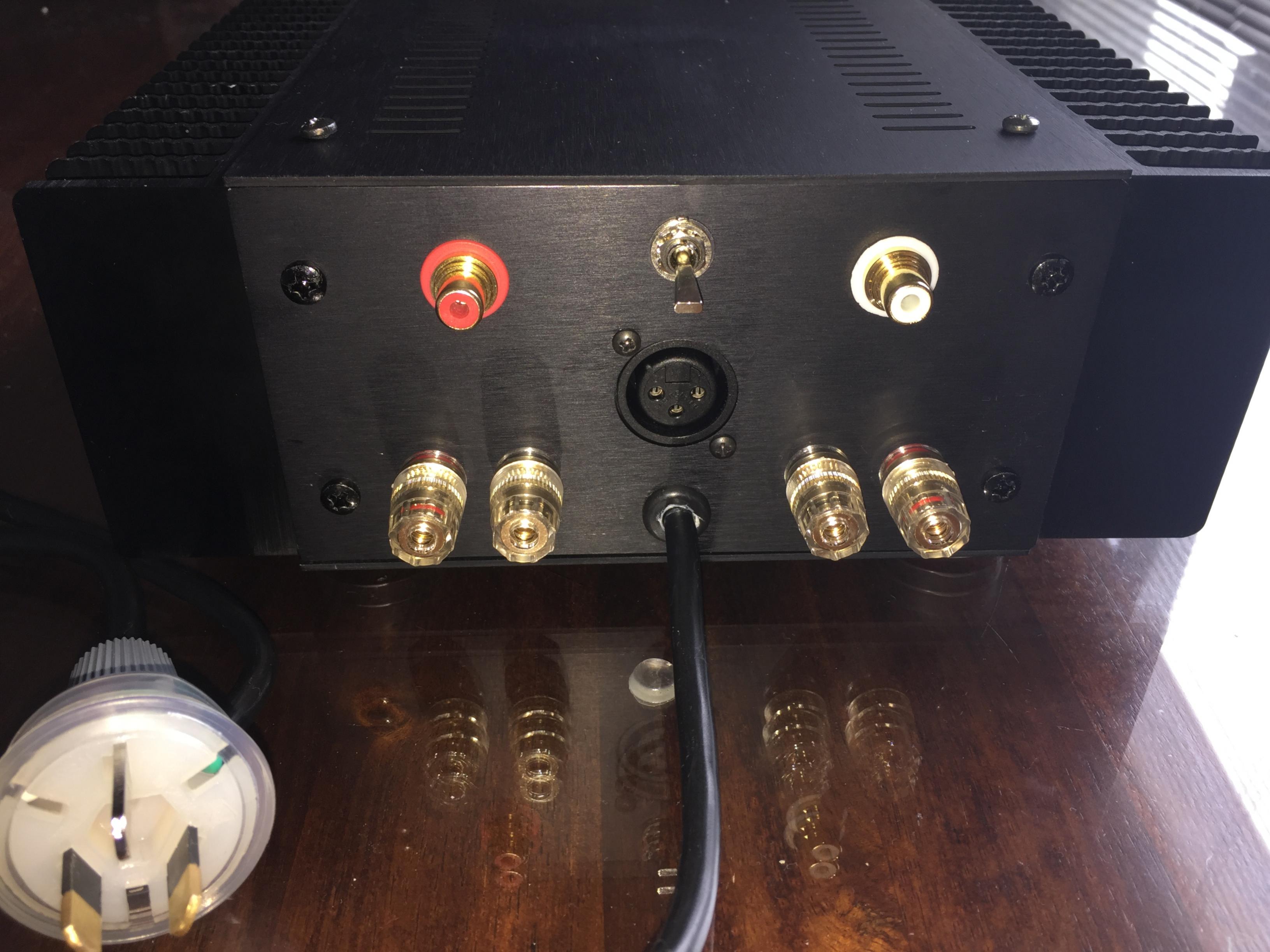

There's simply no other option but to place the power supply inside the amp. I completely understand why Nelson chose to use an external 24V DC power supply - no lethal mains voltages to worry about, so that's cool and completely understandable.
I placed the 24V DC SMPS inside the ACA. The whole thing runs like a little smelting furnace, but the sound is very fast, extremely revealing and very pleasant at the same time... not easily achievable.
Can you give a picture please ?
Sure, there you go...
