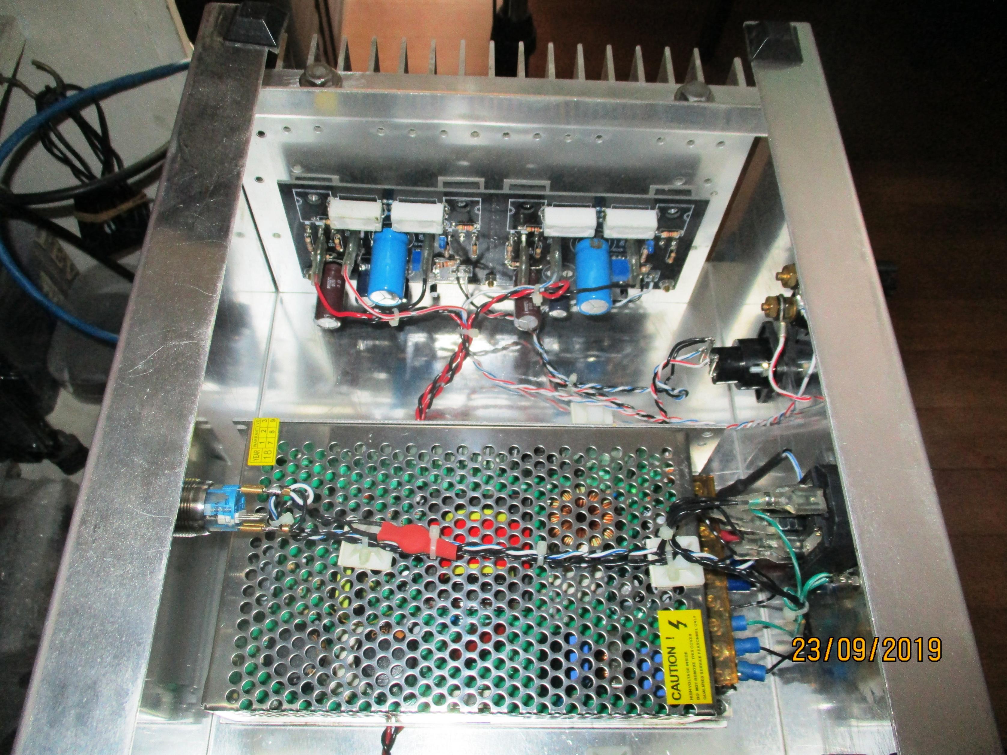

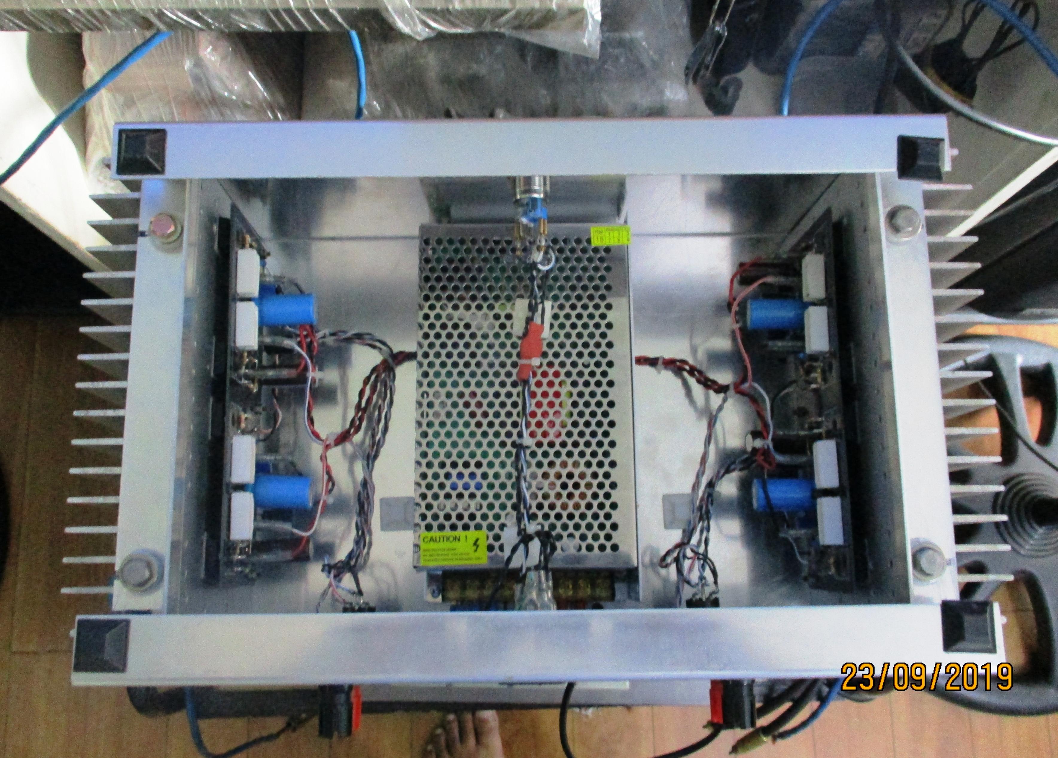

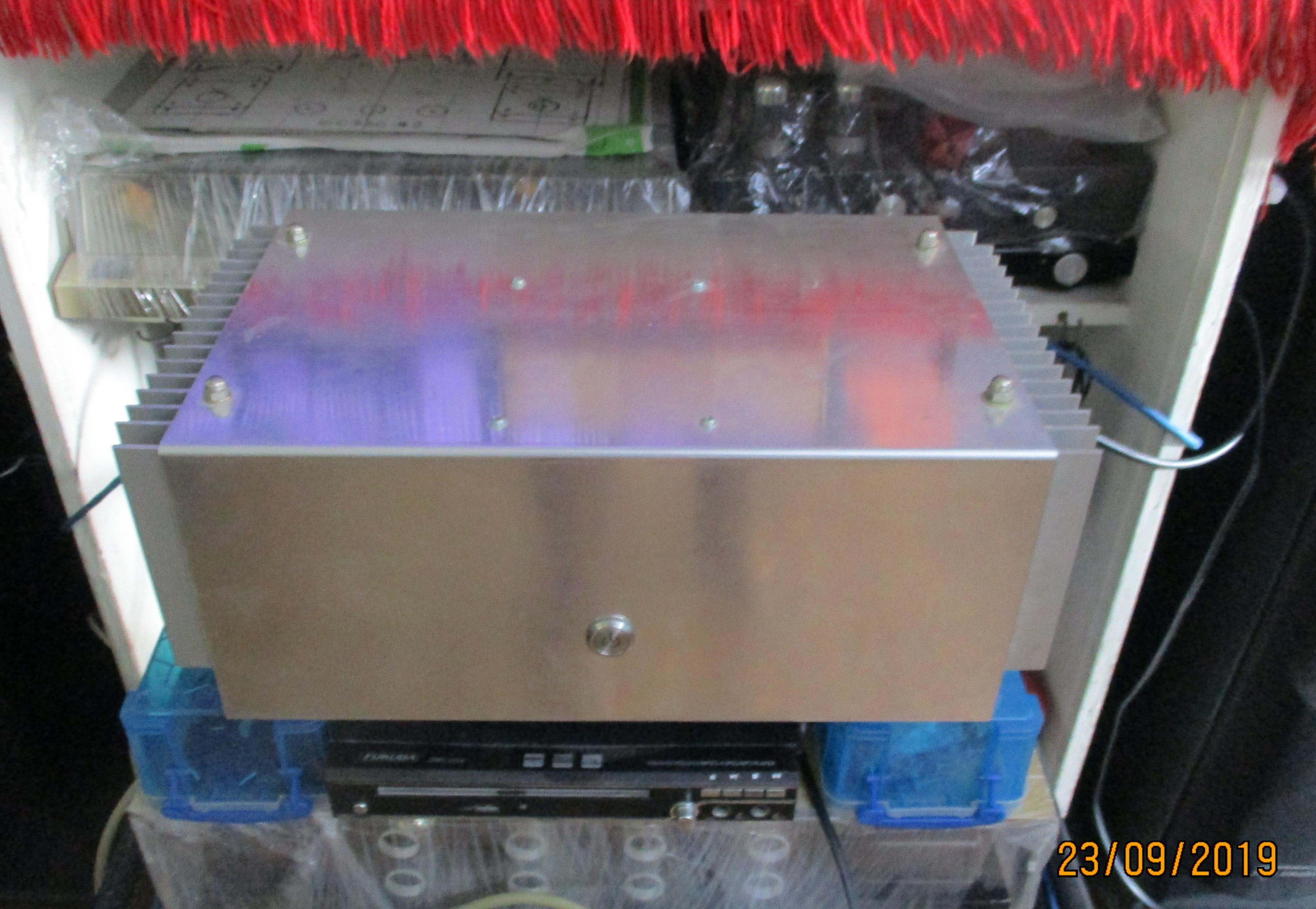

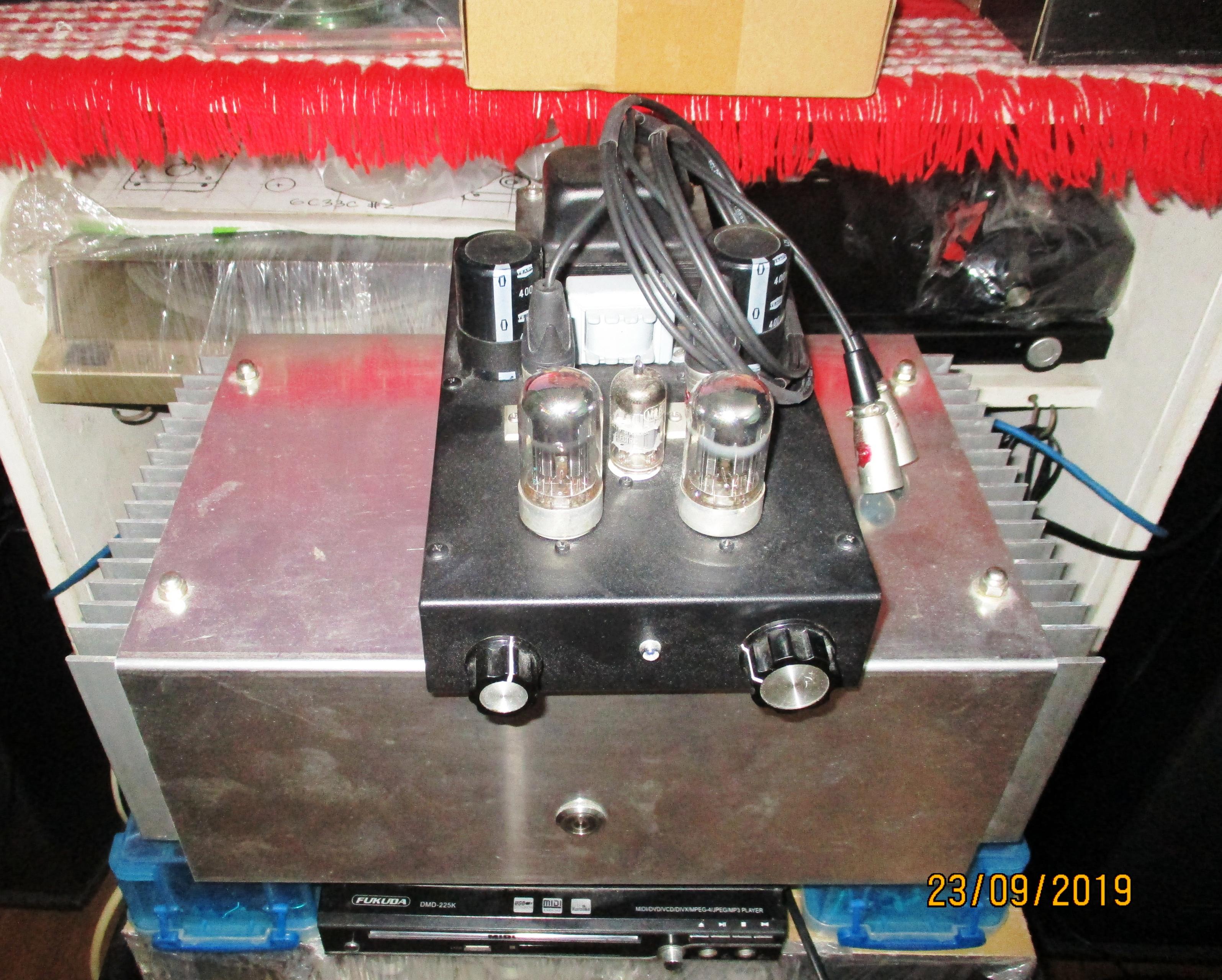

i will post the balance of the pics later, sorry for keeping you waiting...
Edit: thanks for waiting, as promised....

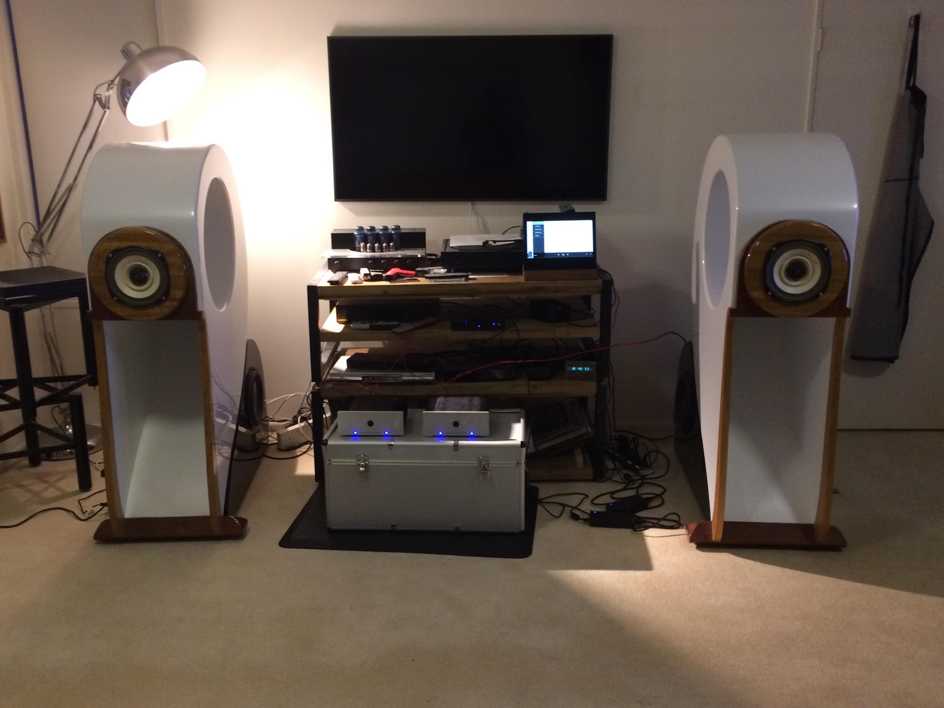

Build a second ACA - If you're a careful person and can follow instructions it's not hard.
In my system the very lowest bass notes come from a subwoofer & plate amp combination but that's taking it's signal from the ACA speaker cables driving the full range drivers. Point being the bass signal from the ACA is very good the limiting factor will be the power. I'm loving it. At the moment I'm using Cambridge DAC magic plus to drive the ACA but have all the parts ordered not for the Korg Nutube buffer. Integrated Valve amp has taken a back seat!
