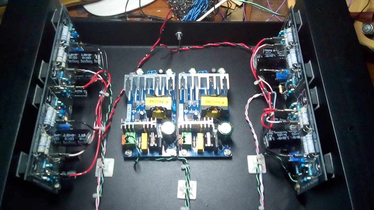

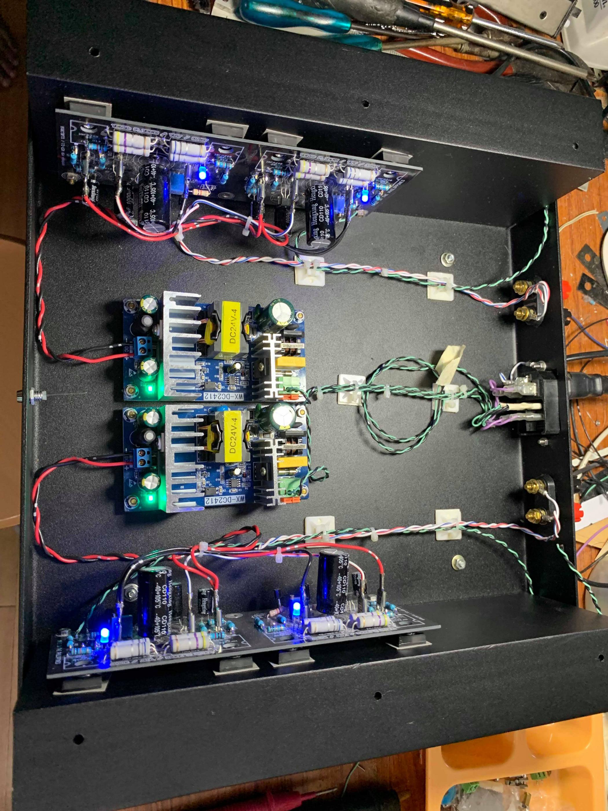

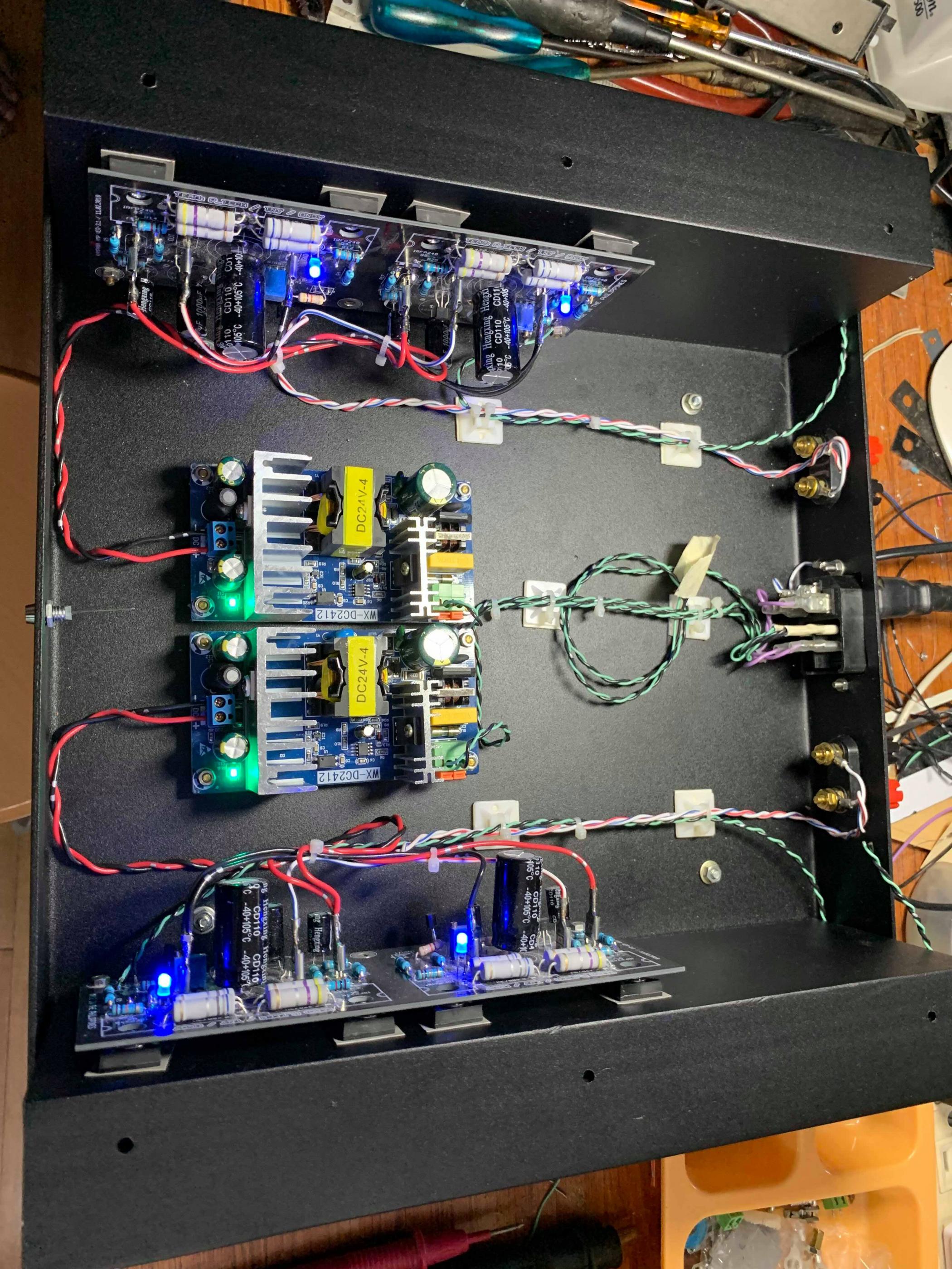

i did two versions of the bridged AmpCamAmps, a fully balanced one, and single ended front end using a 6BC4 tube gain stage, i used 47k/10k for the gain resistors to lower the gain a bit...
the fully balanced version needed a SY inspired 7n7/6rhh8 preamps with balanced outputs..
