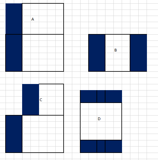

I am currently waiting for boards and heatsinks on ACA amps that i will be building the chassis for. I am hoping/plotting/planning on putting the amps under my speakers in a hole in my speaker stands and doing ACA monoblocks.
the area in the stand is only 7" wide, 11" tall, and 8-9" deep.
i am curious about the group opinion on what the best way to orient the pair of heatsinks in the monoblock will be to not fry anything. The heatsinks are going to be 8"X1.5"X5" so they are slightly oversized for the ACA.
Here are various flavors i have come up with (looking at the amp from the front, with the black area, the heatsinks)
A is basically two monoblocks stacked on top of one another,
B is amp in "normal" position with heatsink on each side, but only 3-4" between heatsinks due to narrowness of stand
C is stacked monoblocks, with upper heatsink offset
D is normal ACA amp configuration with amp basically on its side on the bottom of the stand.
all of these have beauty, heat flow, and build issues. what do you guys think?
thanks for your time
