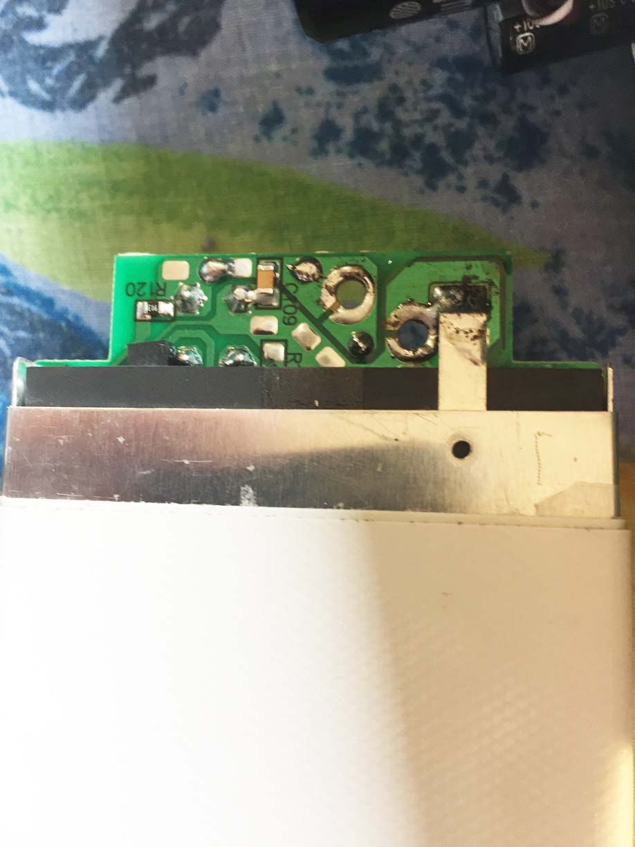

Interesting, which SMPS did you use.

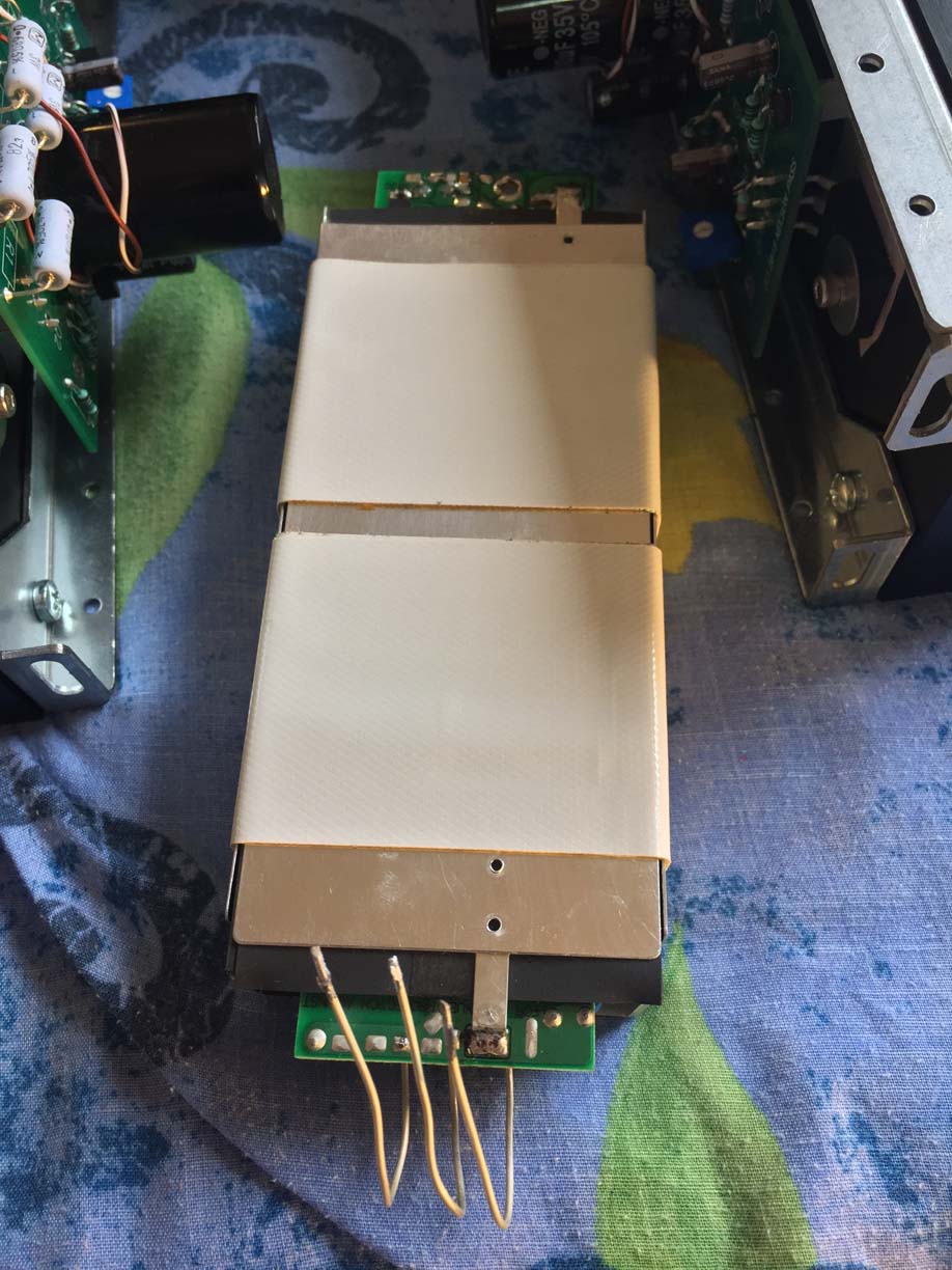

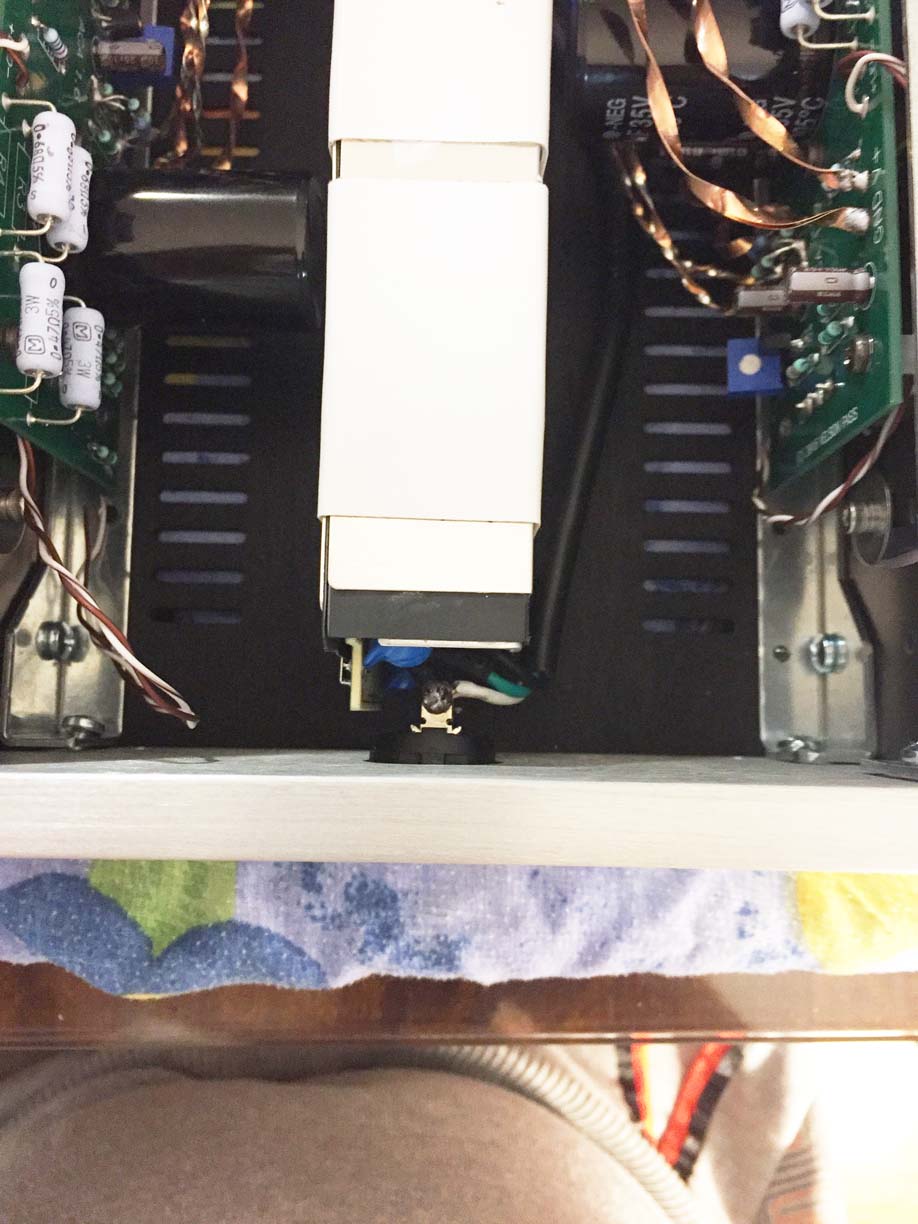

It is the SMPS that comes with the ACA kit. I removed it from the plastic box and soldered few wires. The switch that comes with the ACA kit is good for 5A / 250V AC and it works no problem because it switches the "low current side" - the AC side.
For all those interested in doing this - placing the SMPS inside the ACA, be warned: this requires work with lethal voltages, proceed ONLY if you wish to do so, and at your own risk.
Now I see....neat solution. 🙂

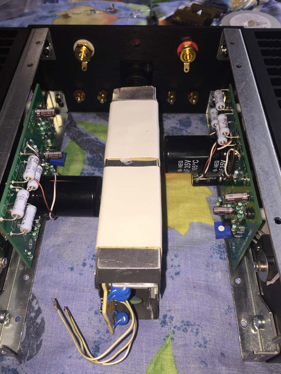

Just out of curiosity, I wired up another MW LRS-150-24v supply effectively making a pair of mono blocks in the one case, for less than $20 I had to give it go.
A bit DIY and a work in progress...
Was it worth it?, yes it was for me, not a huge lift but discernible, bottom end grunt has a tad more weight top sweeter. Though I am a bit surprised (or not) as the ACA (with tungsten mods by the way) sounds better than my F5t or Id rather, after a few weeks, listen to the ACA than the F5t. WTF!!!
