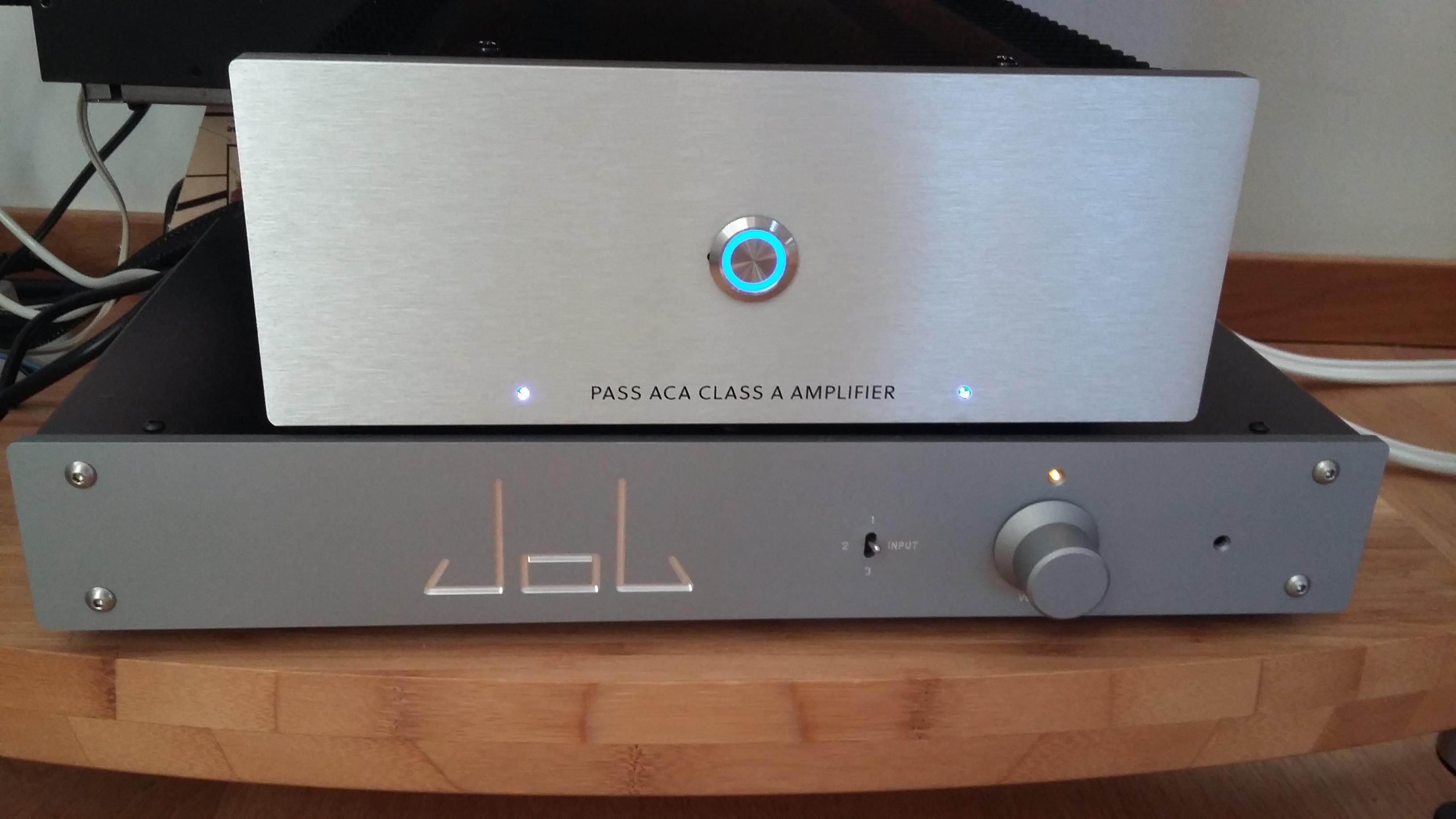

Hi RCV. I built the ACA for fun and by curiosity, but I had no preamp and I was not sure about which one to get in order to match well with my audio system. So many factors to consider : passive or active, solid state or tube, DIY or not, how much gain, cost, combination with the other elements. I have always used integrated class A/B amplifiers, switching to a class A power amp was really new to me. After finishing the ACA, I used the preamp section of a good integrated amplifier (fortunately it has preamp outputs) to test my built. Everything worked fine and I was rather pleased with the sound. However after a period of listening, I felt that it was not quite up to the level of my expectation and below my reference amplifier. Considering that it is a Nelson Pass design, I was hoping for more and I thought that maybe it was the preamp which was a limiting factor. After spending some time investigating different options, I finally ended up getting a Job Pre2 preamplifier. The difference was huge and it brought my system to a much higher level! I like the combination with my Klipsch FORTE III loudspeakers, of course it is subjective and my personal taste.Hi! I am waiting for the delivery of my two amp kits. In the meantime, I am thinking of what preamp to pair with the amp kit to control the volume control. I will appreciate very much your recommendations.
What I am trying to say is that the choice of the preamp should be done carefully and it will make the ACA really shine.

but no info on the gain of the unit. I'm using the ACAs as balanced mono blocks fed by a Schiit Freya using its tube stage with a gain of 2.5

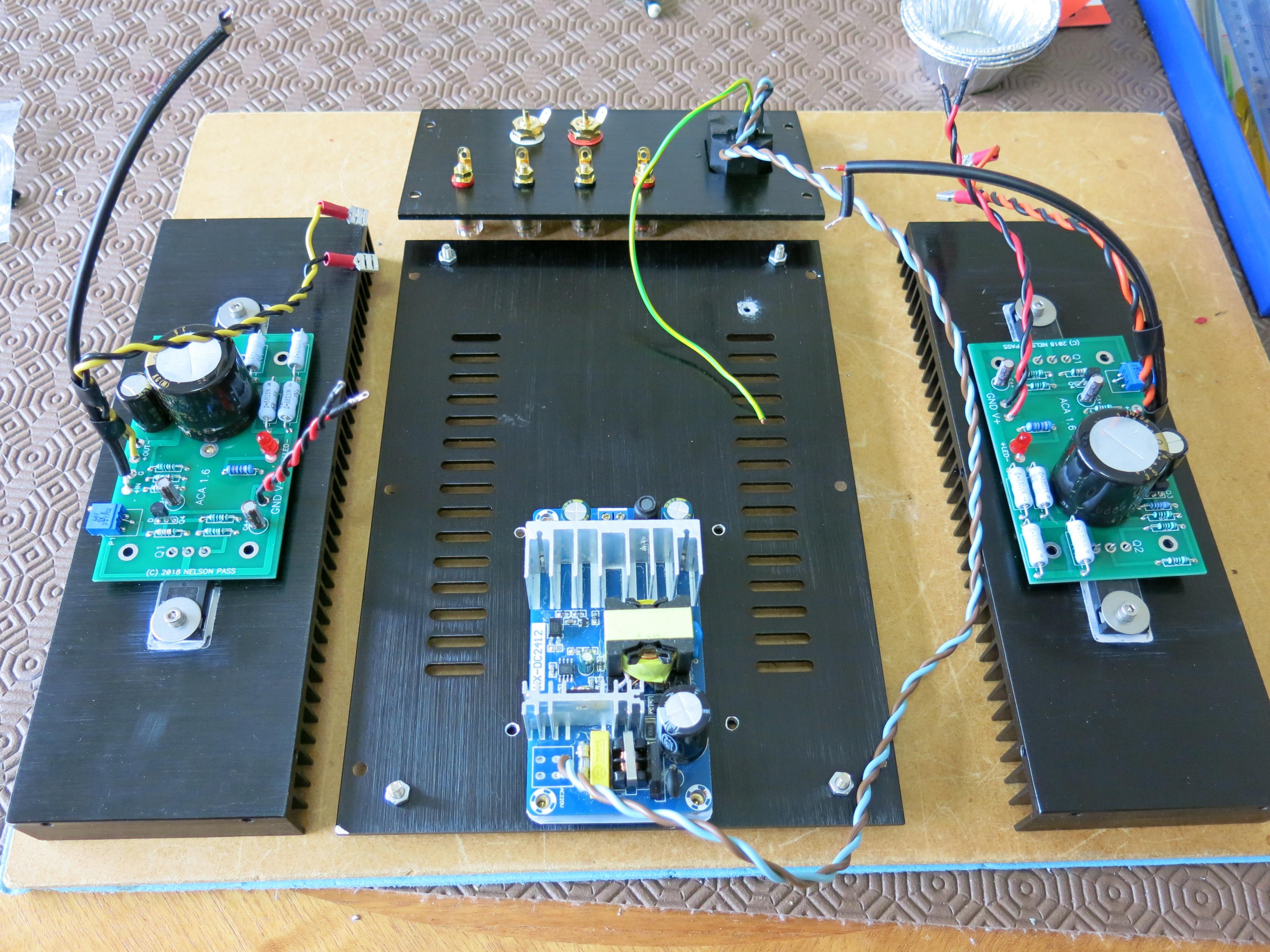

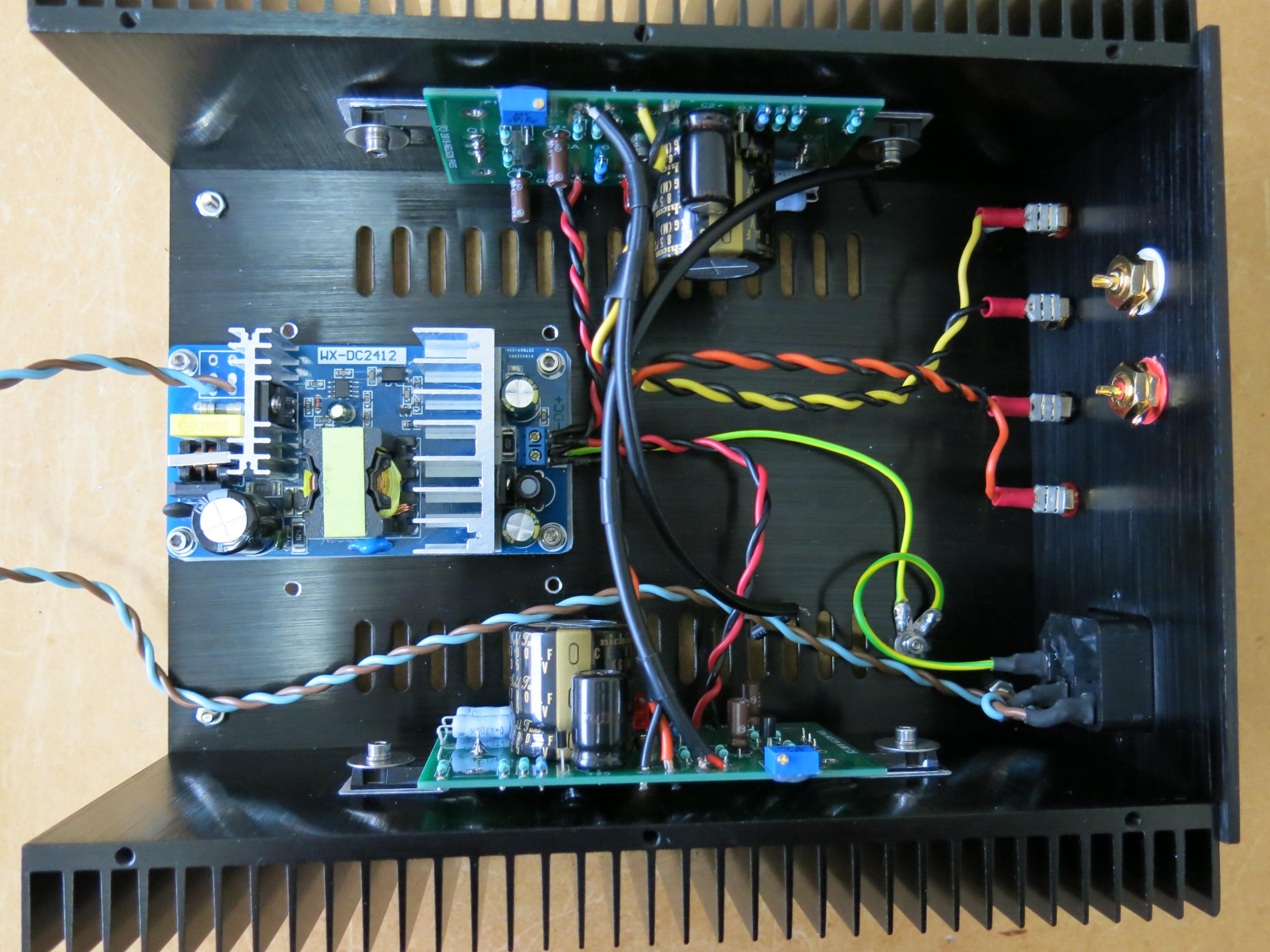

Does anyone know if this would work for some ACA moons?
2412B Full Aluminum Enclosure / mini AMP case/power amplifier box/ chassis | eBay
Should be more than big enough!
As long as you do not mind drilling and tapping the heatsink holes for the Mosfets and board mounting.
I have mine built into a slightly smaller version as I wanted to have my power supply integrated and have a narrower front panel than the 'standard' ACA chassis. (Example only Express Delivery Full Aluminum Power amplifier Enclosure chassis case heatsink | eBay) and it runs nice and cool at 43 - 45 degrees Celsius.
