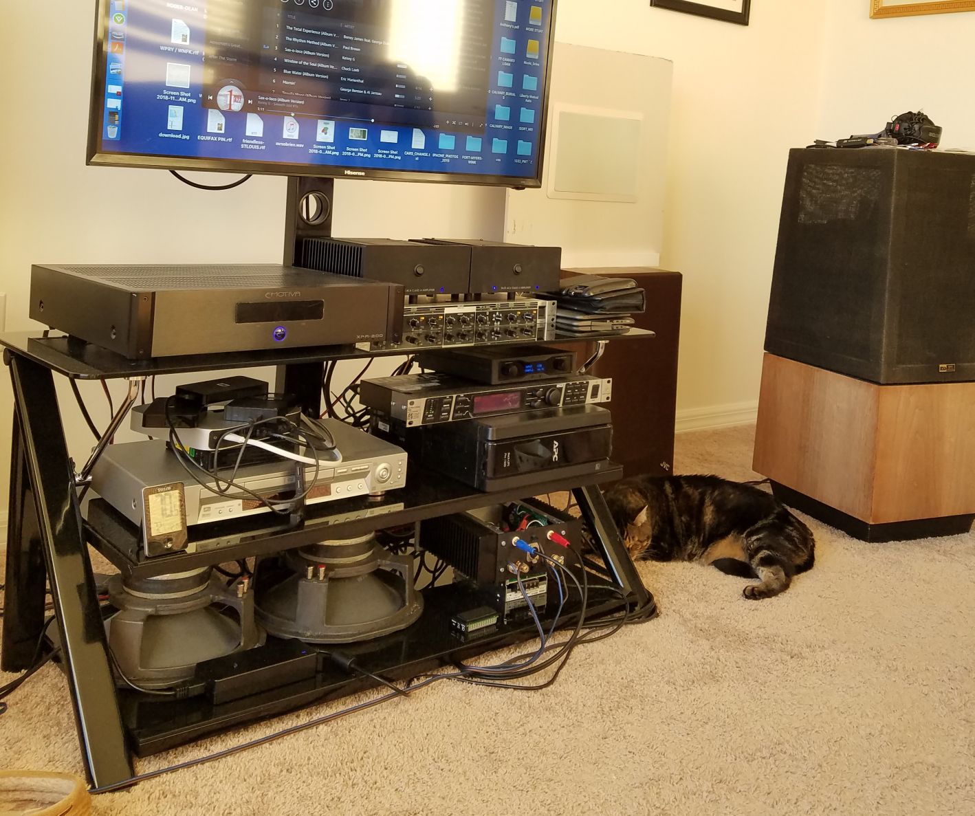

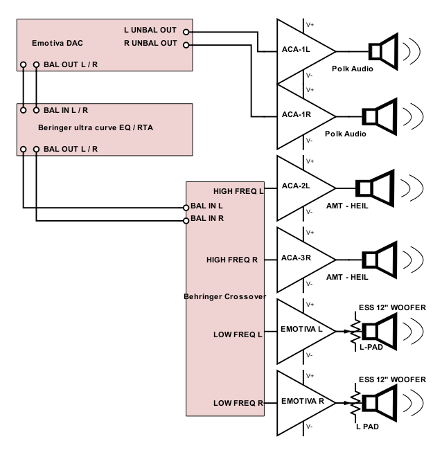

For those pondering the step to active crossovers and amps for each driver. Well worth it.
Unbalanced ACA gives the rich harmonics. And that feeds the in wall speakers.
Balanced gives the AMT's pristine high frequency response.
Emotiva has plenty of current to run the woofers when they need it but is mostly loafing. L pads are on its output so it has to do some work.

Yep that’s about exactly what I’m going for . 👍 thanks for the little graphic I’ve been trying to find more and more information on set up like this I have to build some more amps some preamps I would like to build my own DAC and phono stage and if I feel real wild I’m even thinking of building my own turntable I believe I have just about enough experience and knowledge of DC motors sensors for tracking perform on my own metalwork, wood work or stonework my own brasing or welding, Metal casting and machining .

Thermal Alchemy, suggest that you read the prior posts by tjw59. When I say a professional setup, that means HIM. He describes the way he did it and it is fascinating.

Thank you Molly for the visual and the explanation by answering one question of course we all know that leads to 10 more questions.
