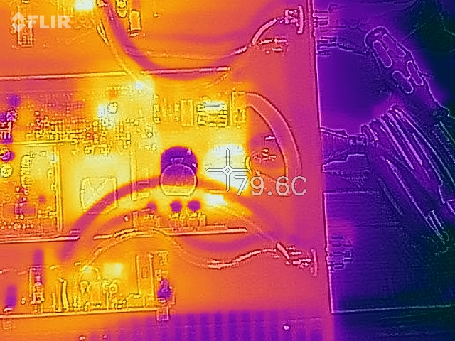

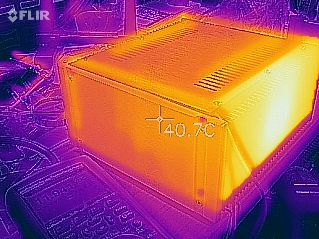

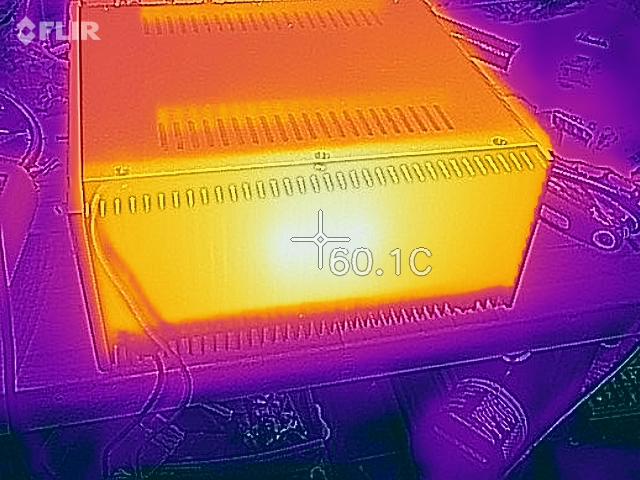

I built a stereo ACA using a variant of that chassis (no knob) and the previous gen ACA boards with an internal 24V power supply and mine runs hot: 60°C at 25°C ambient. If you run an external supply you might be ok. An external 20V should run it even cooler. The latest ACA boards have the FETs placed further apart, and that should help with the spreading the heat across more of the heat sink. This chassis has fins that are only 1” tall/deep as compared to 2”, but the heat sink has more area than stock. To reduce the case temperature I’m planning to mill vents in the solid bottom cover, to improve internal convection cooling (the top is vented). One other caveat is that there isn’t much meat on the heat sink so it was difficult to tap blind holes and have enough thread engagement for the standoffs. If you’re ok seeing the standoffs through the heatsink then it’s a lot easier to tap a through-hole.

Olen, to improve convection of your unit you should consider adding legs that leave about an inch clearance from the surface where it lies to the bottom of the unit. This will increase the ease for air intake into the enclosure. You may want to consider milling or drilling the top cover as well as the bottom to increase convection.

Thanks for the tip OC11, I had the very same thought so I added a 3/4” wood spacer underneath the existing feet, which only helped lower the heatsink slightly, less than 1°C if I remember correctly. You can see the spacer in the picture showing the front of my amp.

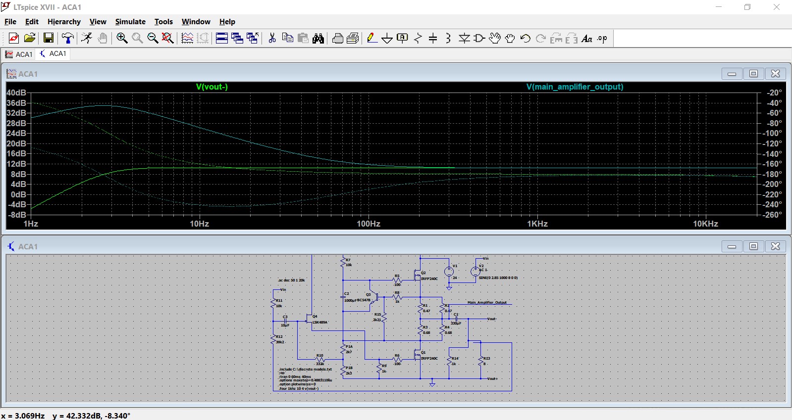

From my understanding having a cap on the output provides the DC filter and the size of the cap will impact low frequency roll off. If I put 3300uF into a crossover calculator at 4 ohm I come up with a rolloff at 24hZ or 12hZ at 8ohm. I am very much a newbie as well so this is all the blind leading the blind. Don't have any idea if there are other factors impacting the feedback loop.
C1 couples the amplifier output to the speaker and it is needed to prevent continuous DC current flowing in the speaker.
The ACA output is at a nominal 12 volts DC and so without the cap a current of I= V/R would flow, which means for an 8 ohm speaker means a current of 12/8 or 1.5 amps. Result, one burned out voice coil.
The cap forms a 1st order filter in combination with the load, or at least would were it not for the fact that the feedback is taken from the output side of the cap. This technique means that the amplifier tries to maintain the wanted output voltage as frequency falls.
The advantage of this is that the caps shortcomings are compensated for, and we can also use a smaller value cap while still maintaining a flat low frequency response.
The disadvantage is that as frequency falls, the amp works harder to maintain the output voltage and so will clip earlier at low frequency compared to the midband.
So as always its a compromise, and 3300uF is a good value for operating into most realistic loads that will be encountered.

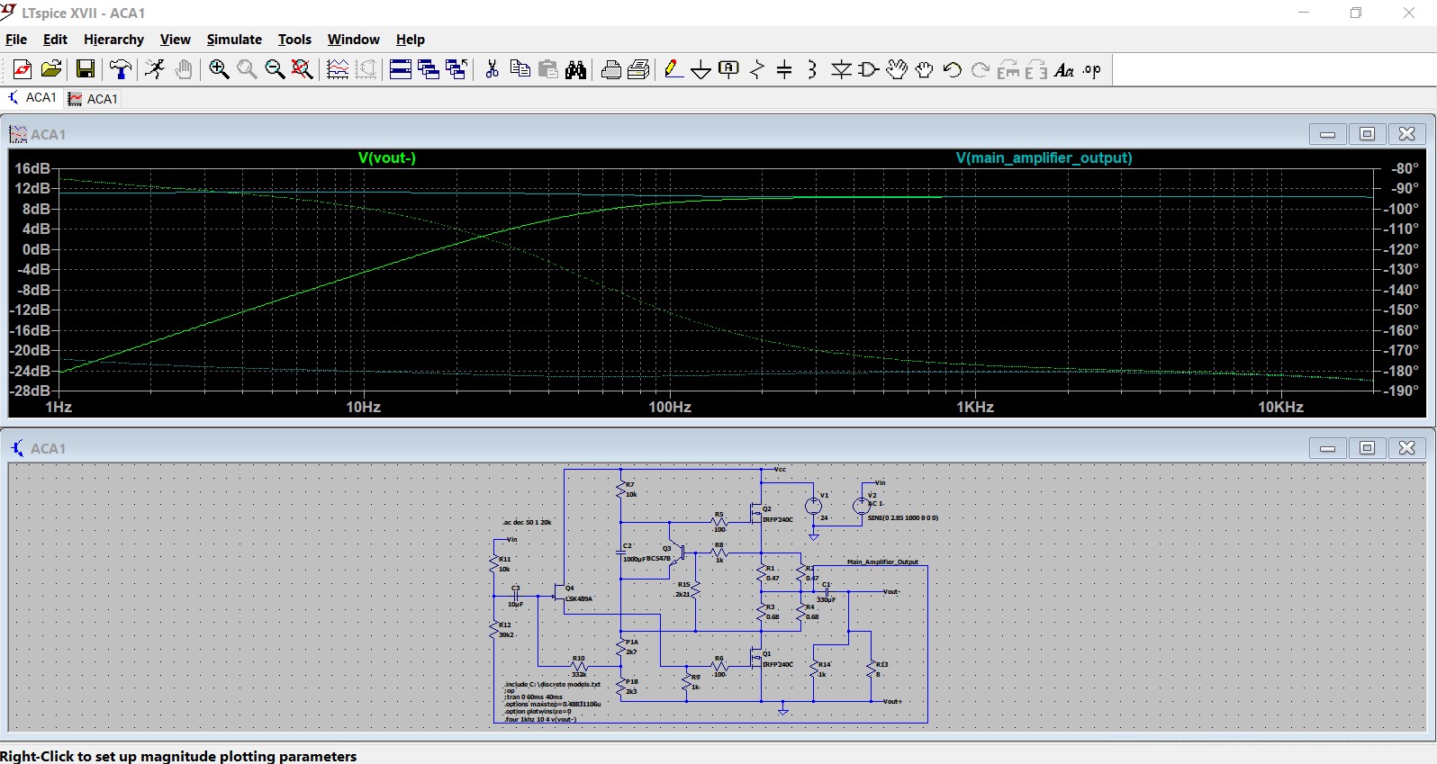

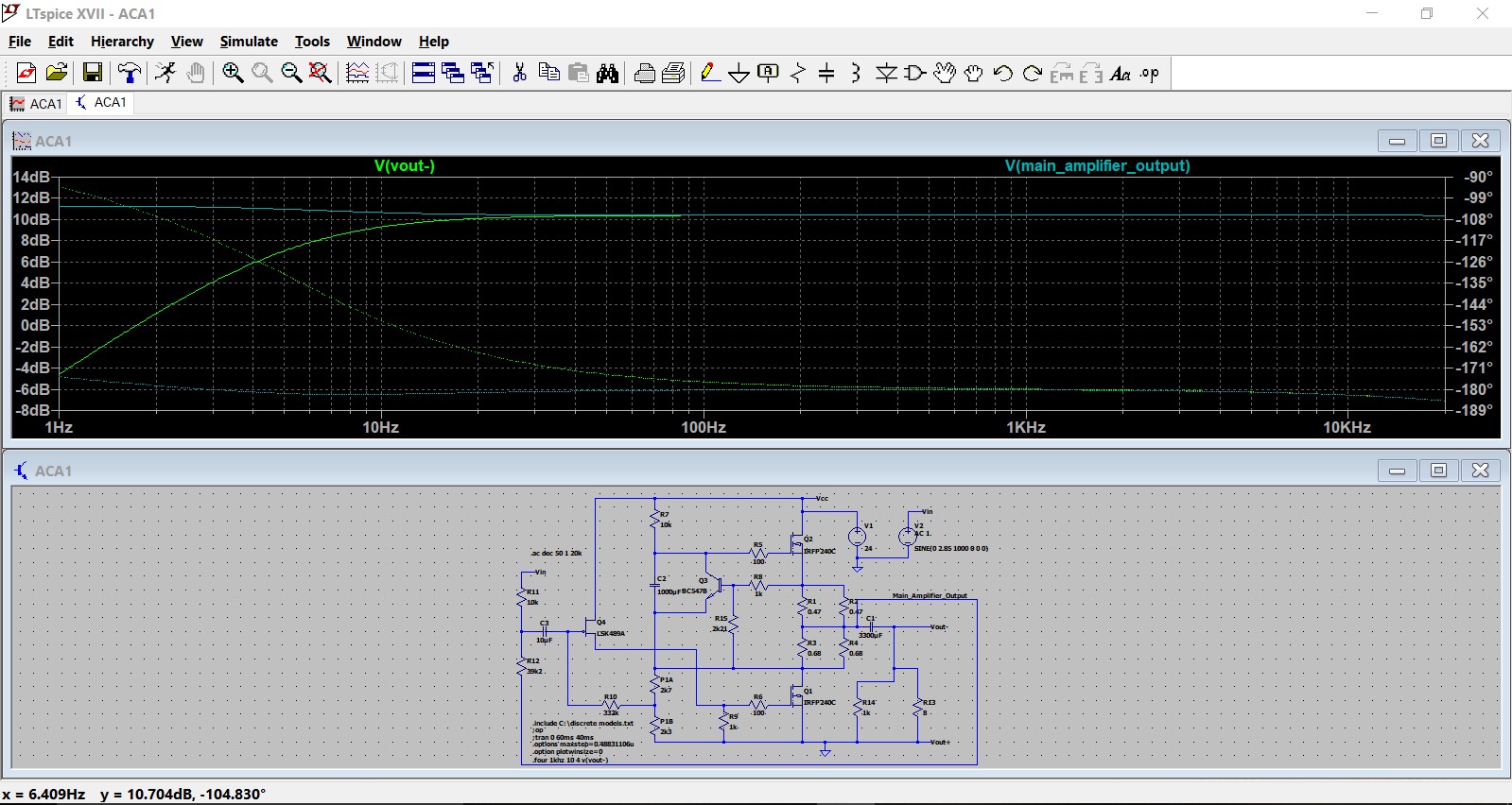

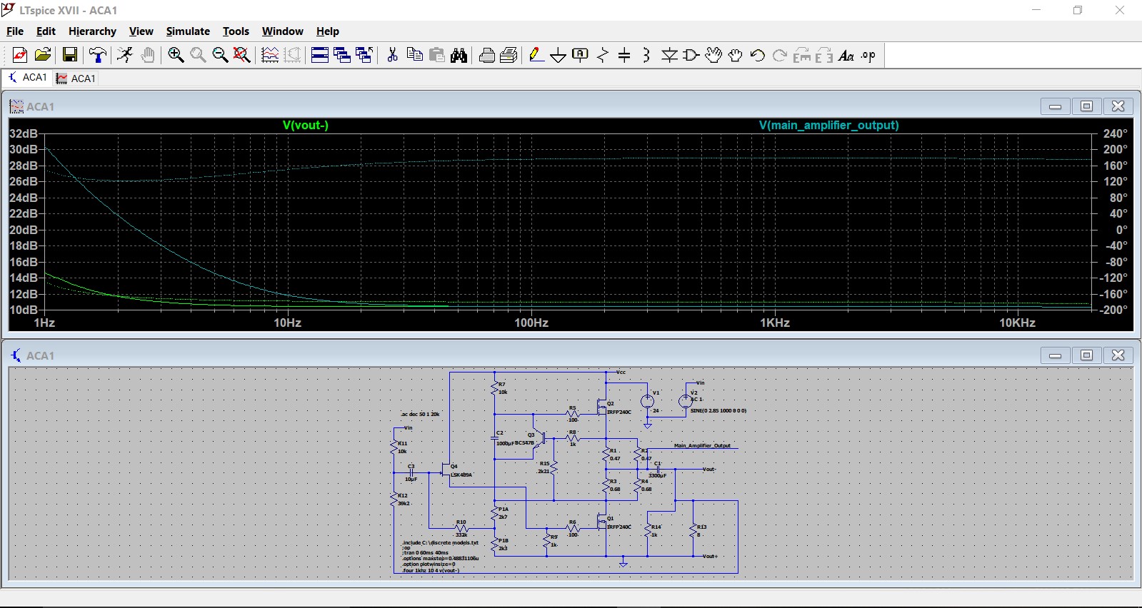

This shows how enclosing the cap within the feedback loop maintains the response, but also how it achieves that at the expense of headroom.
These images should help explain how it works. There are two points being monitored, the normal speaker output from after the cap and also the main amplifier output before the cap.
Image 1 is a conventional feedback take-off point from before the cap. It may seem unexpected that the main amplifier output has a slight rise in amplitude at LF, however this is caused by the fact that the load current is reducing (due to the caps reactance) and that in combination with the ACA's fairly high output impedance manifests itself as an increase output.
Image 2 shows the feedback connected as per the ACA design. Notice how the speaker output is now maintained at an approximately flat response, but also note how the main amplifier output (before the cap) rises almost exponentially in order to achieve this.
Image 3 shows the cap reduced in value by a factor of 10 i.e it is now just 330uF. The feedback is now connected conventionally and the LF roll off is significant.
Image 4 is once again back to the ACA feedback connection method and we can see how the amplifier main output rises to counteract the increasing impedance offered by C1 as the frequency falls. The output is maintained down to approximately 4Hz, but at what cost ? The cost is the massive output needed before the cap, and that increase needed is now so great that the ACA would run out of headroom. Look at the 36db maximum level needed to maintain the ACA's nominal gain at the speaker terminal.
