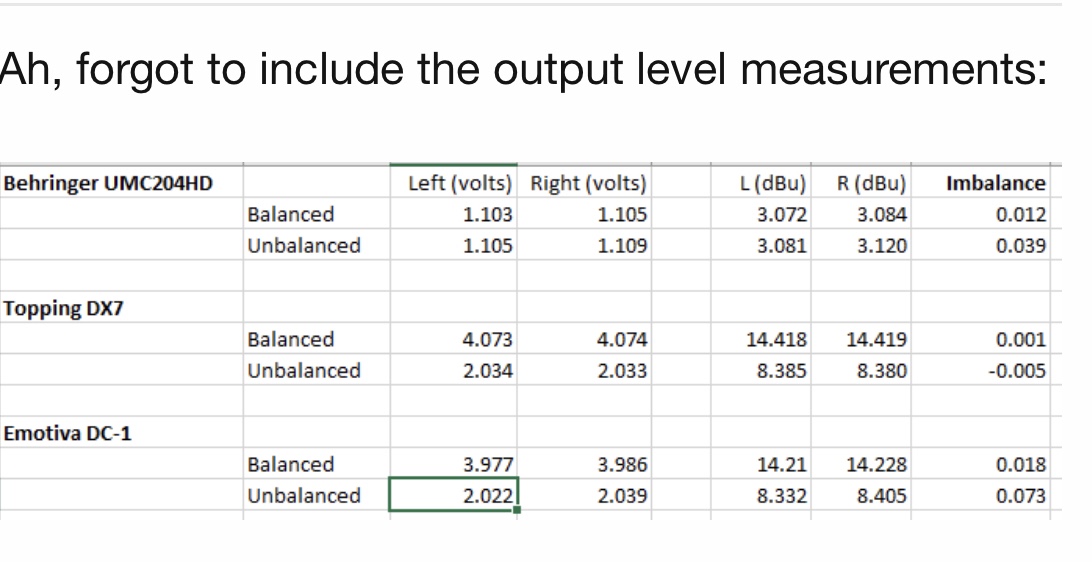

@tjw59. Checked the specs and could not find the output levels of the DC-1 unit (single end and balanced output levels). This is what I was looking for.
Frequency Response:
20 Hz to 20 kHz + / - 0.1 dB @ 44.1k sample rate. 20 Hz to 40 kHz + / - 0.1 dB @ 96k sample rate. 20 Hz to 70 kHz + / - 0.1 dB @ 192k sample rate.
THD+N:
0.00033% or less @ all sample rates.
IMD (SMPTE):
0.0025% typical.
S/N Ratio:
> 95 dB @ all sample rates; 16 bit word length. > 115 dB @ all sample rates; 24 bit word length.
Input Connectors:
One pair unbalanced analog audio (consumer level); gold plated solid machined RCA. One AES/EBU digital audio (XLR).
Three S/PDIF digital audio (1 x RCA, 1 x BNC, 1 x Toslink optical).
One USB digital audio input (“type B” USB connector; UAC2).
Output Connectors:
One pair unbalanced analog audio (consumer level); gold plated solid machined RCA. One pair balanced analog audio (pro level; +6 dBV); XLR.
Two headhone connectors, front panel (2 x 1/8” stereo “mini”, individually amplified).
The output of the DC1 are what you would expect from a DAC with a decent analog stage but nothing too fancy. As it has been shown they are adequate for the ACA. The real question that remains (and please remember that very few people can do the type of sound analysis and adjustment that tjw59 did) is could the music coming from the ACA be improved by a greater gain from the source. This means a preamp. I would say this is possible.
