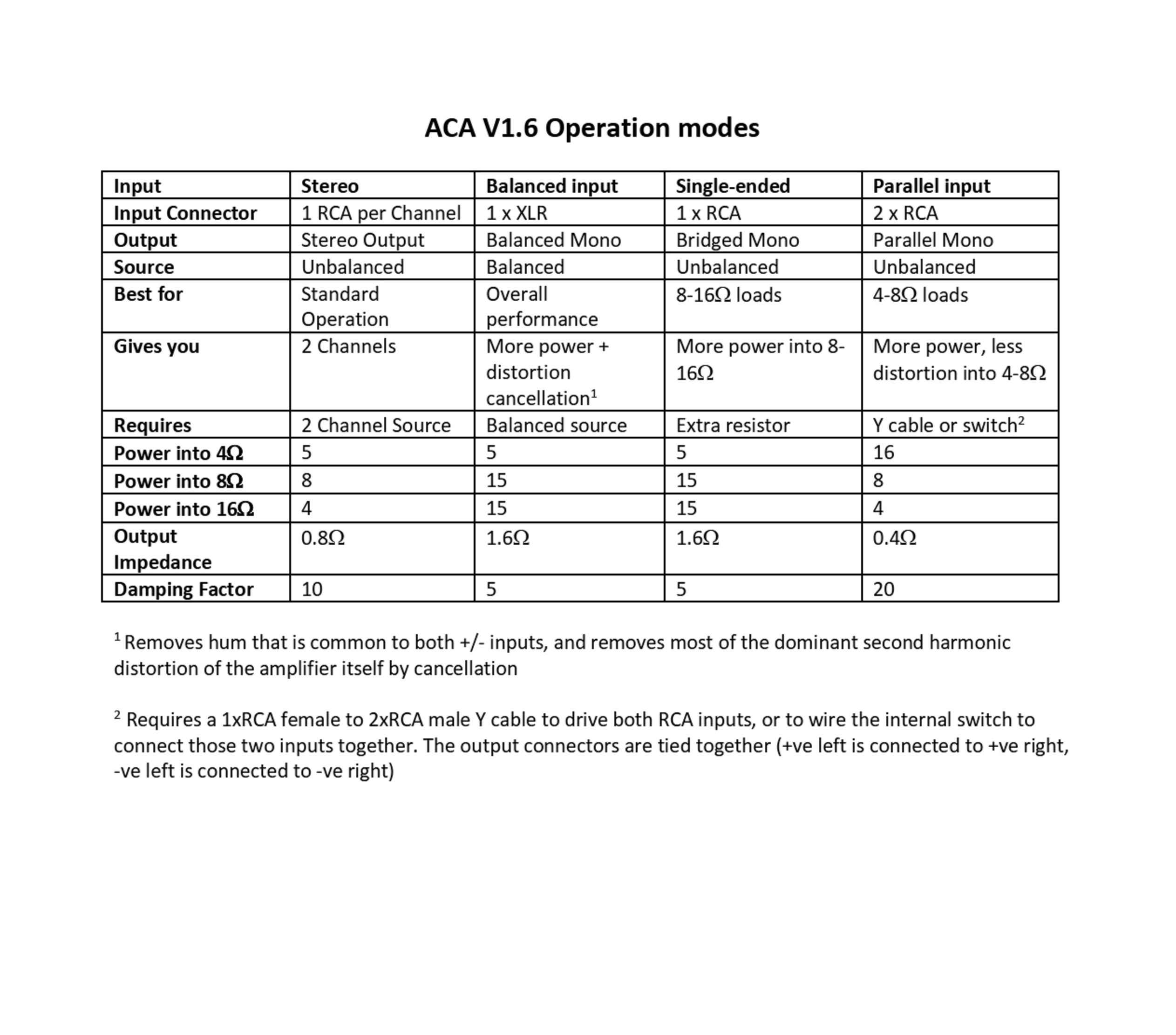

Very simplistically there are four options for the ACA.
First is the standard build, a stereo amplifier with left and right channels in one box. It puts out about 8 Watts per side into 8 ohm speakers. Less into 4 or 16 ohm speakers.
Second is 'Bridged Mono - balanced'. You Have to Have a pre amp or source that has a balanced output to use this mode. (That uses the XLR connector.) The effect is to basically 'bridge' the two channels together so it can have one side handle the positive half of the signal and the other the negative half. This way for the same supply voltage you get twice the available voltage 'swing'.
So for speakers that need more voltage to drive them (8 to 16 ohms) you get nearly twice the power 14 or 15 Watts.
Third is 'Bridged Mono - unbalanced'. This does not need the balanced input as it takes the output of one channel and feeds it to the input of the other channel via a resistor. You get the same doubling of power as the second option (15 Watts into 8 - 16 ohms), but can use a standard pre-amp.
Fourth is 'Parallel Mono'. This has both channels working together with both inputs connected together and both outputs connected together. As both halves are amplifying the same signal there is no voltage benefit, but you effectively double the output current. This is very useful if you have low impedance speakers of 4 ohms that are current and not voltage hungry. Again 14 or 15 Watts.
So there isn't a single simple answer... it depends on your source, RCA unbalanced or XLR balanced and the impedance of your speakers and how much power you want / need in order to make a choice.
As ThermalA says the build guide pretty well covers it, the table is enclosed.
Hope it helps a bit more than confuses, Alan

They are all mono, so the question is: can a stereo sound be heard from any of these?
ThermalAlchemy: I believe that the photos explain what words have failed to do.
I thank everyone for trying to help with the explanation, just one last question, because the wording has left me puzzled, and still hasn't made it any clearer, what of those three "mono" versions are in shown in step 54? Single ended?
Perhaps what is missing in your puzzle is knowing that, other than for option 1, you need TWO amps! Identically wired, one receives the left channel, the other the right and with that you get stereo. You have one speaker connected to one amp, the other to the second one. So you have two mono blocks. None of the configurations 2 through 4 can be run in stereo with a single amp.
Maybe that helps clarify thins?
