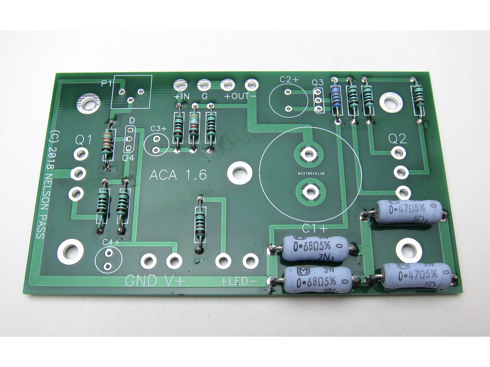

Hi all, posted in the build guide thread, but this looks way more active. Running into some weird issues with my 4th build of the 1.6.
Running into some strange voltage readings. These readings are consistent across both pcbs. This would mark the 4th ACA I have built with the exact same resistors and capacitors and the same rear panel layout ( 2 sets of monoblocks). Since getting these readings all solder joints have been reflowed, all resistors and capacitors replaced and new pcbs. The only thing consistent and not replaced are the LS JFETs.
Anyway, the readings on Q1 are pin 1: 0v, pin 2: 173mv, pin 3: 24v. I am also getting low readings or 24v readings across many other resistors. Everything measured to spec prior to stuffing. Any thoughts? Attached are some pics.

OK, please report back on the voltages, but the first thing I notice is there is very little solder 'flow through' on the component side of the board. Normally on 'good joints' capillary action brings a small amount of solder round the component leads - see the example from the build guide.
If you are brave, do the tap and poke test with power on speakers connected and with a low level input. If you find a component that reacts you might be able to re solder it from the top of the board. In the end though, I think you will need to remove the board and re-flow all the solder joints...

I added them above. Thanks for the help, like I said, Odd voltages.There are several possibilities for the 24v you are seeing.
First thing to do would be to record all the voltages on all the transistors. Copy and past this with the results and lets see if anything stands out.
Q1
D=172.3 MV
G= 23.1 V
S= 26.8 MV
Q2
D= 23.75 V
G= 5.64 V
S= 1.098 V
Q3
C= 5.61 V
B= .809 V
E= 198.1 MV
Q4
D= 23.76 V
G= 23.1 V

Thanks so much for the observation. The flow through makes sense. Can i just add solder to all of them from the top?
I assume the tap and poke test is to use something non-conductive to nudge each component while listening for changes in the audio output from the amp? it seems like at low levels that could work, i can give it a try.
I started with the Resistance checks but was having trouble getting the readings even after waiting several minutes for the caps to charge as instructed. I will try again tomorrow and post my results.

You could for the resistors, though it is not easy for the transistors and impossible for the capacitors.The flow through makes sense. Can i just add solder to all of them from the top?
Correct.I assume the tap and poke test is to use something non-conductive to nudge each component while listening for changes in the audio output from the amp? it seems like at low levels that could work, i can give it a try.
That is a fair indication a cap or associated component is not connected...I started with the Resistance checks but was having trouble getting the readings even after waiting several minutes for the caps to charge as instructed. I will try again tomorrow and post my results.
On a second look at your pictures, I would take it out and re-do all the joints...
Very odd. At face value it looks like Q4 is duff or not what its supposed to be. Q3 is working fine and limiting the current correctly. Its almost as if Q4 is near short or its not a FET but an NPN transistor with the base where the drain should be. That would give near identical voltage readings to what you are getting.
Yep, that was my thought too. I have two replacements on the way which I assume will fix the issue. Thanks for the help!
