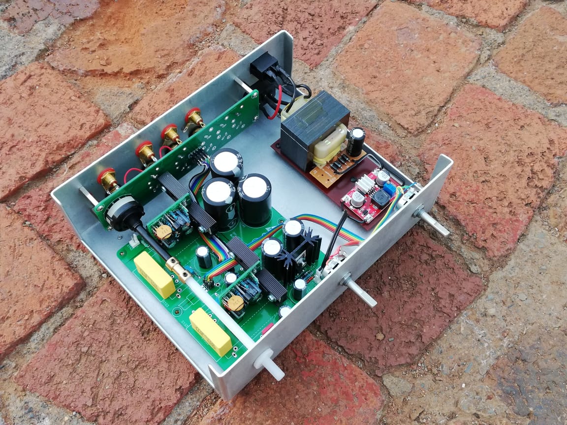

I've stopped keeping track of costs on my projects. It depresses me.
There are no expensive components in that build. The transformer was salvaged from an old Wi-Fi hotspot PSU and the case I've had for years. The most expensive item must have been the PCB's - and it's only $35.

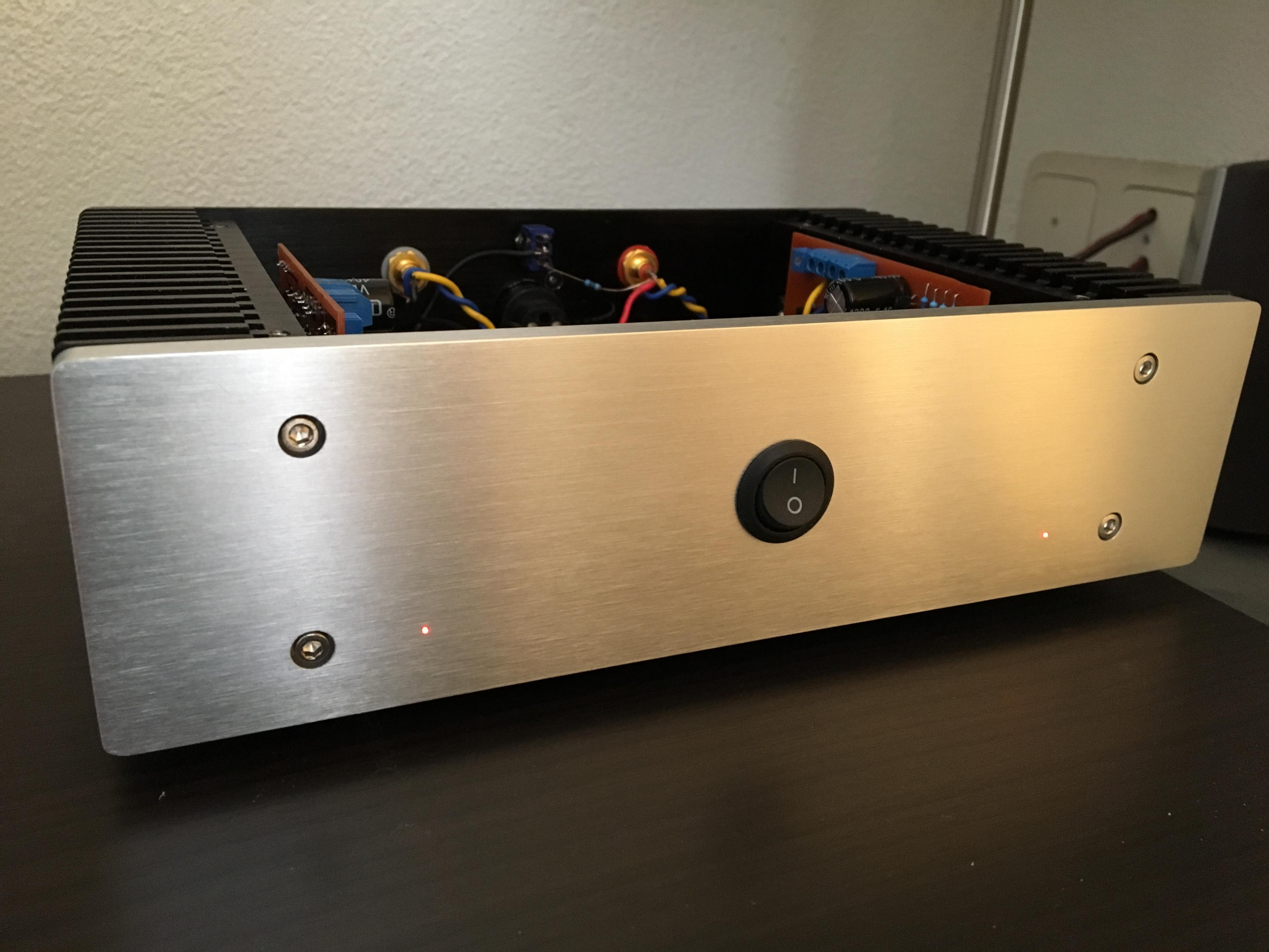

Finally!
My amp camp amp (homebrew) is playing beautifully, love the sound!
As pointed out by Alan, the semiconductors proved to be cheap chinese counterfeit components, when replaced with parts from trustworthy suppliers all worked like a charm!

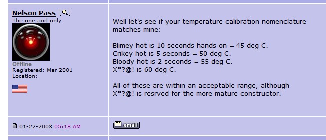

One question though, how hot may the case get?🤔🤔
Neel
Neel
Finally!
One question though, how hot may the case get?����
Cheers, Neel
Really pleased you have it working, very well done!
First, they do run hot normally. Can you touch it for a couple of seconds? (Papa Pass scale.)
The other thing I notice is that your chassis is a little bit smaller than the 'kit' chassis. So I guess it will run a bit hotter still.
Alan
PS. 54c is no problem
The outside of my heat sinks are 136F when the ambient temp is 79F.
It is more than the transistors and the heatsinks. The temperature inside the box matters. For example if you check the electrrolytic capacitors' datasheets you will see graphs showing degradation of performance with increasing heat. Some resistors start degrading at 25 C, many do not start degrading until the temperature reaches 70 C. You have to be careful when you purchase parts for a hot environment.
If the heatsinks are reaching 58C, you must have ventilation holes top and bottom to let heat out of the chassis interior. Also I'd suggest feet 25mm tall or taller to ensure you have adequate space under the heatsinks for good airflow. It makes a surprising difference.
