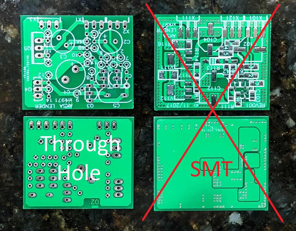

I looked over the AKSA thread timmyjones, and unless you are capable of doing surface mounting with no problems (or you can get the boards with pre installed surface mount components), this one is not for you. If you feel comfortable with through the hole soldering but not with SMT you should look elsewhere.

That is simply not true. The standard PCB pack comes with through hole boards AND a set of extra SMT daughter cards, but that's optional. You don't have to use it. It's very handy if you want to build an extra pair of input daughter cards with more gain. I think 30dB+ is possible.

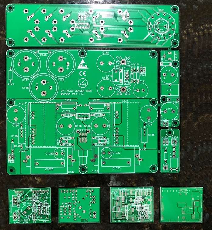

If you take some time to actually read a bit in the AKSA Lender preamp thread, you'll see that all the boards are through hole. There is also an extra set of SMT daughter cards, which are optional.
A fully operational preamp can be built using only the main board and two daughter cards - all through hole, if SMT is too daunting for you.
That is absolutely great news, but I am looking at the AKSA thread and see SMTs all over the place. Back to through the whole, what is the gain without the daughter cards? Pray tell.
Zero gain and zero sound without the daughter cards. They are needed for the preamp to operate. A nice feature of the design is that the daughter cards can be built with a specific gain. Build two or more sets and just plug in different daughter cards to change the gain.

Sure thing Skylar, the through the whole board cannot work by itself. If you cannot do surface mounts you will have to either breadboard your own daughter cards or do your own through the hole PCBs in order to get the thing to work, correct? Does this sound simple to you? I mean for someone that wants to keep it simple?
The changeability of the daughter cards is indeed a great feature, thank you.
Not correct, oc11. There are two sets of daughter cards, one set is through hole and the other(optional) set is SMT.
Have a look at the pictures below. Through hole daughter cards are supplied in the PCB set. No need to make your own boards...
The first picture is the two sets of daughter cards. Use the set on the left. It's through hole.
The second picture shows the complete set of boards. The daughter cards are the four little ones at the bottom - two for through hole and two for SMT. I hope it makes sense now.
